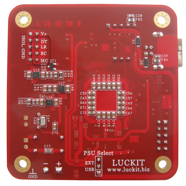

That's nice Zsolt🙂, attached pic with WaveIO Isolated outputs I need advice how to connect to Drive NOS:
WaveIO Drive NOS
DT SD
LR WS
BC SCK
MC MCLK
TIA
Felipe
WaveIO Drive NOS
DT SD
LR WS
BC SCK
MC MCLK
TIA
Felipe
WaveIO Drive NOS
DT SD
LR WS
BC SCK
MC MCLK
TIA
Felipe

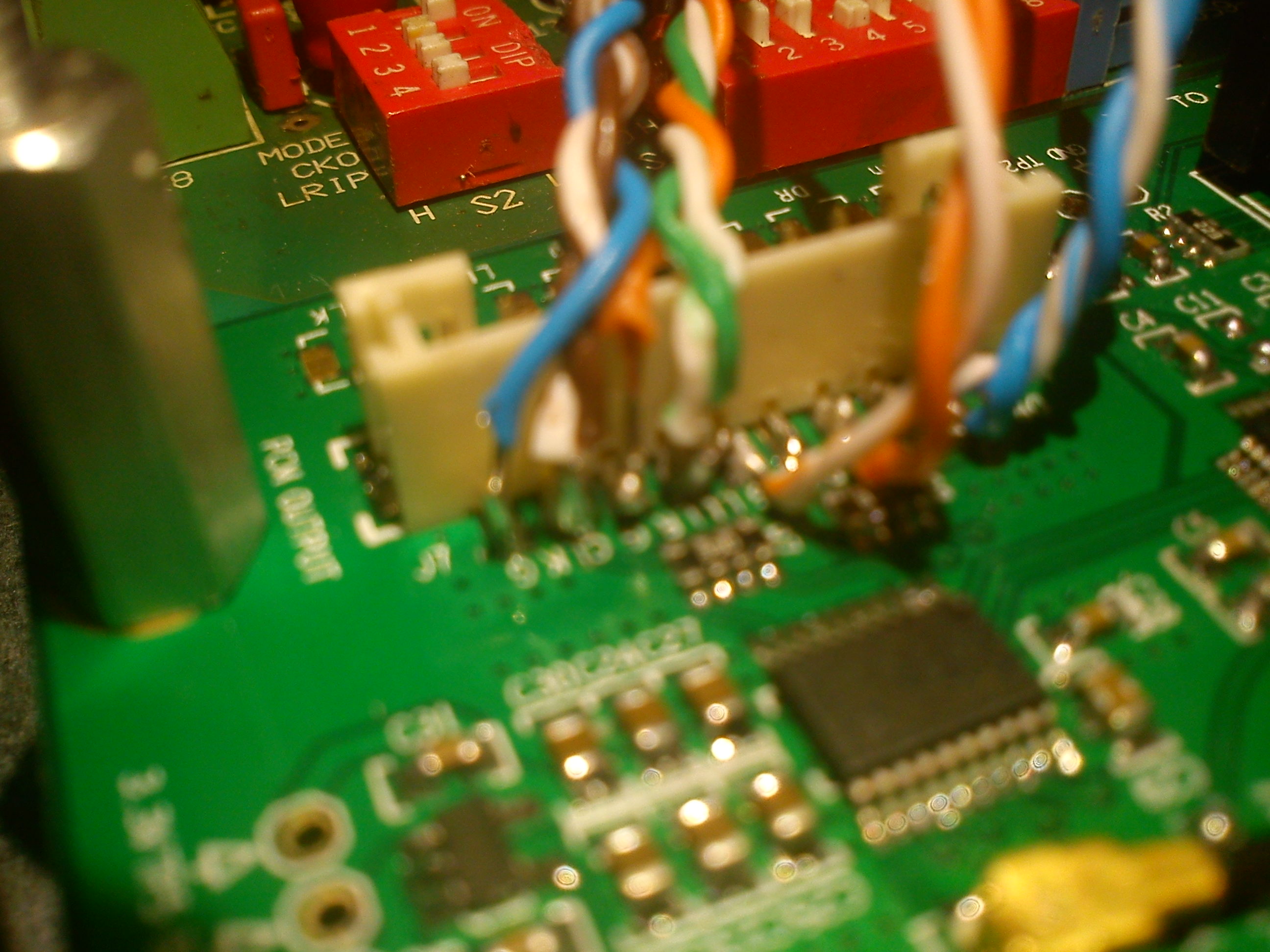

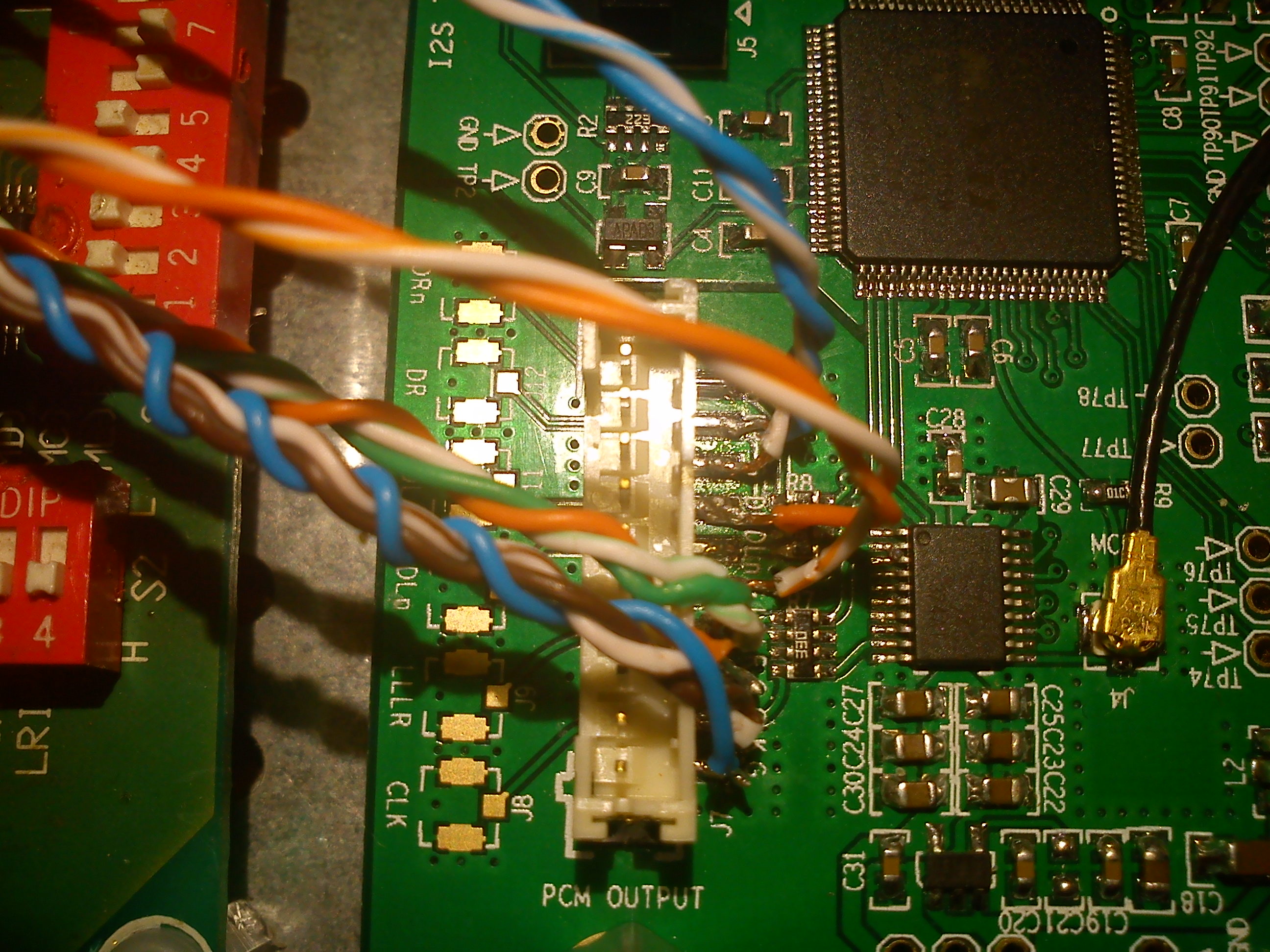

Still did'nt see how to connect it?

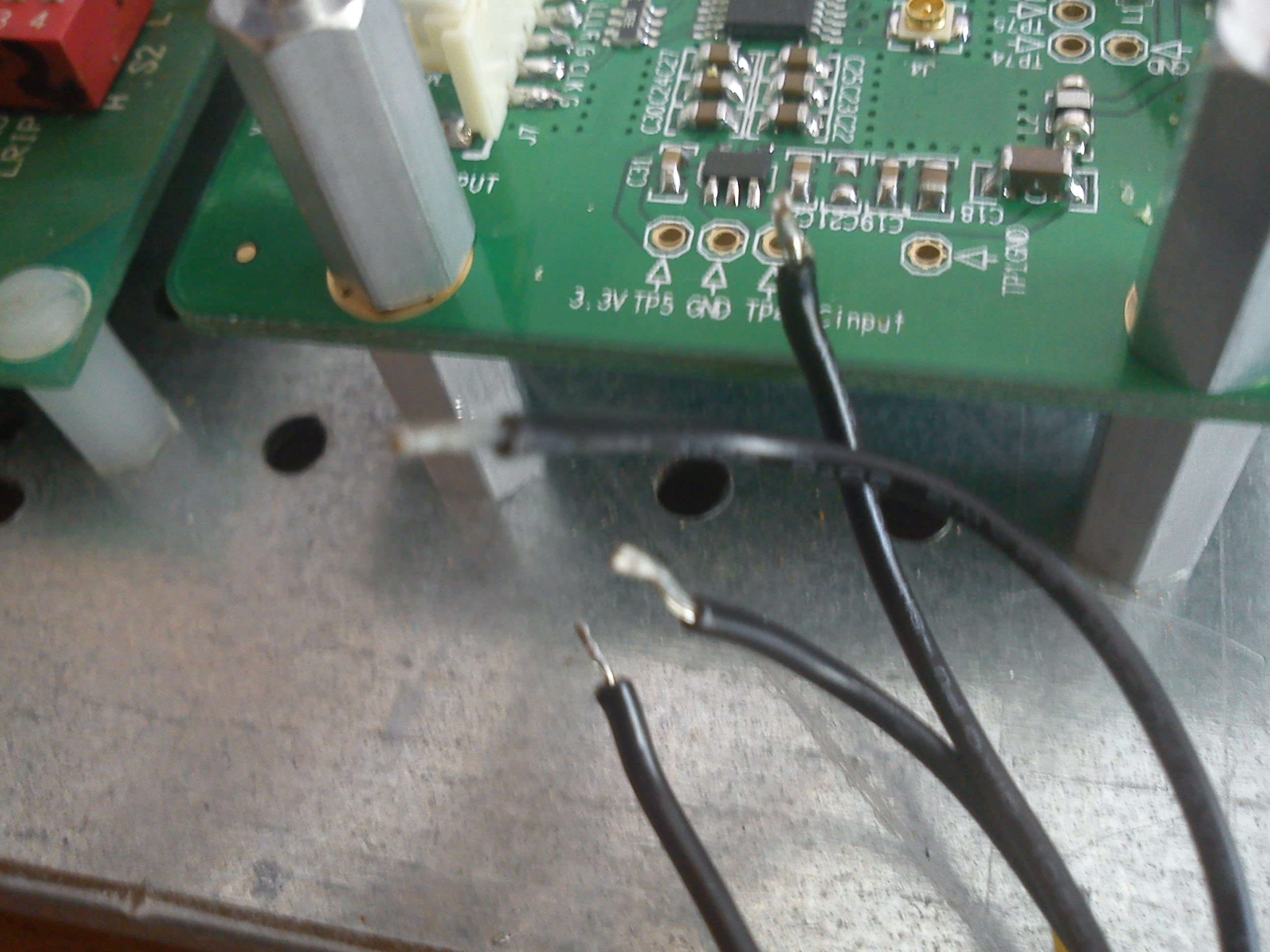

Use a female pin-header (or solder directly) the 7pin PH2.0 connector's cables to connect to the corresponding pins on WaveIO header.
You mapped the pins correctly:
WaveIO PCMconverter
DT SD
LR WS
BC SCK
MC MCLK - to connect MCLK to WaveIO pin header you probably have to skin/cut one end of the the u-fl cable
PCMconverter PH2.0 input has 4 grounds - connect all of them to the WaveIO pin header.
For the output:
Use your existing soldered cables and twist ground cables around each line (CLK, LLLR, DR, DN) and solder them to PCM1704's PCB ground plane - e.g. to the ground pad of those unused electrolytic caps (C39...)
p.s.: post pics when you are done

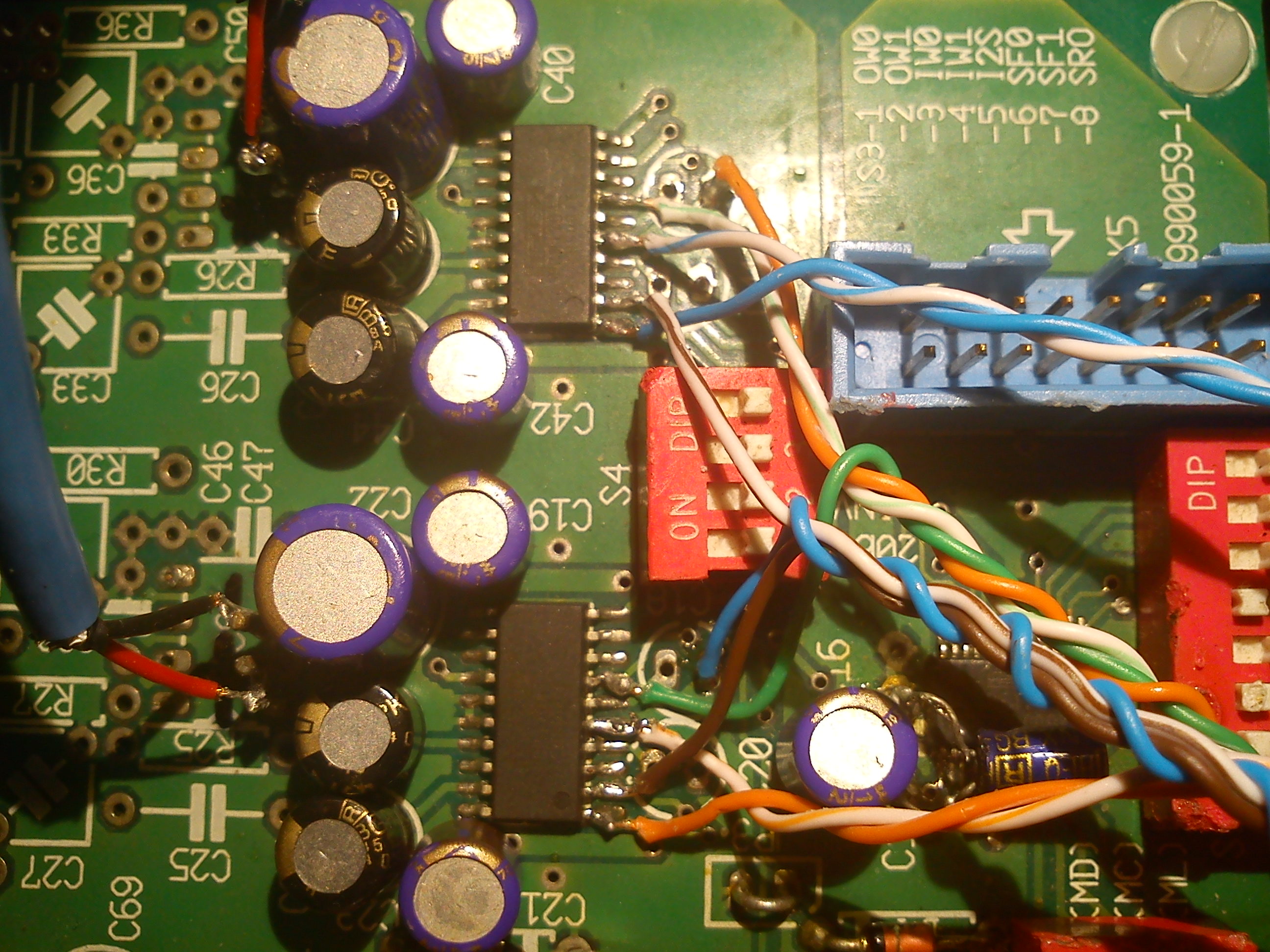

For the output:

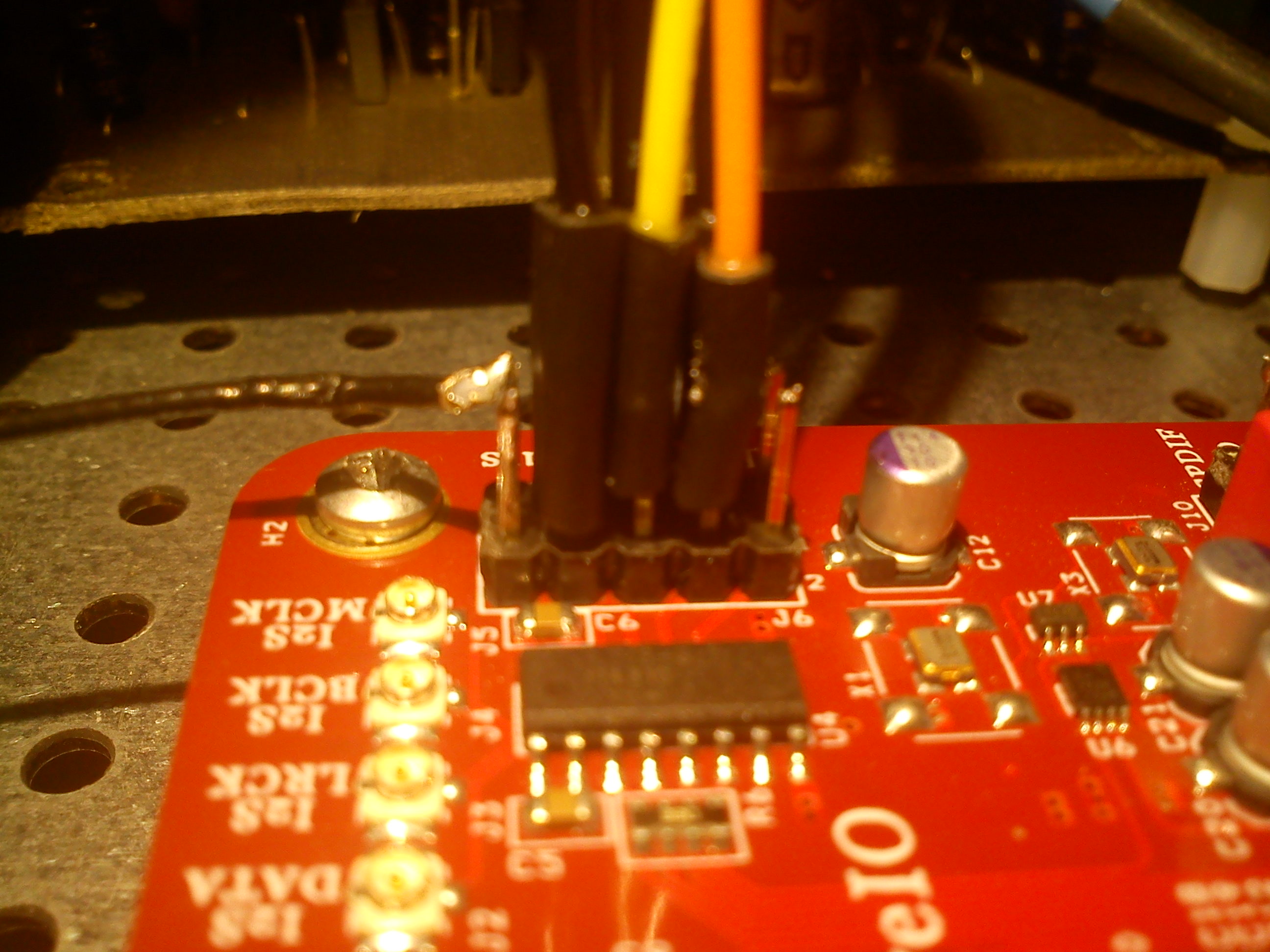

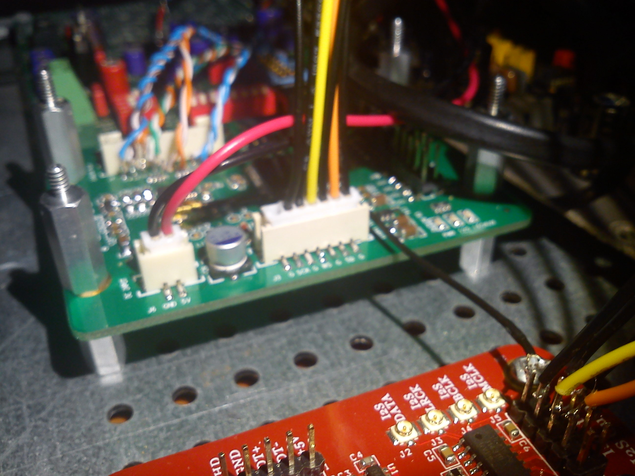

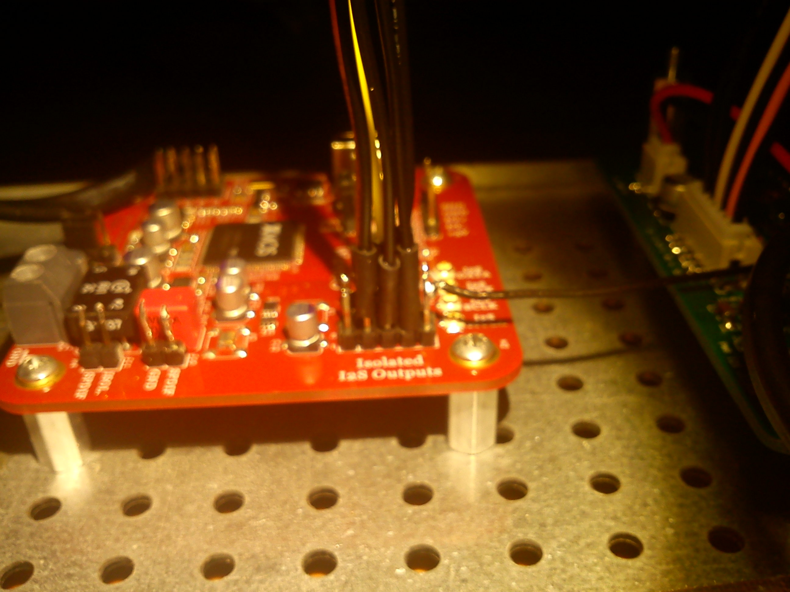

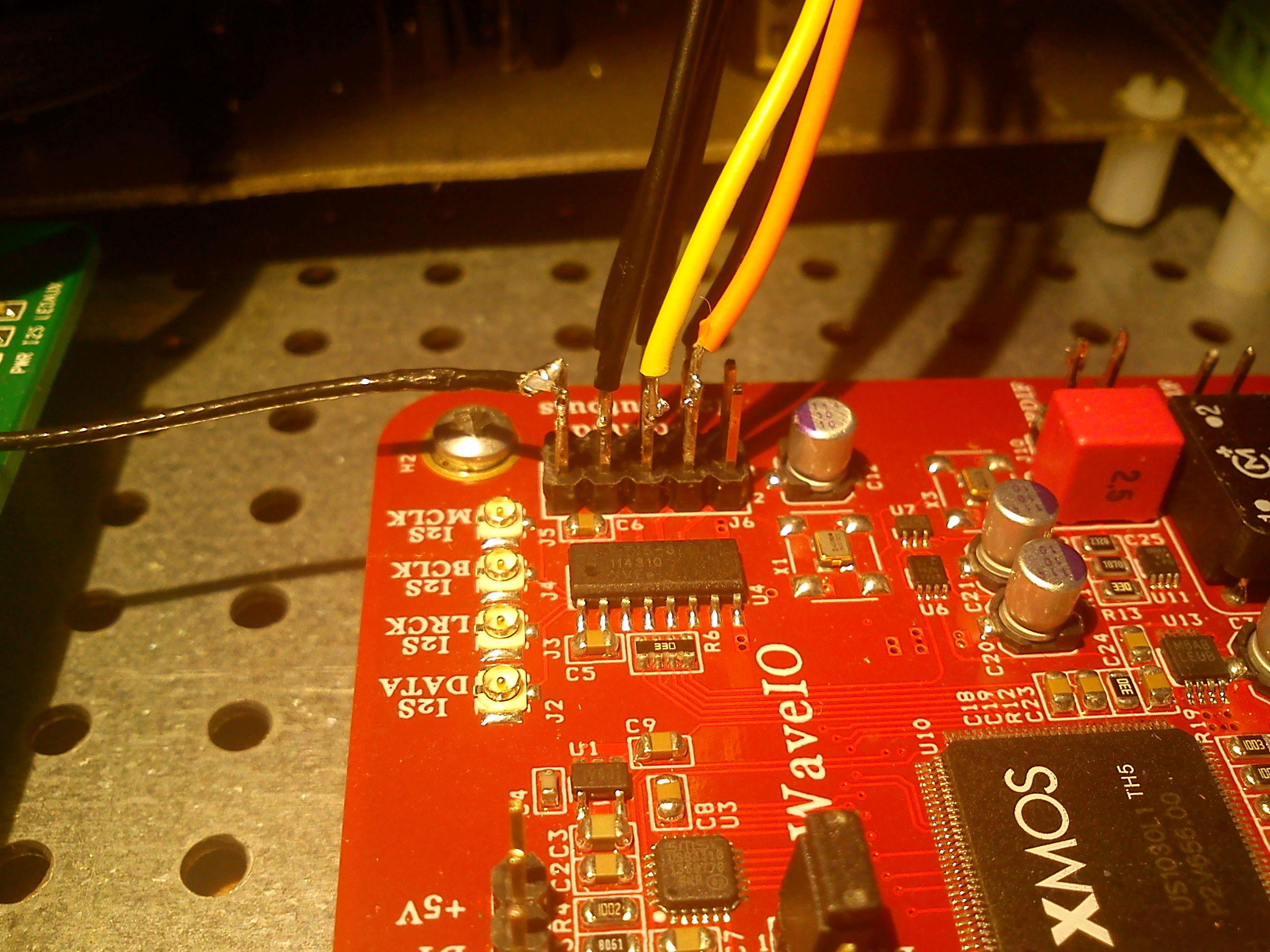

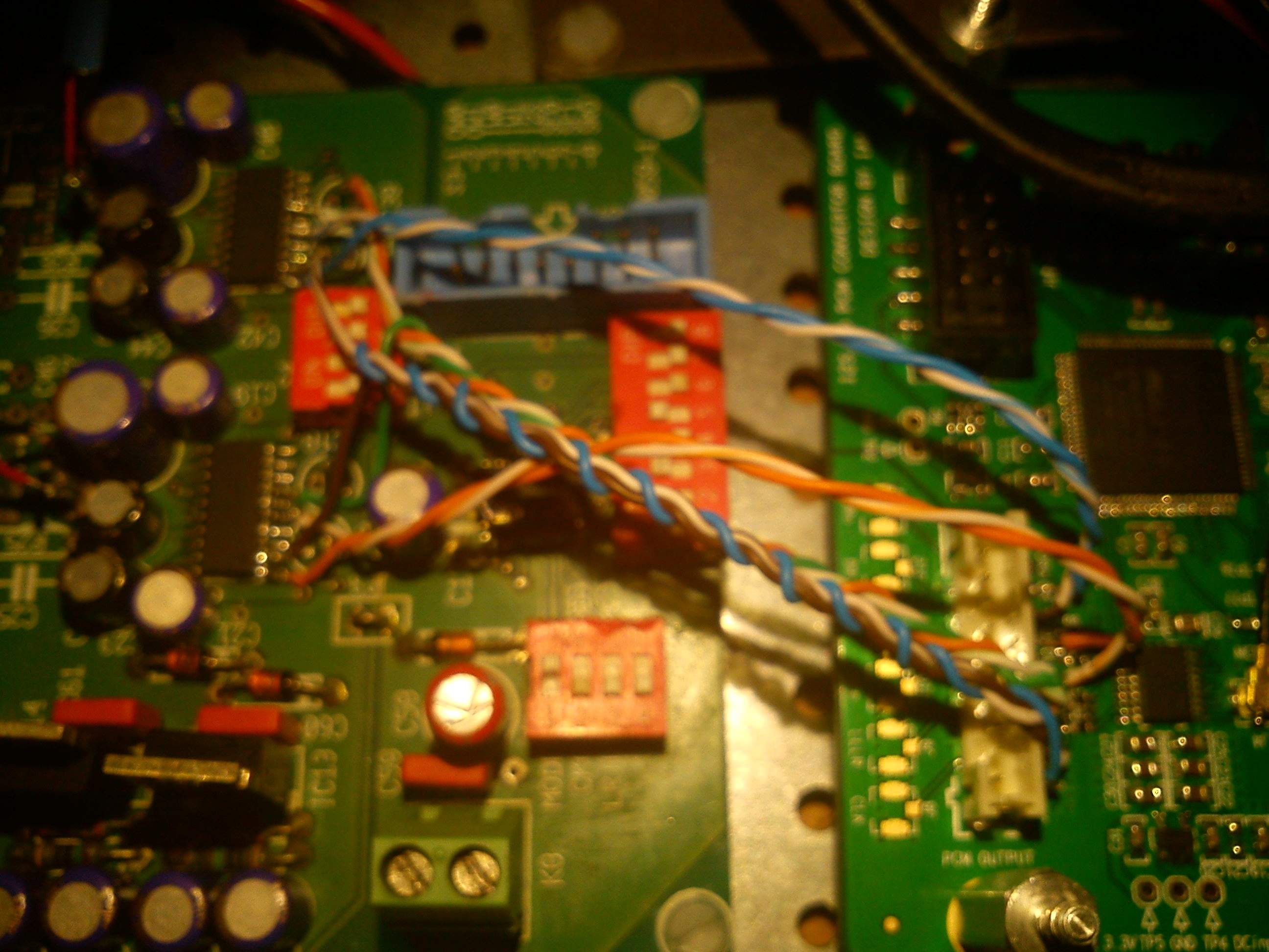

Attached pics prior to power the DAC.
The cabling looks a bit better now.
1. Your WaveIO cabling seems incorrect according to this bottom image of WaveIO link . It seems you reversed all cables - e.g. MCLK should be on the other end
2. Please read/ask about WaveIO but I suppose at V+ pin you have to input some voltage for that part of the isolator - check this
- Measured and re-check that everything is connected and are no shorts among any cables/traces
- After everything lits up (you said you have a scope) - without connecting the converter board measure that you have the correct frequencies for WS, SCK and MCLK: e.g. 44.1Khz, 2.8224MHz, 22.5782Mhz or 176.4Khz, 11.2896Mhz, 22.5782Mhz
Awesome!
Oooops my fault, as you said I reversed all cables, thank you Zsolt.
