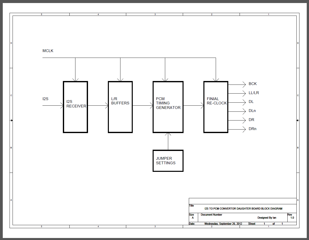

Block diagram for TDA1541A
Hi Ian,
could you post the options we have for the TDA1541A (NOS/OS) in your block diagram?
304493d1349215006-drive-nos-ad1865-62-pcm1704-02-63-tda1541-fifo-universal-i2s-pcm-driver-board-blockdiagram.png
Thanks in advance.
Oliver

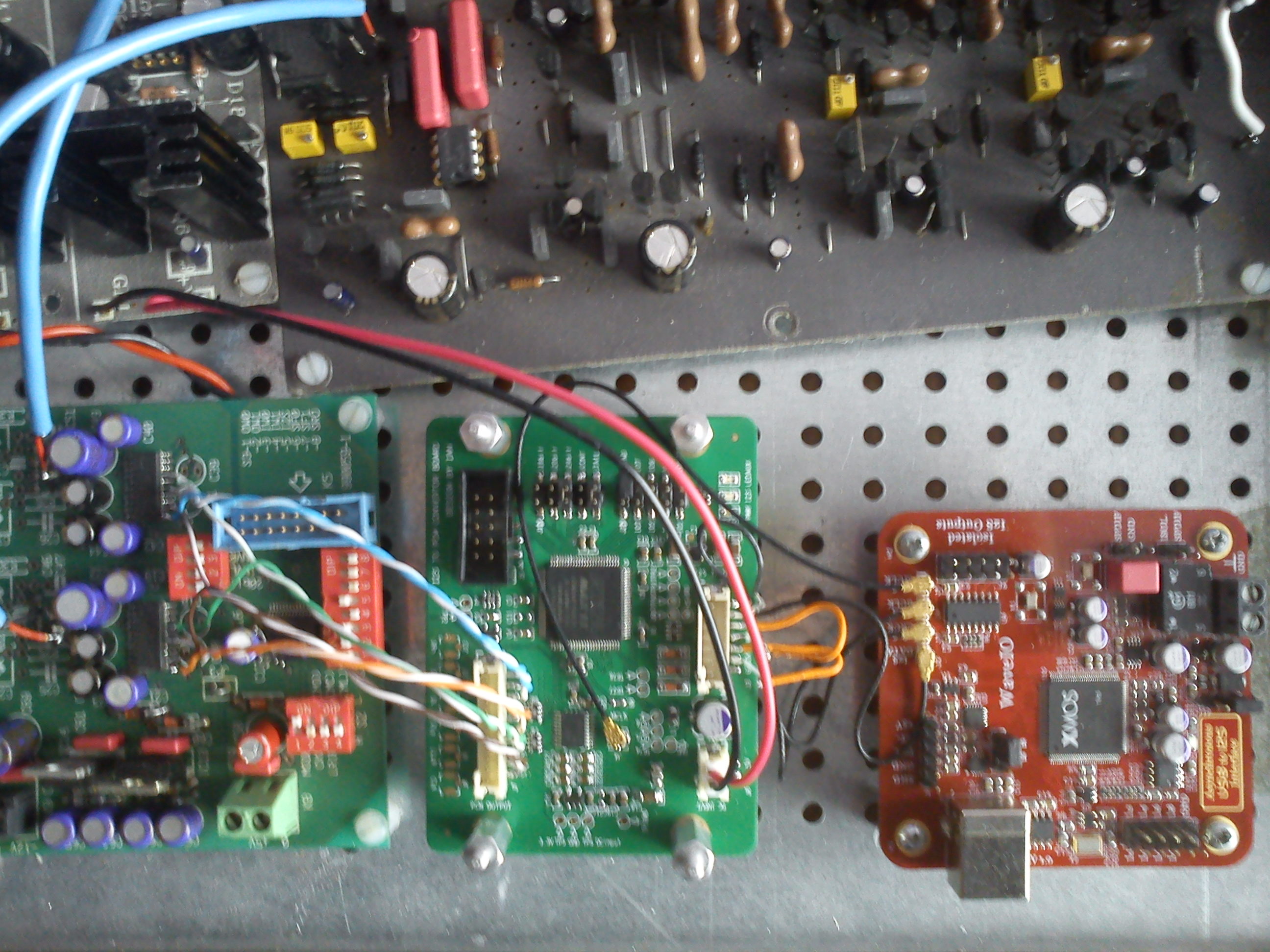

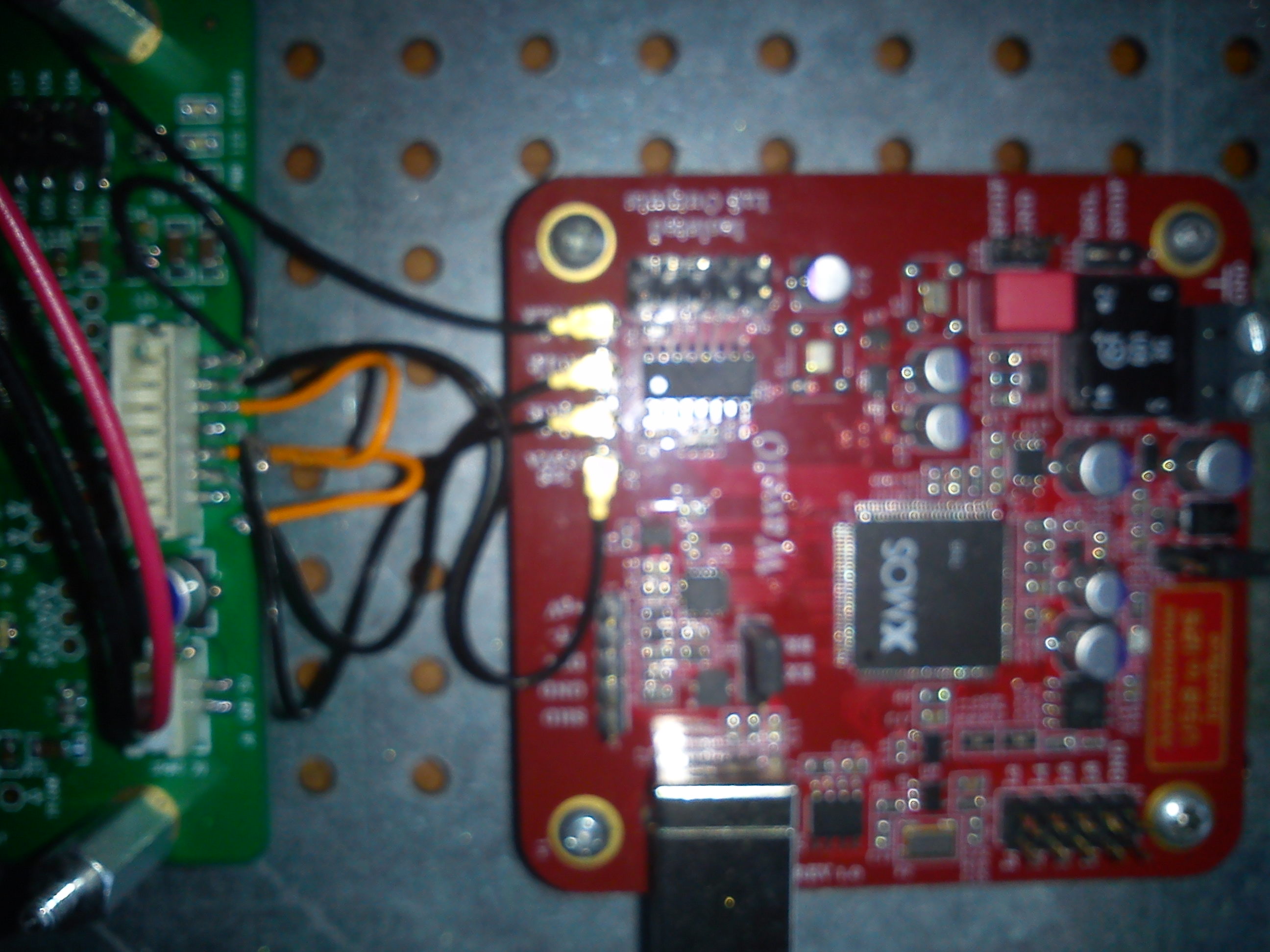

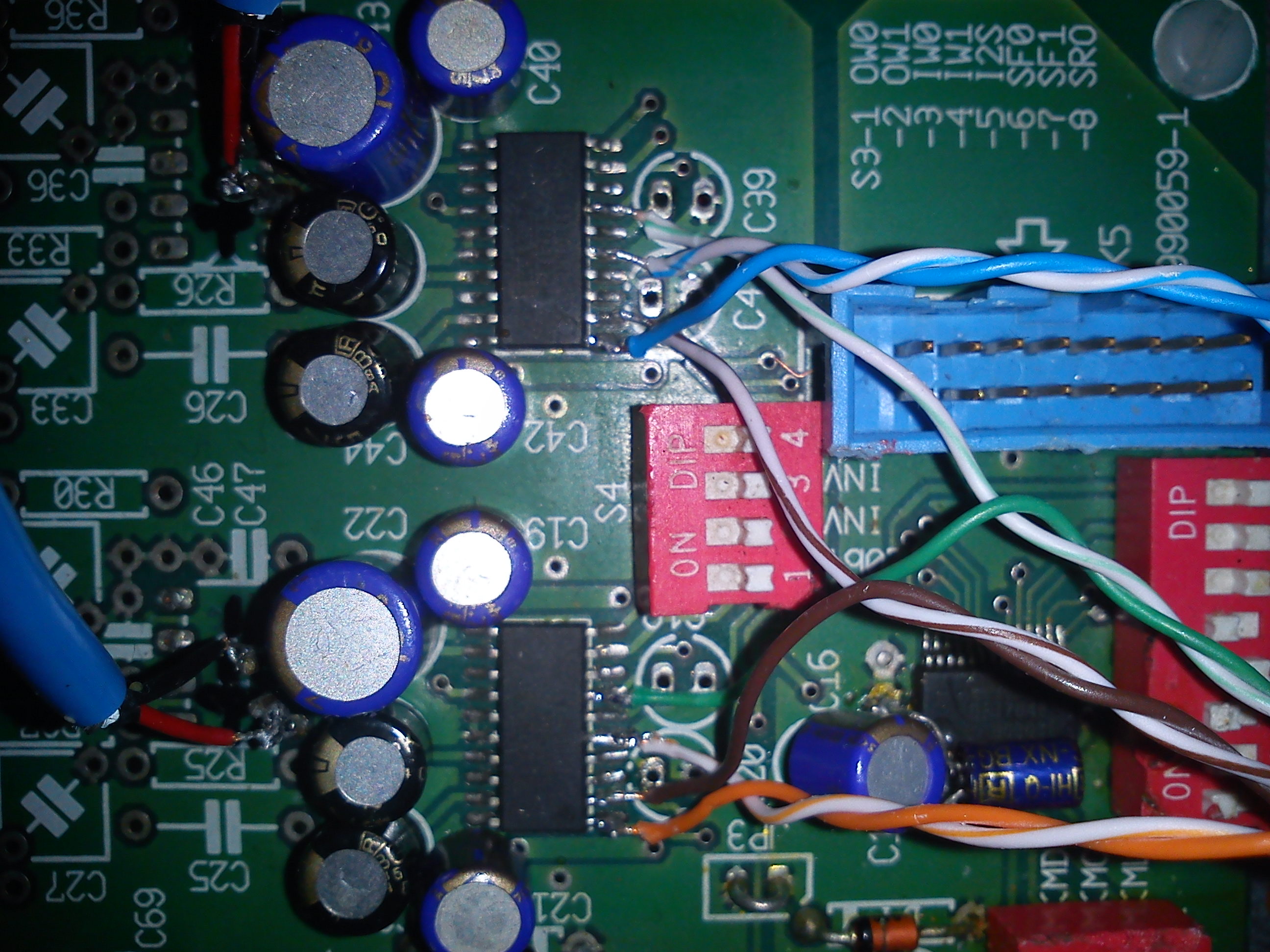

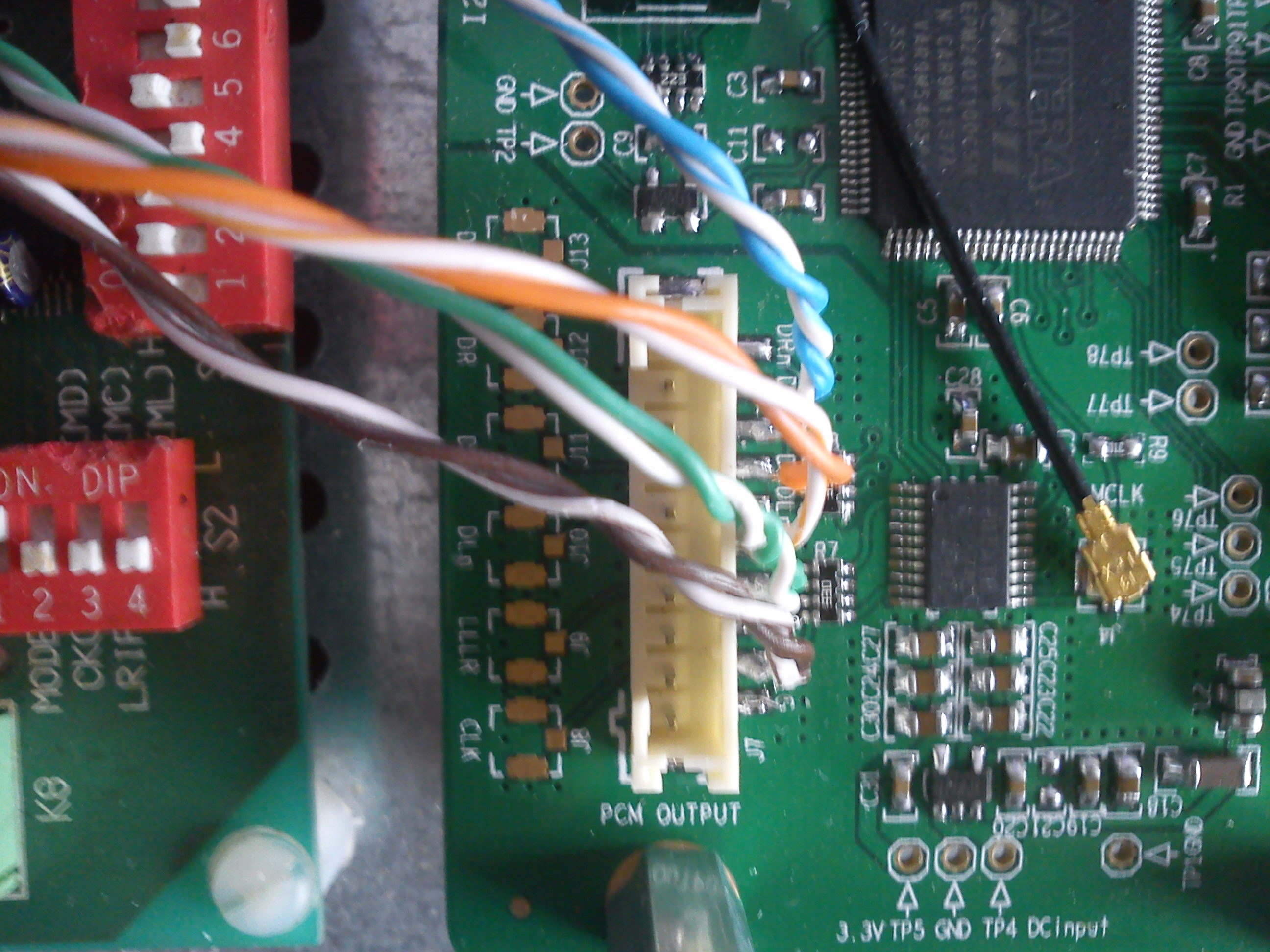

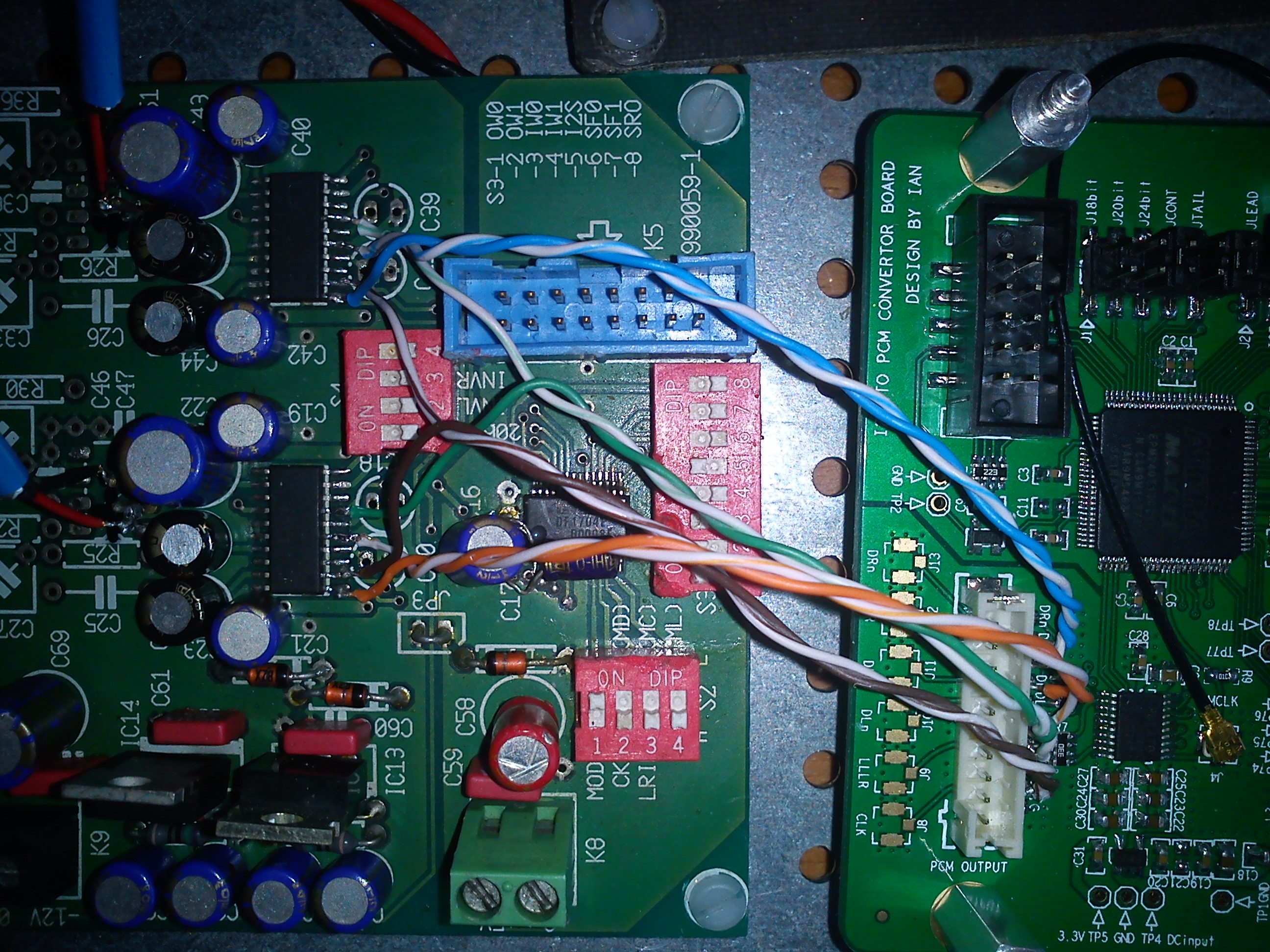

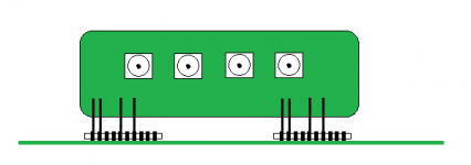

Joseph K x 2
I'm having trouble playing higher than 96K files with my system:
PC->WaveIO->Ian's I2S to PCM converter->PCM1704 DAC.
I have soldered Ian's board output directly to the input pins of the 1704.
When I play 176.4K or 192K I get basically noise with just a little music in the background. 96K and lower play fine.
Any ideas of what might be the problem?
Ian suggested the clocks on the Wave (22.xxx/24.xxx) may be a little on the slow side for the higher sampling rates, can anyone confirm this?
Hi merlin el mago,
I'm gonna test it again at same case by a logic analyzer. A picture of your setup and system would be help.
Ian
IMO you have some serious signal integrity issues - it's a miracle it works at all.
The re-clock FF on the I2S to PCM board is fast (maybe too fast?) - Potato logic - it has very fast rise times and this seems to require great care. I would even use the PH2.0 output only for testing and change to u-fl for the final setup.
As a last try - before making a small adapter board - I would try to run ground wires twisted near all lines not only the data line.
If you seriously want to use this PCM1704 evaluation board I would make a small adapter in your place - something similar to the attached sketch (excuse my Paint skills)
edit: same issue between WaveIO-I2S-to-PCM (good question how to connect them correctly) maybe remove the 7pin PH2.0 from the converter input and try solder u-fl connectors
