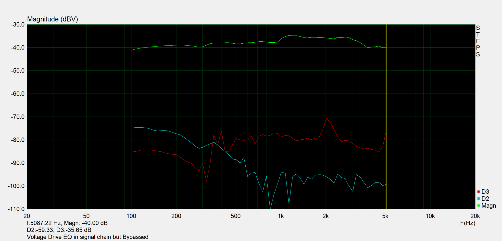

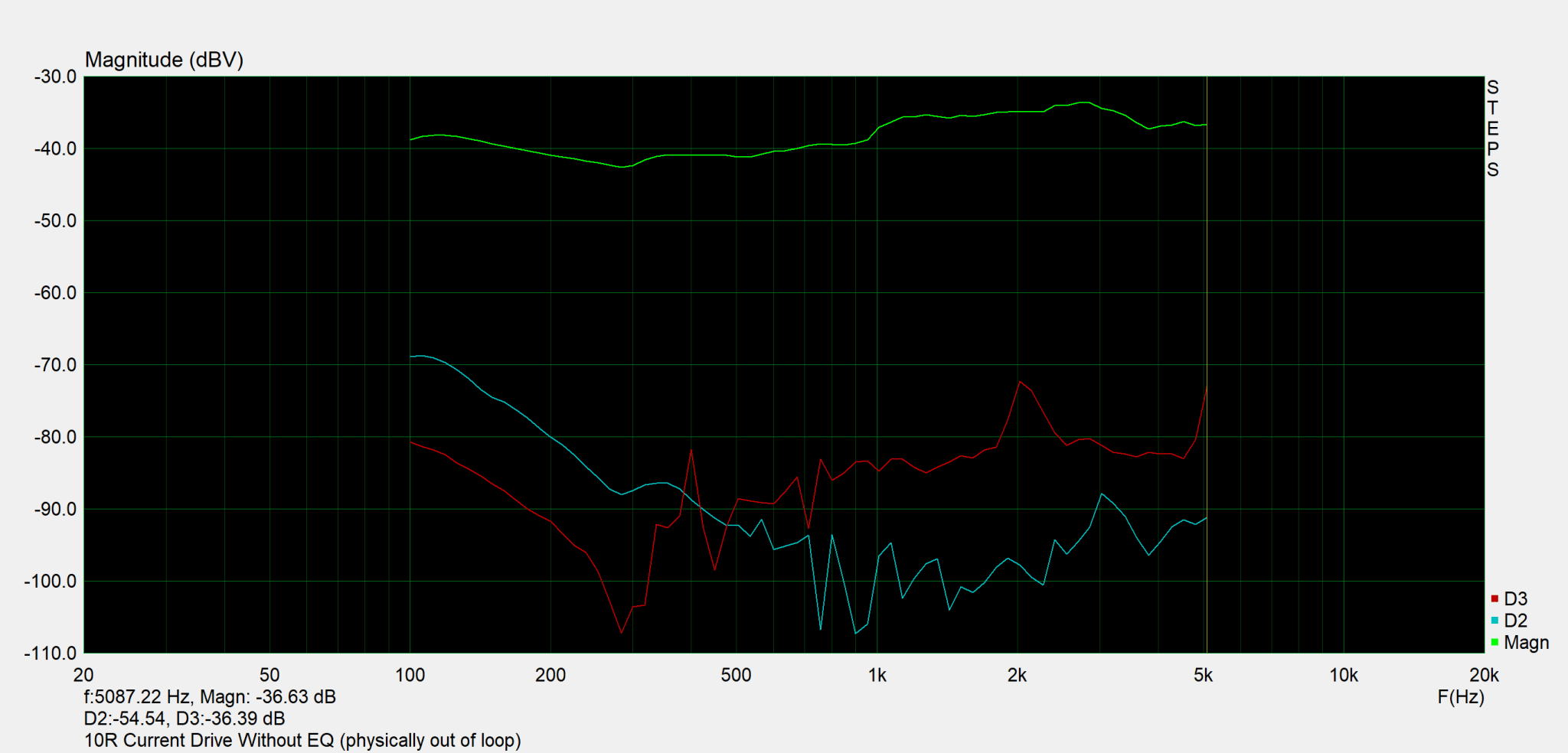

This time I closed the port of the loudspeaker box. The mid-range distortion result is a lot cleaner to analyse. I also switched to a ground-refenced amplifier.It does not help to produce graphs that are labeled D (distortion). If i am right you are using ARTA sine sweep farina method. This does not work. Do not ask me how i know.
01) Use STEPS (ARTA)
02) Bypass (omit) your equalizer
03) Set the STEPS - range to eg. 1000Hz-2000Hz (to save time)
04) Set the Steps to 1/6 oct (to save time)
05) Level match both measurements crudely with the output volume control of the interface/amplifier/software output mixer.
06) Use moderate Volume.
07) Publish the two fundamentals
08) Publish D3 and D3o in %
The distortion reduction by resistor is a given fact!
20R @4R nominal transducer is a guarantee for a significant difference. My measurements above are 20R @8R nominal transducer. To scale my measurements you could even use one 10R.
oh, and
09) ignore impolite useless members ;-)

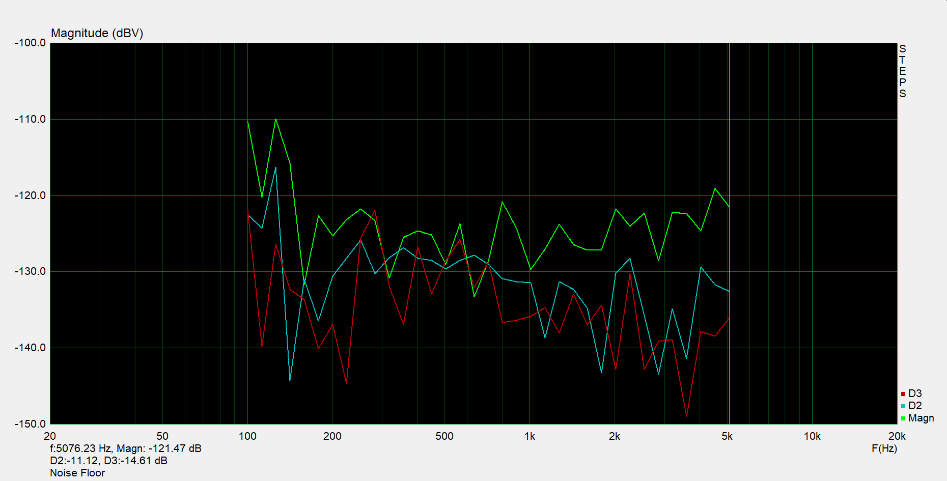

Below: System noise floor.
Below: Voltage Drive EQ unit physically out of the signal chain.
Below: Voltage drive with EQ unit in the loop, but bypassed.
Below: Current Drive 10R level matched at 1KHz - 2KHz . EQ physically out of signal chain.

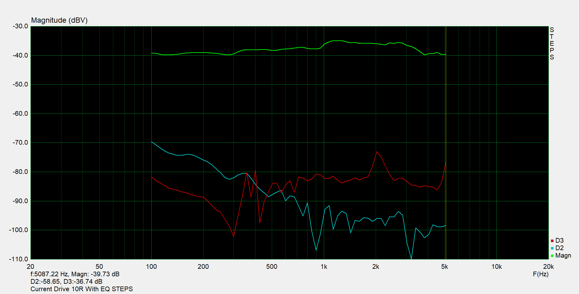

Below: Current Drive 10R with EQ to match the response to voltage drive.

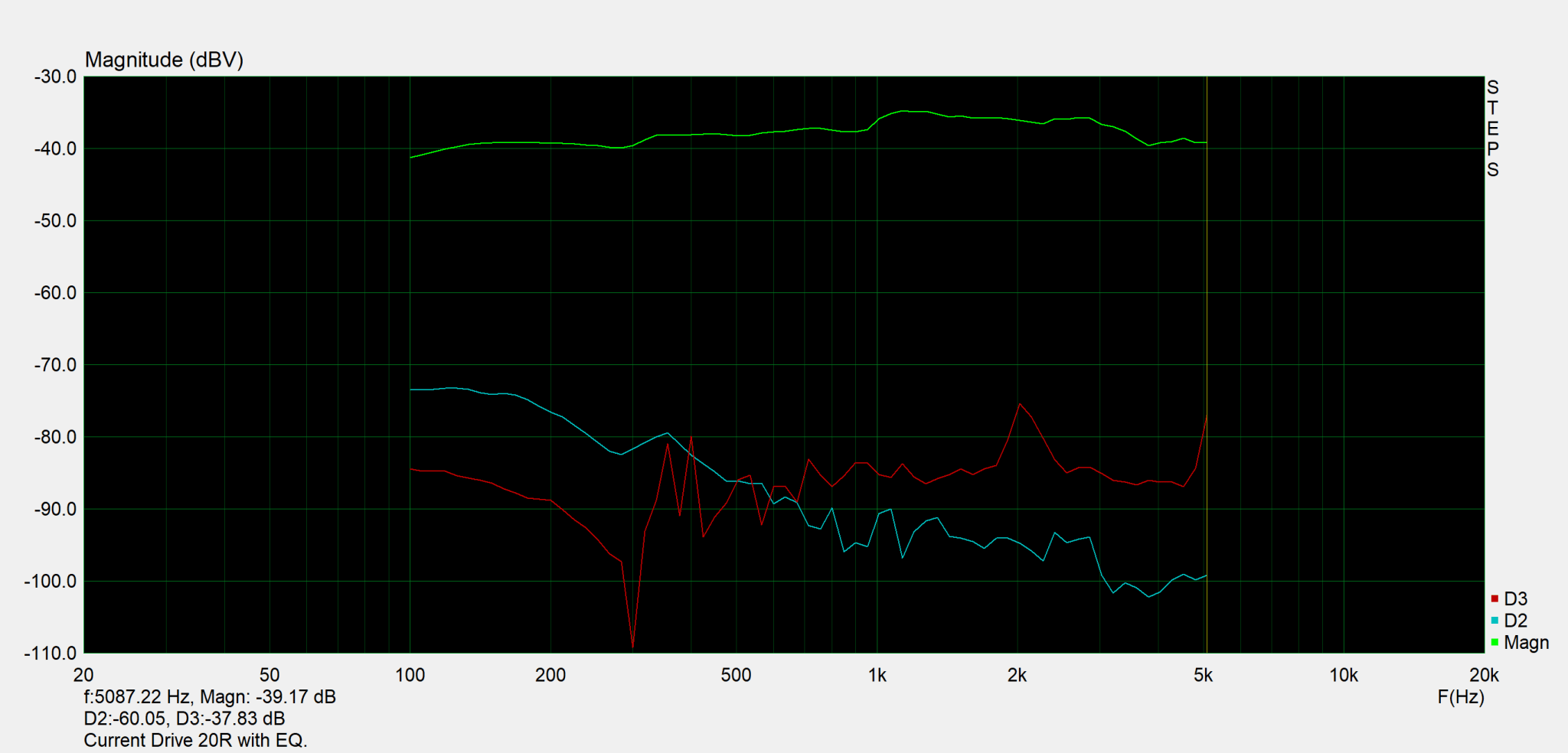

Below: Current Drive 20R with EQ to match response to voltage drive.

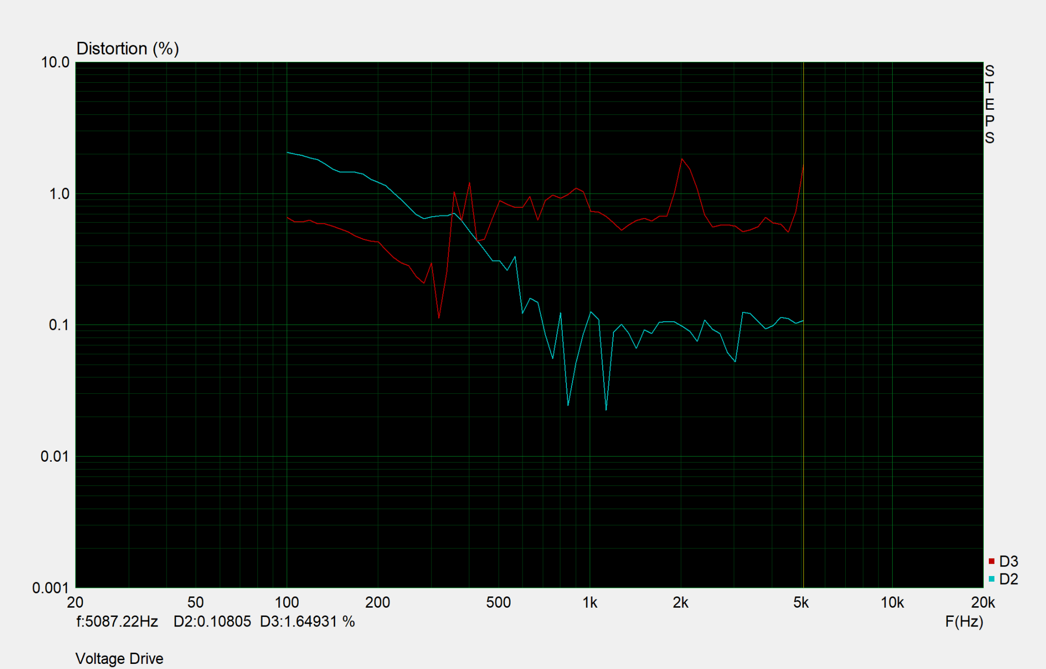

Below: Current Drive 20R with EQ as distortion percentage.
Below: Voltage drive as percentage.
Conclusion: 20R output impedance provides a reduction mostly in 3rd harmonic. The most notable change is around 850Hz where voltage drive gives 1% D3 and 20R current drive gives 0.4%. Nice!
We see the biggest reduction in distortion where the woofer impedance is low. I think this is because the 20R series resistor will dominate current delivery most at that frequency.
