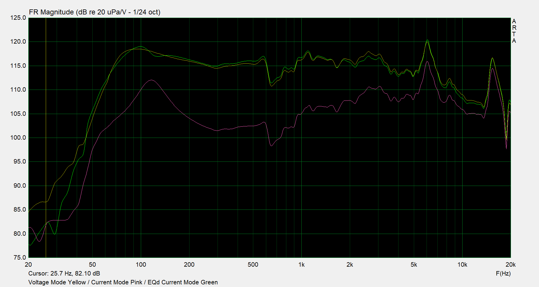

The problem is that this doesn't work well at all with the standard resistor attenuation circuit that 99% of people use for measuring the impedance.
Ideally this needs to be done with a constant voltage source*, or otherwise with a very small reference resistor like mentioned here in this thread.

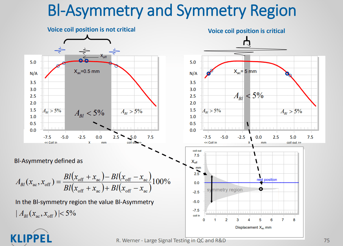

Also pretty much all Klippel content I've consumed past 24 hours indicate Bl has most effect on distortion, whole bandwidth is affected (IMD), and quite a lot.
Here is very nice power point presentation about the stuff, more hands on stuff than the papers and helps get intuition how to read the graphs: https://www.klippel.de/uploads/medi..._Signal_Testing_in_QC_and_R_D_by_R.Werner.pdf
I would think that unless there is way to find out the cone DC offset then practicality of home measurements is limited to comparing drivers to each other. This could be done faster with THD and IMD (multitone) tests done with target SPL, so no need to start plotting BL and Kms?
If DC offset was known, then we could reduce distortion some. But you say it's hard / impossible to measure. Wouldn't measuring asymmetry of current of some symmetric test signal do, no?

To repeat it again, this MUST be done with a constant voltage source or otherwise (second best) with low ref resistor.

But it's also important to know how stable a motor is for low frequency behavior as well as getting a sense of it's max excursion capabilities for example.
Another example I use real Klippel measurements for (from Erin as well VC magazine), is to see how trustworthy things like xmax are.
Some manufactures say they have like 11mm xmax, yet the Cms or BL is already hitting 20% at a much lower value.

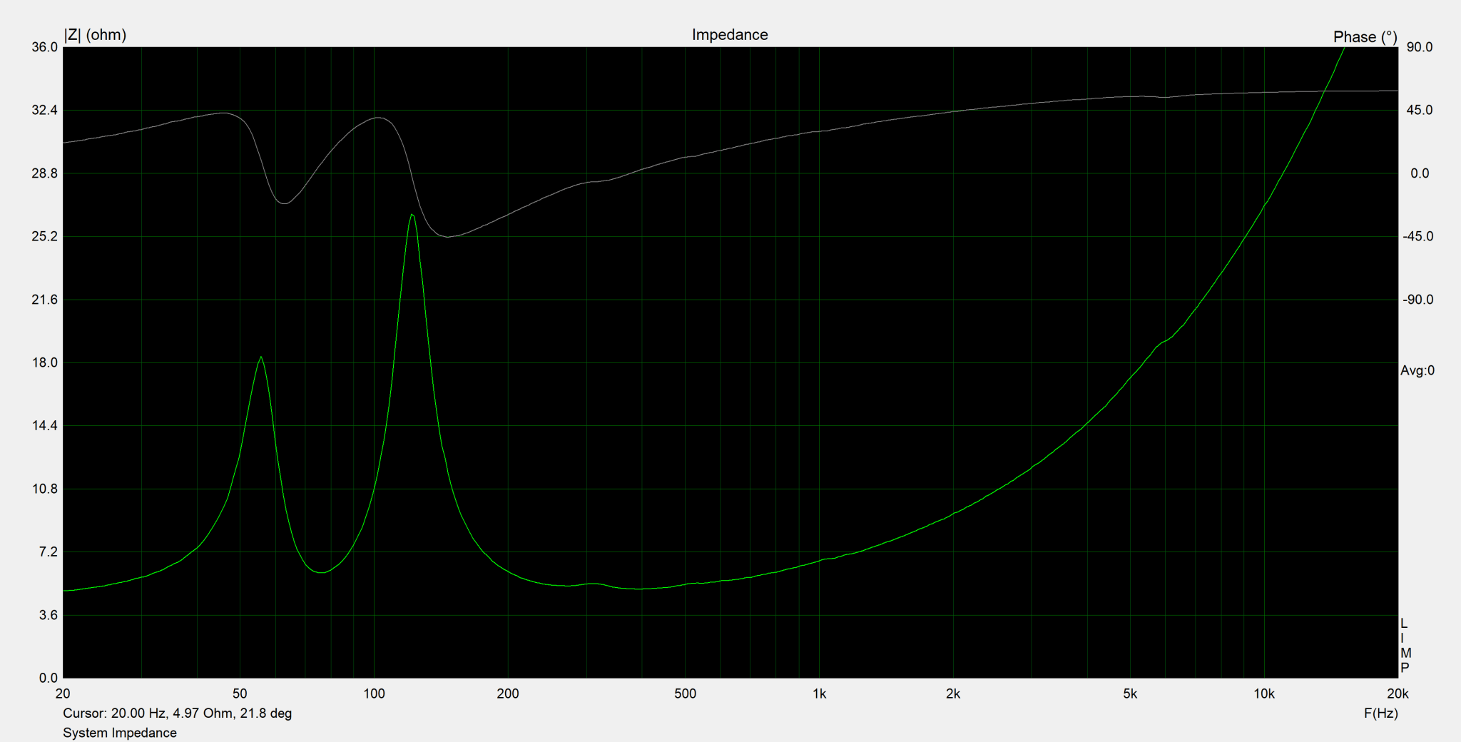

I am extremely disappointed by the fact that no one is taking measurements here on diyAudio. There are only theoretical heroes here who type more or less gross nonsense with their keyboard. So once again I spared no effort or expense to be the first again.Buy or rent a Klippel NFS!
or
Buy or rent a really big anechoic AND quiet facility
or
Buy or rent a microphone without distortion
But:
Do it yourself!

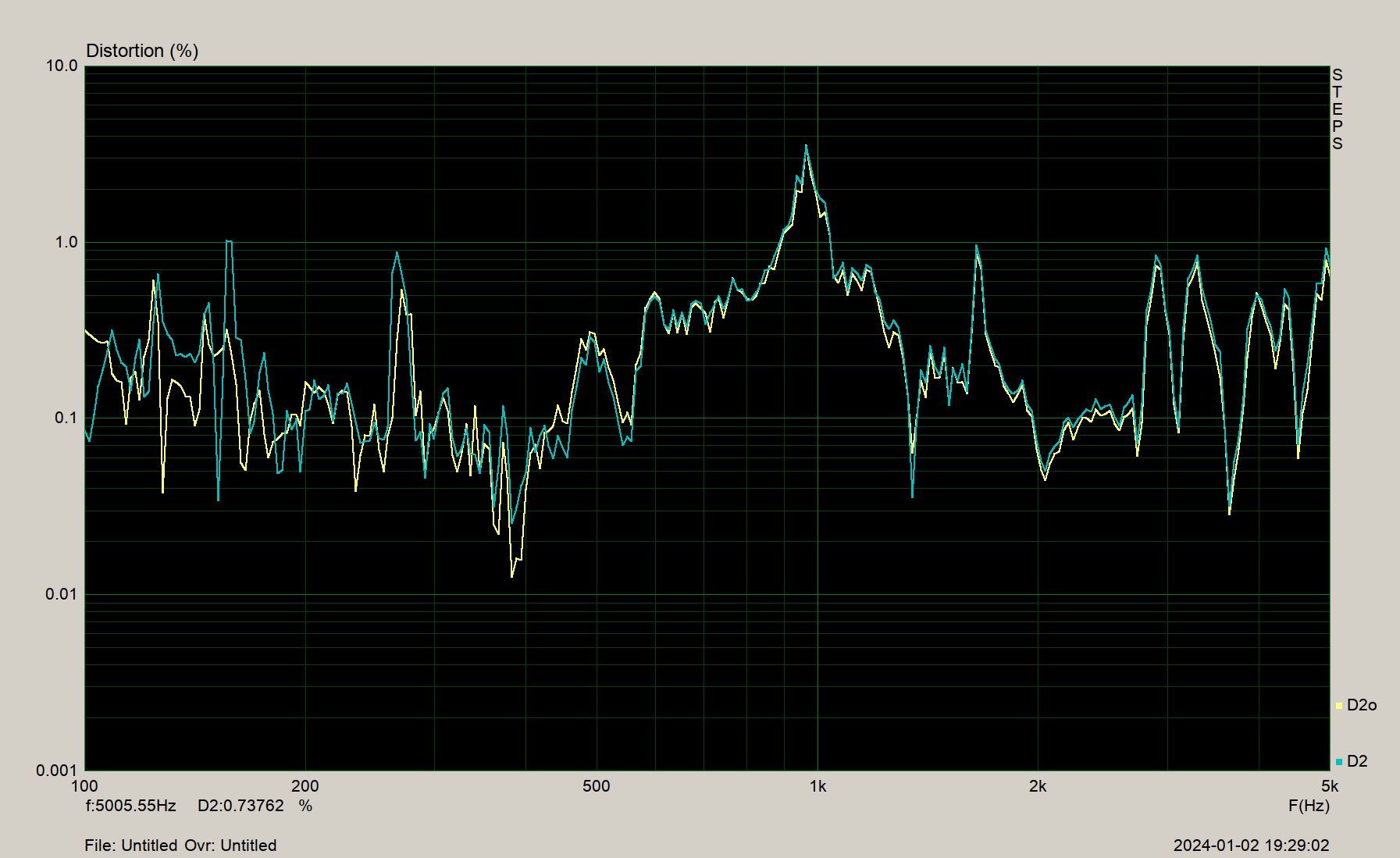

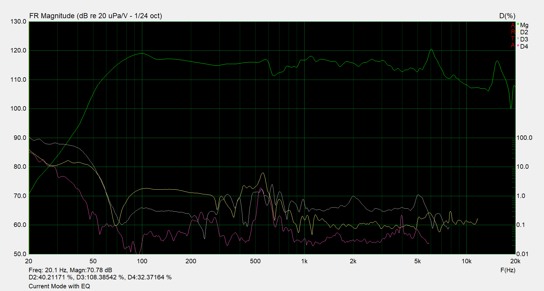

...to prove the distortion resulting from a mechanical resonance as such.
D2o is without 20R hence 0R
D2 is with 20R series resistor
Yeah there is also 2nd order distortion visible on the first post, but there it is rising towards lows, and about only common thing is the peak around 1kHz.

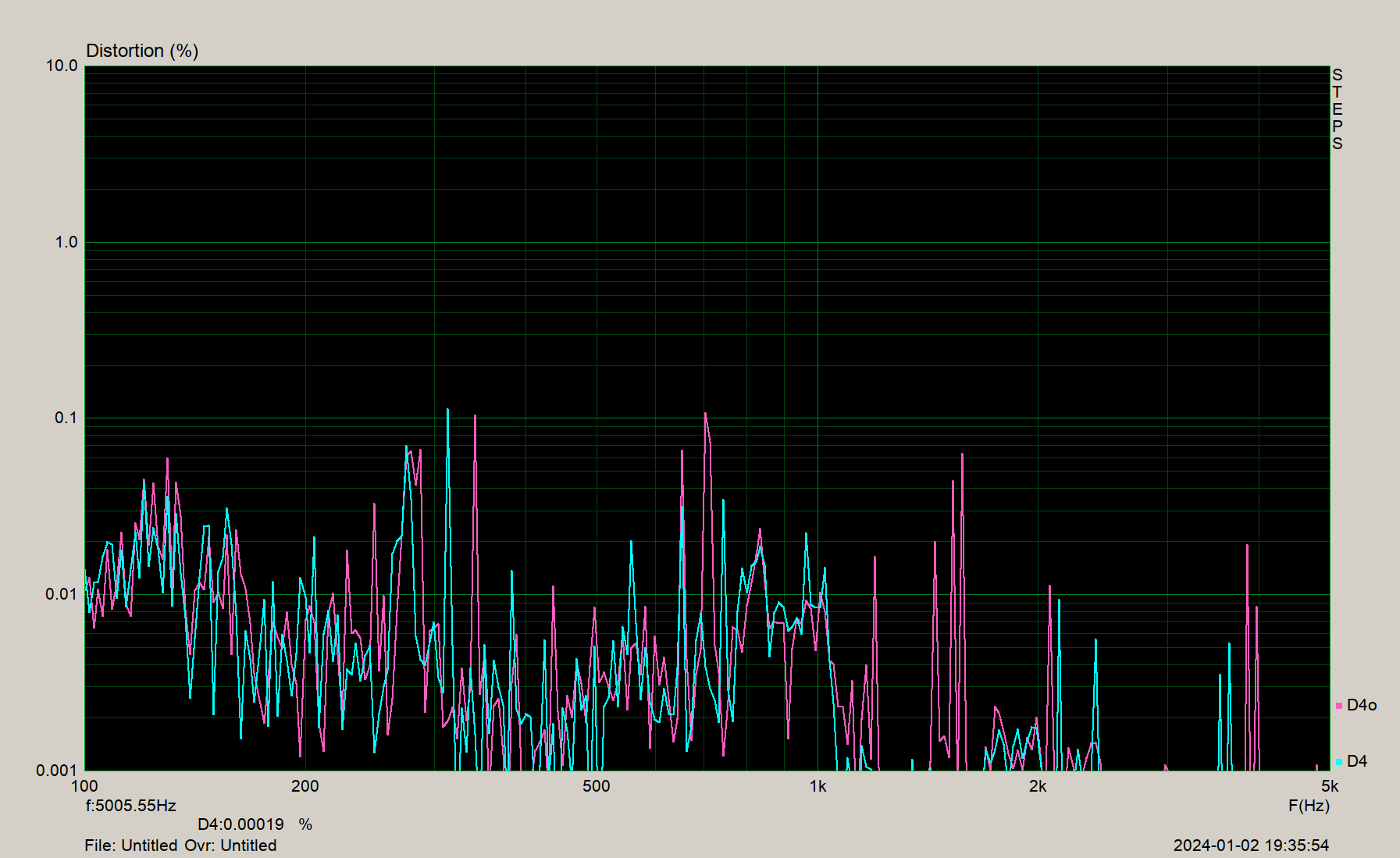

Why is this measurement plot different? what I should be looking at? By saying proving mechanical resonance makes distortion, do you refer to the 1kHz peak or something else? Or is the point here that 2nd order distortion is not much affected by the resistor, or something else? thanks!

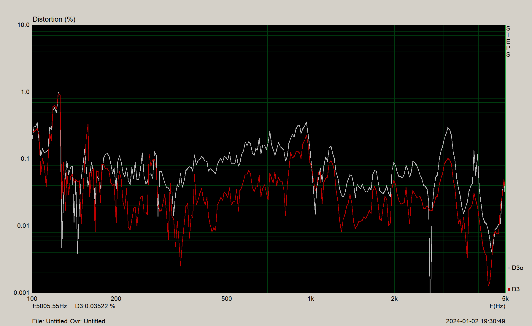

Yeah, assuming #146 is acoustic measurement it shows that 2nd order harmonic is not affected (much) by the resistor, which means main source for 2nd order harmonic distortion is not in electrical domain, but in mechanical / acoustic domain.
Measurement in post #1 shows distortion measured in electrical domain, which shows that a series resistor reduces 2nd order harmonic through out the frequency spectrum. It shows all harmonics are reduced in electrical domain. This is due to following reason: to maintain fair measurement condition acoustic output was kept the same with or without series resistor. This means there was increased amplifier drive voltage to reach same acoustic output (cone excursion) with series resistor in place. As the cone excursion is the same with or without resistor, also the backEMF voltage is same on both cases, but the current from backEMF voltage is less due to the increased circuit impedance, the resistor.
Since distortion measured in electrical domain reduced with series resistor it means the distortion (current) was mostly form the driver, from backEMF voltage, which now makes less current in the circuit with the high impedance. If distortion did not reduce in electrical domain with series resistor, it would then mostly be from amplifier. Distortion from amplifier is small as plot in post #9 shows, so the distortion (current) in post #1 is indeed from the driver.
If hörnli posted 3rd order distortion plot measured in acoustic domain, it should show reduced 3rd order acoustic distortion with the resistor in place, because main source for 3rd order acoustic distortion seems to be in the electrical domain, in the motor, which translates to acoustic domain through current generated by the motor, which was reduced due to the resistor.
It's nice that there is measurements, but they have hardly any meaning to most without discussion / explanation. The stuff explains itself if everyone knew what the plots represent. It is very hard topic to explain understandably, and I've tried too many times everyone have their own way of thinking, which makes complex topics like this quite hard to communicate.
If my assumption about measurement in post #146 is not correct, hopefully there is explanation by hörnli how the data was generated, what it represents and what it shows. Perhaps there is more to it, I do not know what hörnli has in mind.

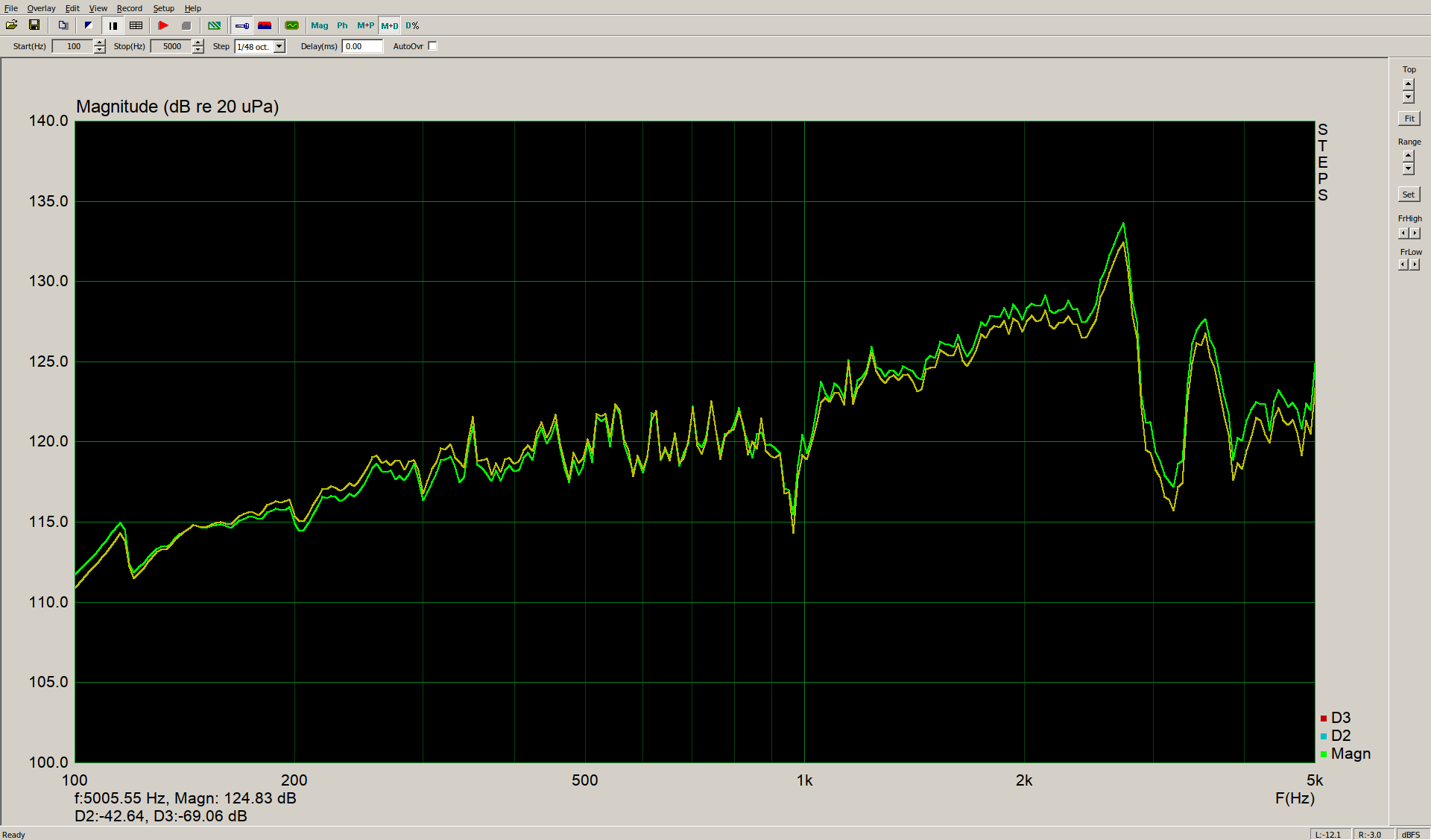

here you go:If hörnli posted 3rd order distortion plot measured in acoustic domain, it should show reduced 3rd order acoustic distortion with the resistor in place, because main source for 3rd order acoustic distortion is in the electrical domain, in the motor, which translates to acoustic domain through current generated by the motor, which was reduced due to the resistor.
Hi, thanks!

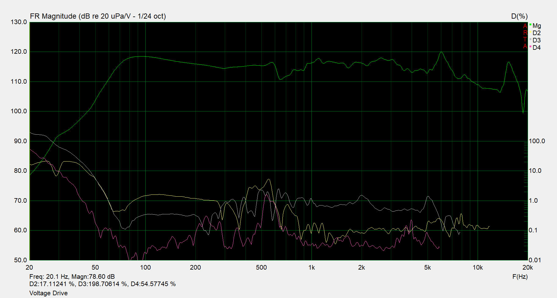

These are interesting measurements, since there seems to be peak around 1kHz in all the distortion measurements as well as in the impedance plot. Even in this acoustic measurement of 3rd harmonic it looks like the resistor doesn't help as much as elsewhere, which indicates there is relatively strong distortion source in the acoustic or mechanical domain around the 1kHz.
Which driver is it? and what are the box dimensions and damping? What do you think where the 1kHz region gets the distortion from?
I'm not expert on the details, I bet causes for harmonic distortion and distribution of the harmonics are likely explained in detail in various studies and white papers, like why there is lots of 2nd harmonic in acoustic domain, and not much higher order harmonics.

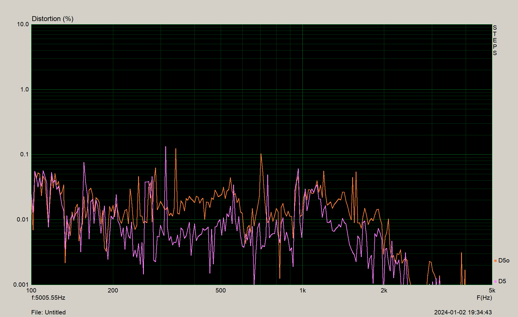

For completeness, small addition to the above: by stating that 3rd order harmonic seems to be from electrical domain I mean that in all measurements I've seen, like yours, the added circuit impedance reduces the 3rd order harmonic (and higher) in acoustic domain much more than 2nd harmonic. This indicates most 3rd harmonic is from driver motor (electrical domain) and not from mechanical or acoustic domain while most of 2nd harmonic is not from electrical domain but mechanical / acoustic. I believe both 2nd, 3rd and higher harmonics are generated in electrical and in acoustic domain, but which ever makes the most dominates the graphs.If hörnli posted 3rd order distortion plot measured in acoustic domain, it should show reduced 3rd order acoustic distortion with the resistor in place, because main source for 3rd order acoustic distortion seems to be in the electrical domain, in the motor, which translates to acoustic domain through current generated by the motor, which was reduced due to the resistor.
I decided at the beginning of the project never to name the transducer.Which driver is it? and what are the box dimensions and damping? What do you think where the 1kHz region gets the distortion from?
Posting #81 this thread:
Elsewhere I mentioned the membrane area: Sd: 200cm²volume: 100l
fill: 4,375 kg sonorock (idea: Esa Meriläinen)
resistor: 20R
1kHz ...
We see it in the impedance plot.
We see it in the sound pressure. (I will dump the full set of my microphone measurements below)
We see it in the D2 current
We see it in the D2 sound pressure
You found it in the D3 sound pressure (great find!)
Now i see it in the D5 sound pressure too
This statement, as simple as it may sound, is very significant.I believe both 2nd, 3rd and higher harmonics are generated in electrical and in acoustic domain, but which ever makes the most dominates the graphs.
It takes several measurements using different measuring methods to reliably identify the causal source of a fault. This was achieved here using rather ordinary methods.
The overlays are without the 20R (hence 0R)
The overlay in the graph of the fundamental is yellow
^Yeah, the distortion measurements indicate it is not from the motor.

Here is the Dayton ND91-4 in a small ported enclosure. Amplifier is TPA3255. Measured anechoic at 50cm with Beyer MM1, I didn't think to check the SPL since I was interested in the relative differences. It was probably about 85dB 1m just guessing.
Below: Voltage Drive
Below: Amplifier has a bridged output so I added one 10R resistor in each phase.
Yellow: Voltage Drive
Pink: 10R resistors
Green: 10R resistors with EQ
Below: Distortion products with EQ'd 10R resistor drive.
Conclusion - Practically the same across the full range. I think some of the mess around 500Hz is port resonances.
