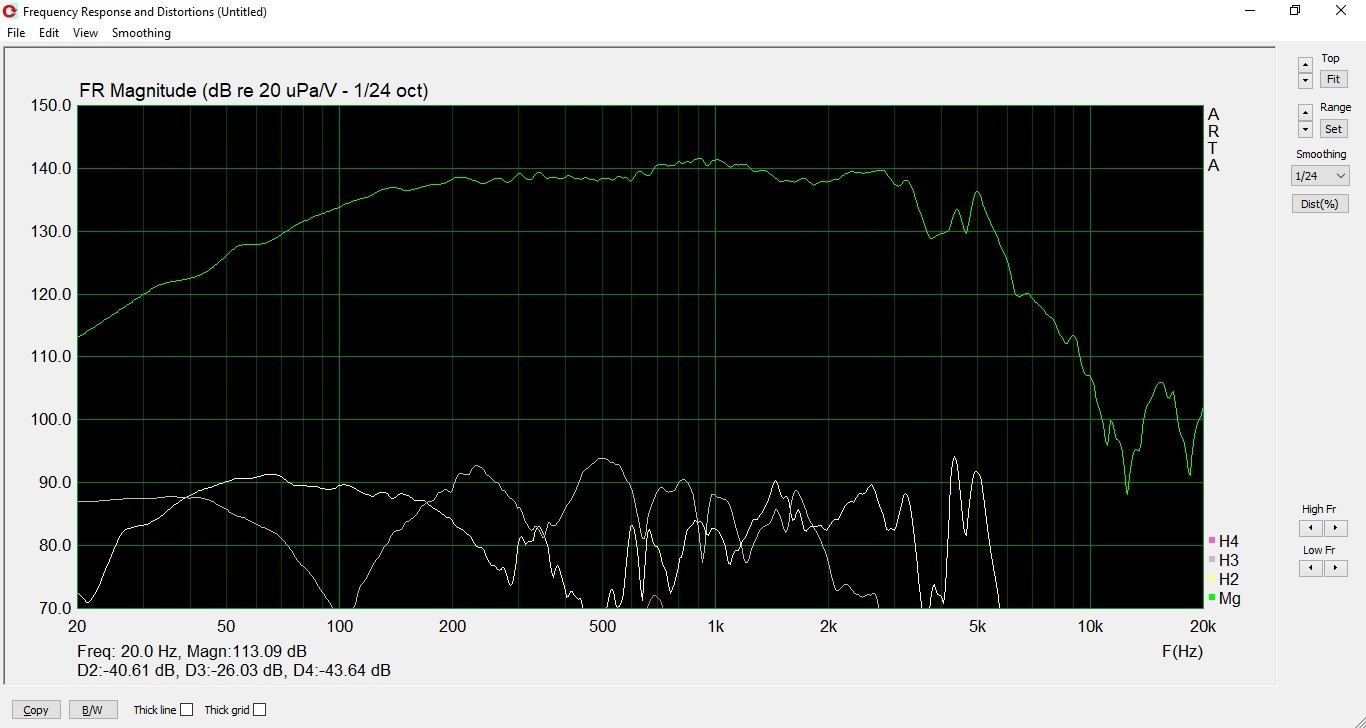

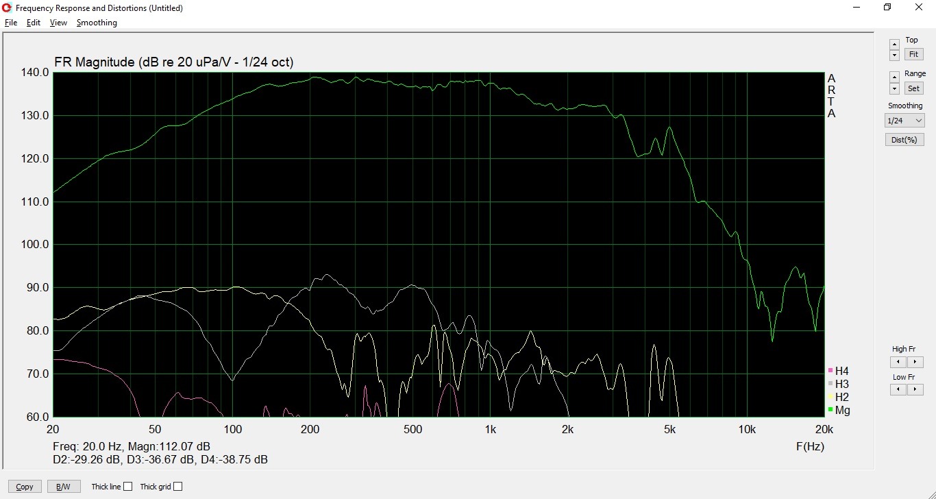

I could only find this, comparing a 18sound 8" with and without 1mH coil. No EQ applied, but the level was adjusted to have a similar SPL in the 2k region. You can see the distortion is lower even if the output is on a similar level. You can also see that above 1k H3 is reduced relative to H2. SPL scale is not calibrated, and it's measured with mic close to the driver to get better SNR.
This is not what I usually look at (prefer multitone), but it's all I happen to have saved. I'm not good at documenting stuff, and I had a USB stick with all my projects on it that got destroyed, so I lost a lot of measurements.

It was a single-channel measurement. The amplifier is LM4780, distortion is well below the level of the ND91-4 driver.
If I used a reference channel after the EQ unit, the EQ would be subtracted from the measurement, which is not helpful.
Later I might try with some more drivers like midrange and tweeter.

I have a real hard time understanding what the traces represent in the plots. They should have a legend or a label added.
Doesn’t anyone use REW on this thread? Legends are automatic if you name the measurement in its label box.

With 20R at 4R nominal transducer you should see more than 8dB (1% to 0.4%) reduction in D3
