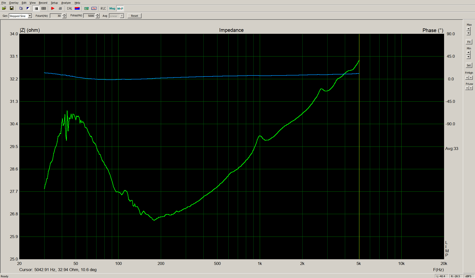

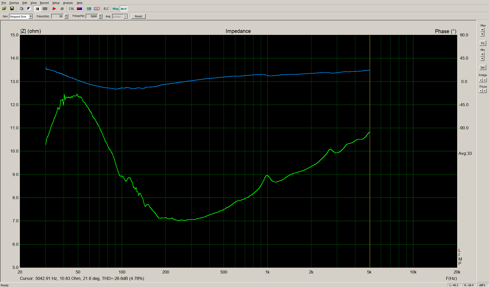

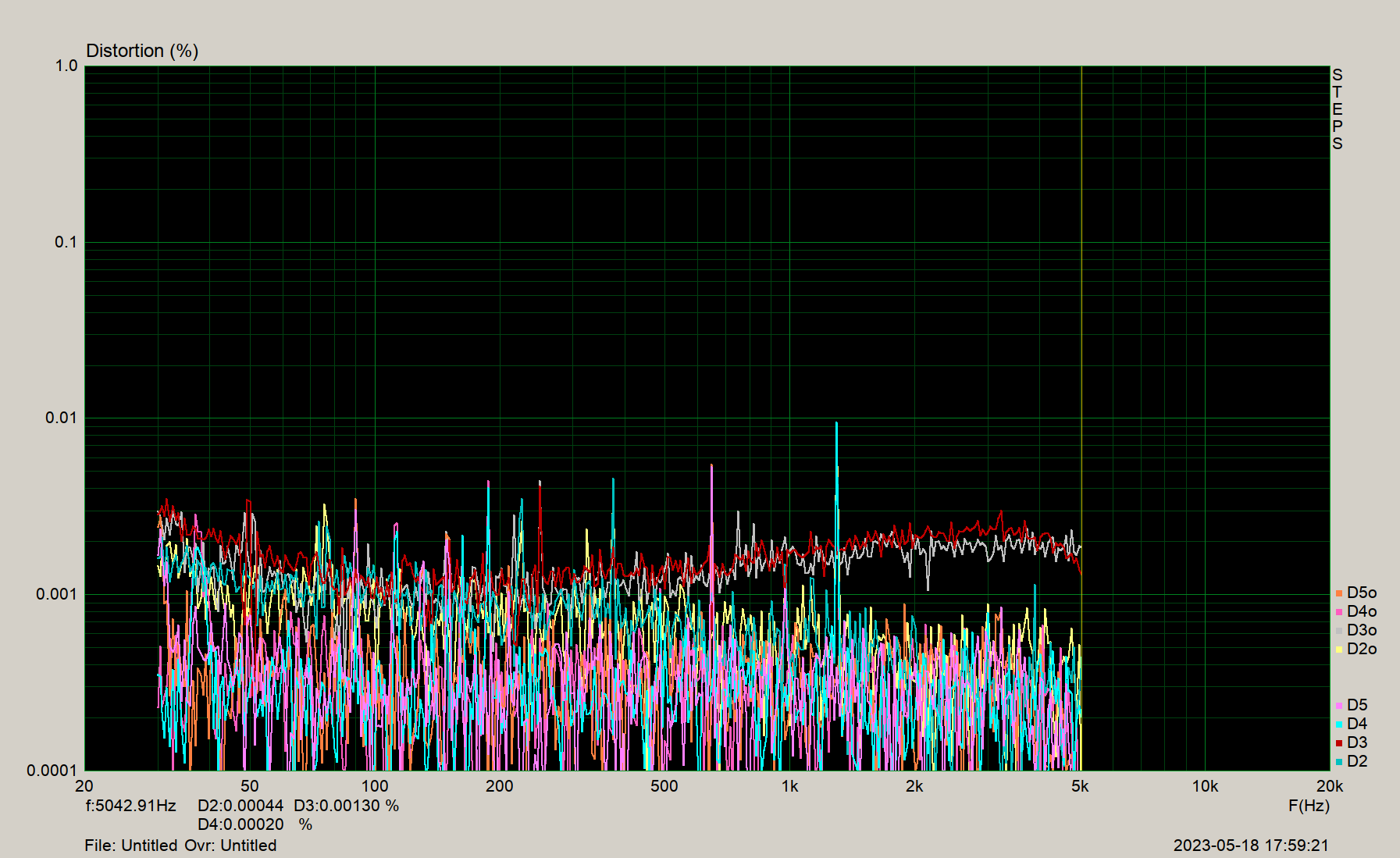

It's a closed box speaker, connected once through a 20 ohm resistor, then directly to the amplifier. The impedance plots are self-explanatory.

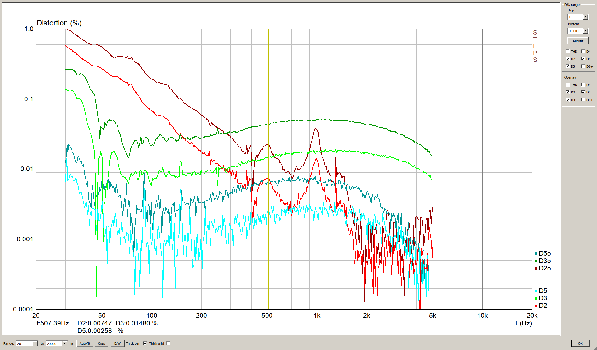

The distortion measurement shows the harmonics in the current to the speaker. Once connected via the series resistor, then directly on the amplifier in the overlay.
Have you ever measured current distortion on a loudspeaker?
I have.

Looking at your measurements of the impedance, which one is the one with 20ohms in series? If i understand what you stated, the upper one. Same for distortion, rhere it appears the current driven distortion is higher, correct?@>JanRSmit<

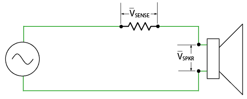

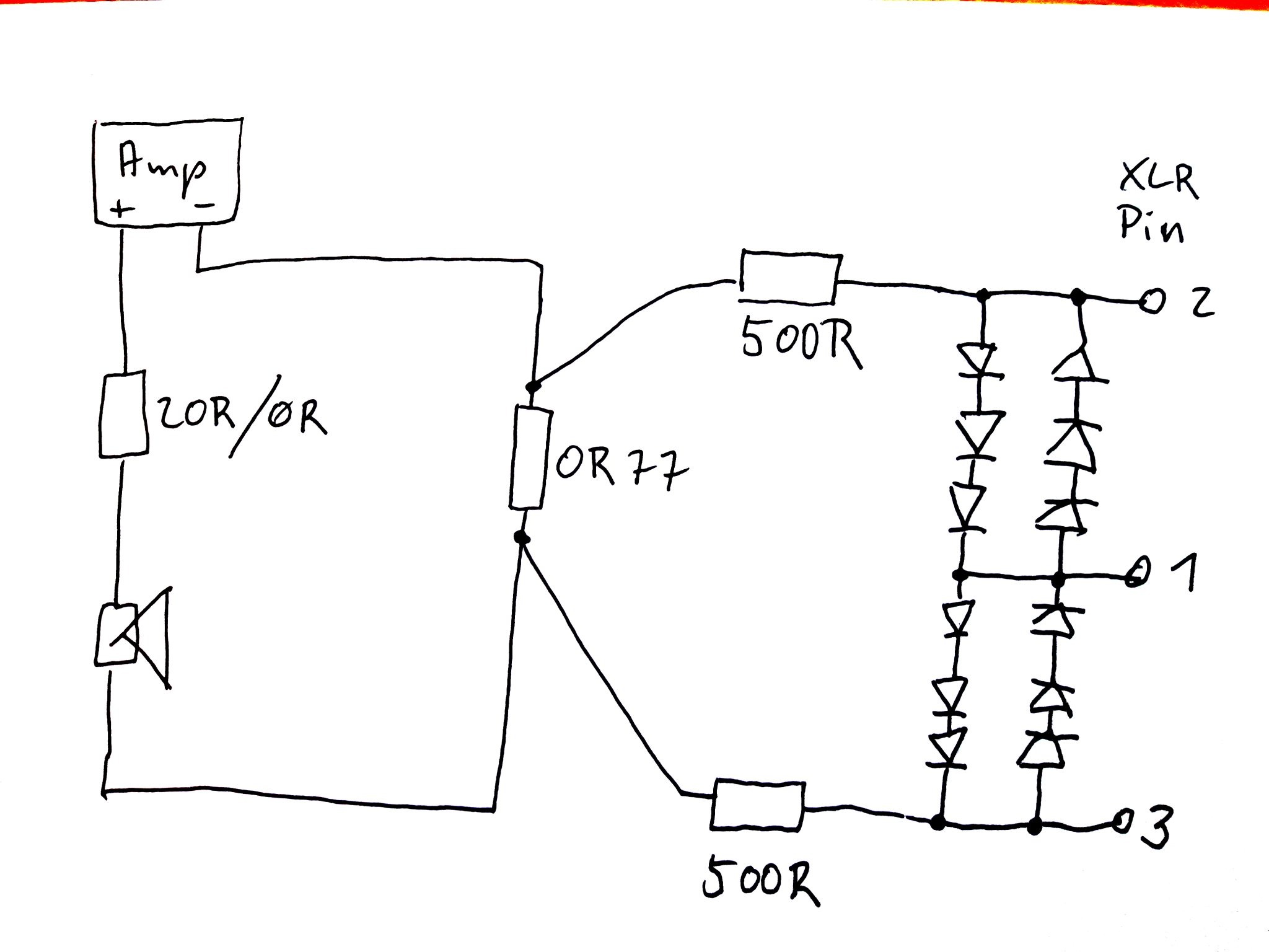

Thank you for your question about the measurement setup and a sketch. Here you are. I hope the sketch covers your interest.
Feel free to ask. View attachment 1206397
Just an experiment with the 0.135Ohm rig for imp-meas i used for distortion measurment acros the 0.135Ohm resistor thus current distiortion.
THe amp output voltage is 2.83V rms
The connection with the Scarlett2i2 is with unbalanced line-input, but calibrated (~483mV rms)
The Overlay data is the measurement of a TT4.0M04-NAC-04, the other is measurement of a 6R8 resistor.
Still learning ARTA-STEPS and its configuration.

It's not easy to read measurement diagrams. Thank you for bringing this to my attention.
When looking at my measurement diagram for many hours, a visual mnemonic has formed for me. My visual perception now sees three pairs of curves. Each pair is similar in shape. For example, the shape of D3 resembles the shape of the overlay D3o. I tried to enhance this effect with similar colors. The darker color in a pair is the overlay and thus the curve without the 20R resistor, i.e. directly on the amplifier.
Regarding my impedance plots:
Look at the Y-scale on the left of each of the two impedance diagrams. The scale shows Z in ohms. This makes it clear which diagram is which

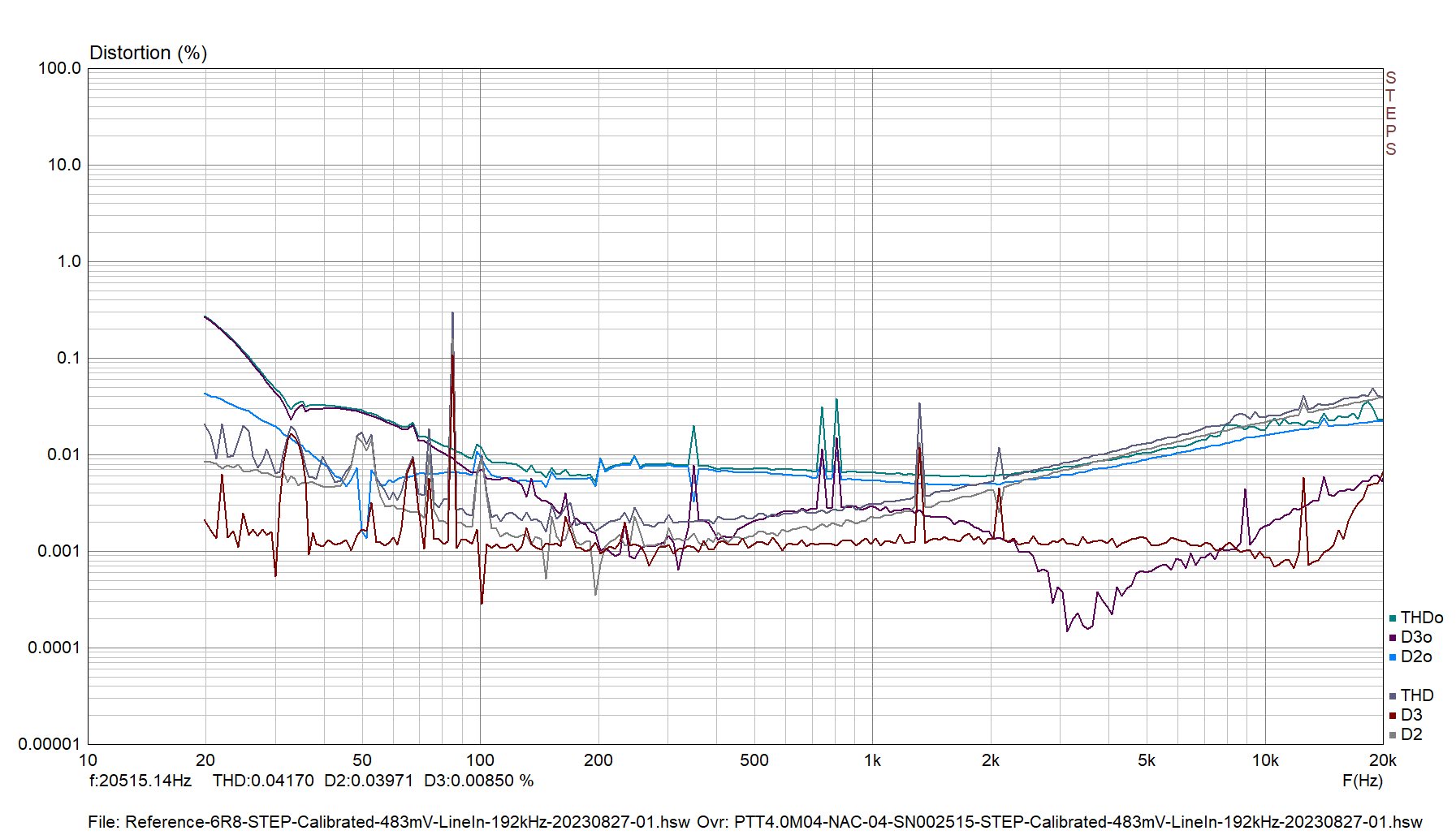

This is a 8R25 in place of the Loudspeaker. Again with and without 20R resistor. I have similar spikes.
This remarks me about cancelling less useful plots next time, as i did in the opening post to D4/D4o. D4 was so noisy that it was like a curtain.
Luckily I managed not to destroy my 2i2, but I hit the diode limiter several times, please be careful. The diodes are 2N4004.

How did you do the calibration? Multimeter? I have to admit there was no calibration at work with my measurements.
My answer risks endless discussion. I have had extensive experience on the internet on this subject since 2004. I am fully aware that you probably have more intelligent interests than my short answer can satisfy. So I would like to ask you: please ask.Hornli, did the two measurements ( one with and one without the 20R resistor) produce the same SPL output from the speaker?
For the same voltage at the amplifier output, the 20R resistor results in a current level that is about 10 db lower. So the voltage at the amplifier output was raised by about 10 db in order to have at least a very similar current level in both measurements. The level of the sound pressure depends immovably on the level of the current. Now: please ask!
The question was clearly about SPL - not volt or amp.
"Hornli, did the two measurements ( one with and one without the 20R resistor) produce the same SPL output from the speaker?"

Thanks TNT. Looks like the answer is there (I think), if a little burried. My intention is to learn, Hornli, and I am well aware of this phenomenon. In fact, I am playing around with high output impedance amps and current source crossovers.
So, looks like the SPL was matched for the two cases, which would indicate dramatic improvement. The problem I am encountering is that when you raise the output impedance, you have to produce more voltage for a given SPL. Some amps hit the rails on material with large dynamic range. Can be heard as gross distortion. So, it requires a bit of thinking and redesign to achieve proper results.

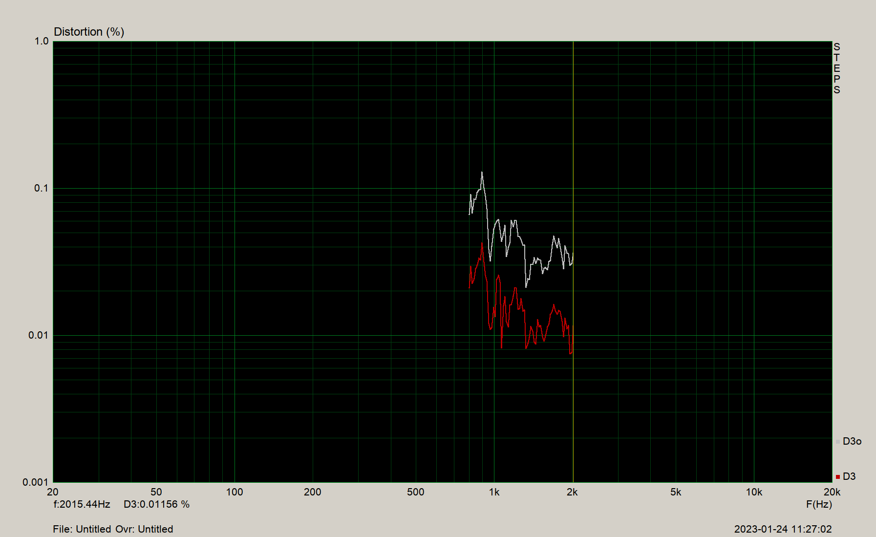

I would like to suggest to start deleting graphs without interest. I would suggest showing only D3 and D3o at first. Please measure the transducer and the 6R8 again. Please show the measurement here.Still have to find a solution to deal with the spikes. Any idea?

Your measurements were used in a German forum as proof for not working distortion reduction by using a resistor. As any measurements in the sound pressure domain this measurements are massively flawed by:
The distorting microphone (D2 tracks sound pressure)
Noise hiding D4 and higher
Poor equalization
I did it, I know it, been there to great length...
But you measured it. And your microphone measurements do in part show the reduction of D3 by resistor. Just as mine. See attachment.
