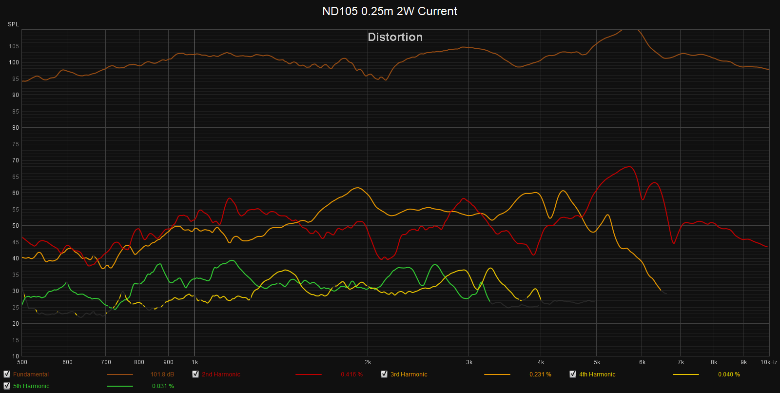

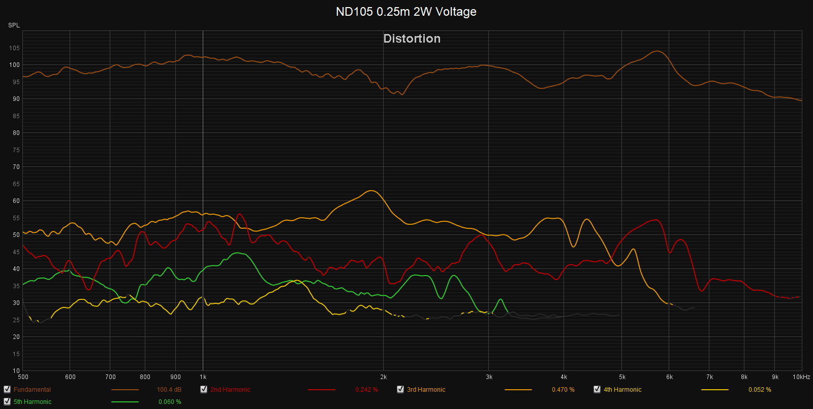

But you measured it. And your microphone measurements do in part show the reduction of D3 by resistor. Just as mine. See attachment.

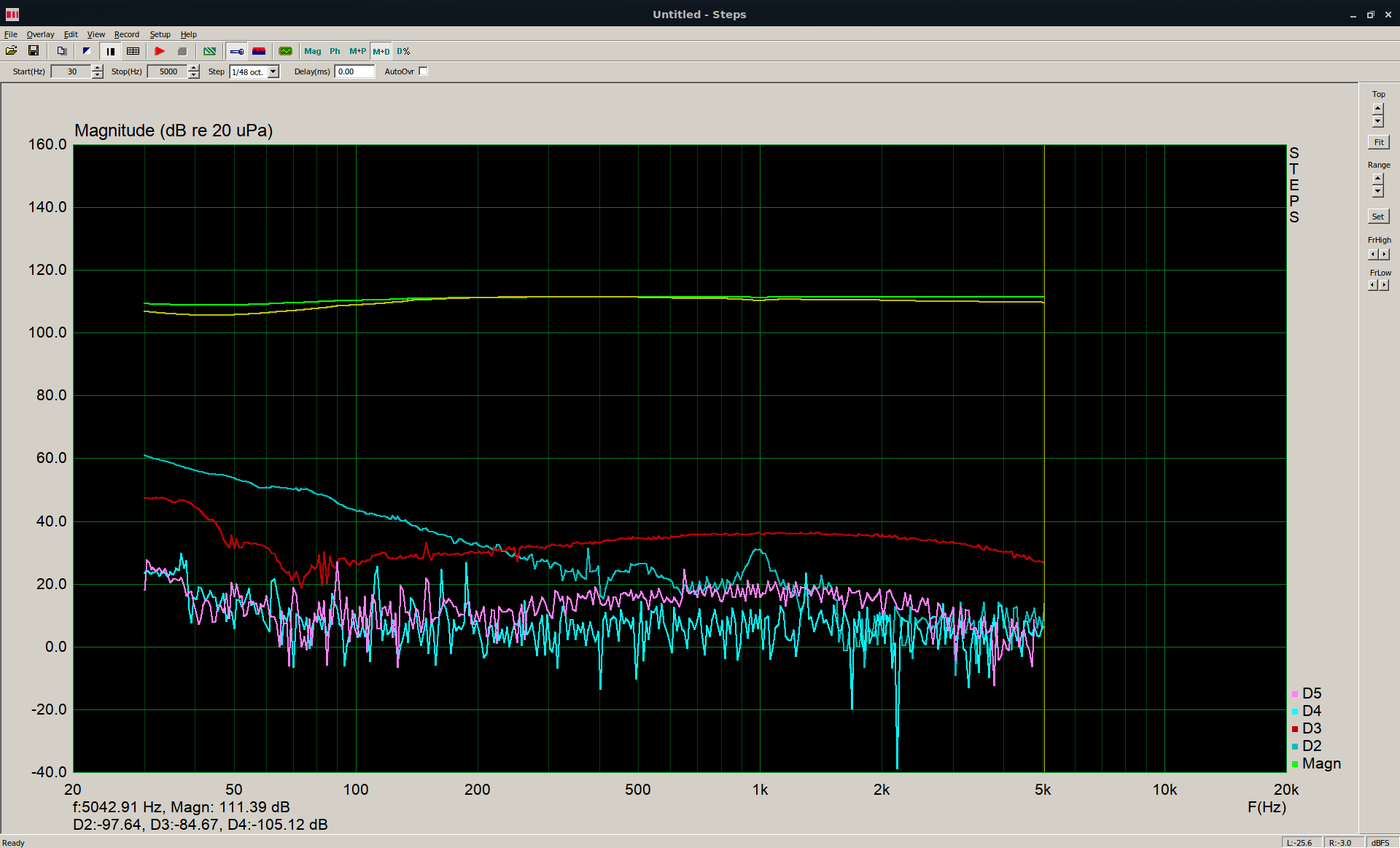

And on the distortion measurements. I have done some with normalized SPL but the result is the same so mostly I'm lazy and don't. Here is a comparison of the ND105 where the driver has higher output above 1 khz but with less odd order distortion. There is slight bump in 2nd order distortion which might be because of the higher output or might be because of the current drive. But even if it is because of the current drive I'd gladly make that trade since I find 2nd order less offensive to listen to than 3rd and especially 5th.

Please have a look at my measurements of D2 and D3 with microphone. The fundamental was carefully matched and equalized to be the same. The D2 does perfectly follow the sound pressure at the microphone (not in archive, sorry). The D2 is solely from the microphone.
All condenser microphones do their distortion in the D2. That is the physics of the membrane foil and the grid. It follows the distance law of condensers.
Virtually all published microphone distortion measurements over the years on the subject of distortion reduction in dynamic sound transducers have this problem.

It seems to me that the flat SPL line (top line) is with zero ohms; the response showing the speaker reonance must be with 20 ohms. That kills the damping and therefor we see the speaker driver resonance.Looking at your measurements of the impedance, which one is the one with 20ohms in series? If i understand what you stated, the upper one. Same for distortion, rhere it appears the current driven distortion is higher, correct?
As for the distortion, I guess but it is not stated, that the lower curves are with 20 ohms?
The question in the German forum was similar. This question was the reason for publishing the diagram there. I suspect that Jan Didden meant this diagram and saw it there. Now that I have published the diagram here, of course the corresponding caption is missing for you here. I would like to provide that here for you:Hornli, did the two measurements ( one with and one without the 20R resistor) produce the same SPL output from the speaker?
Look at the fundamentals at the top of the diagram. These are the frequency responses of the exciting currents for the colorful distortion diagram in Posting #1. Please ignore the (distracting) harmonics for a moment.
Overlay = yellow = without 20R (= 0R)
Green = with 20R
These are exactly the fundamentals of my colorful distortion diagram in Posting #1.
Green = with 20R was consistently “louder”.
However, I also measured experimentally with the opposite adjustment error. This adjustment error attempt did not fundamentally change the picture of the distortions.
