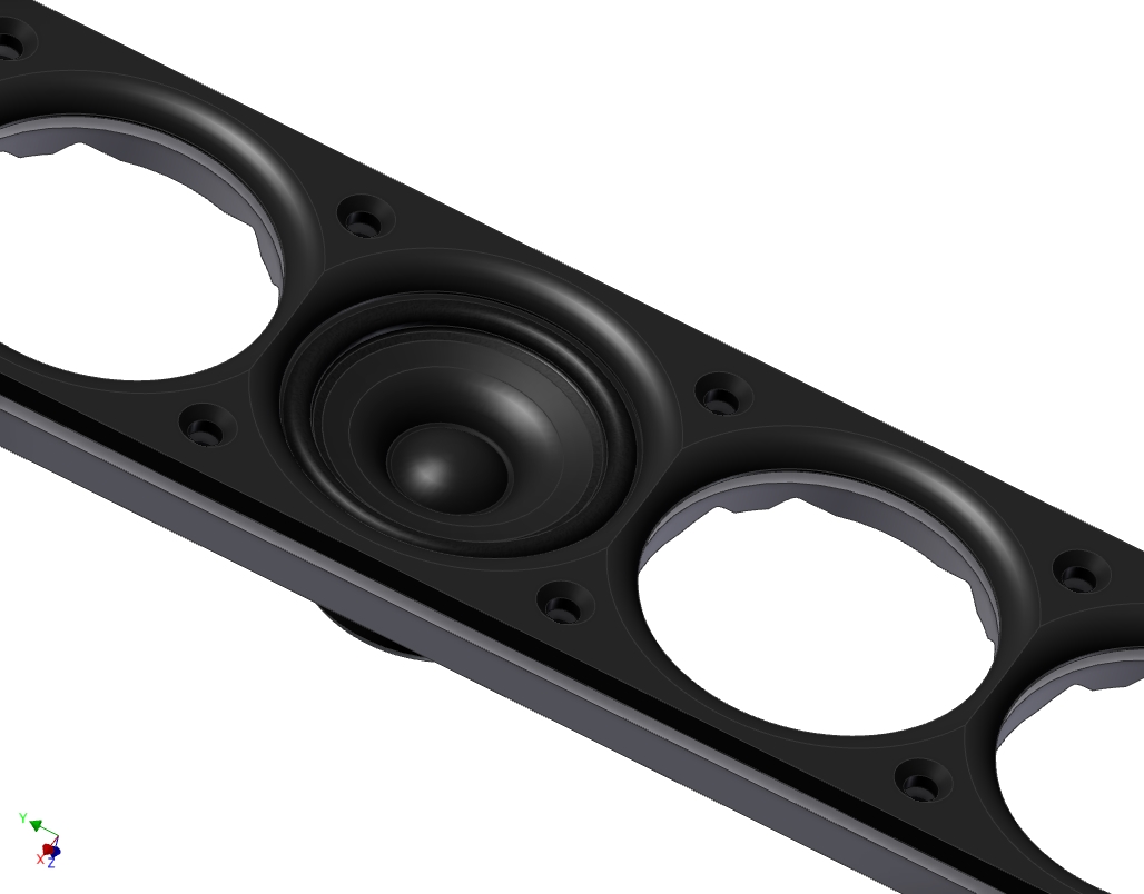

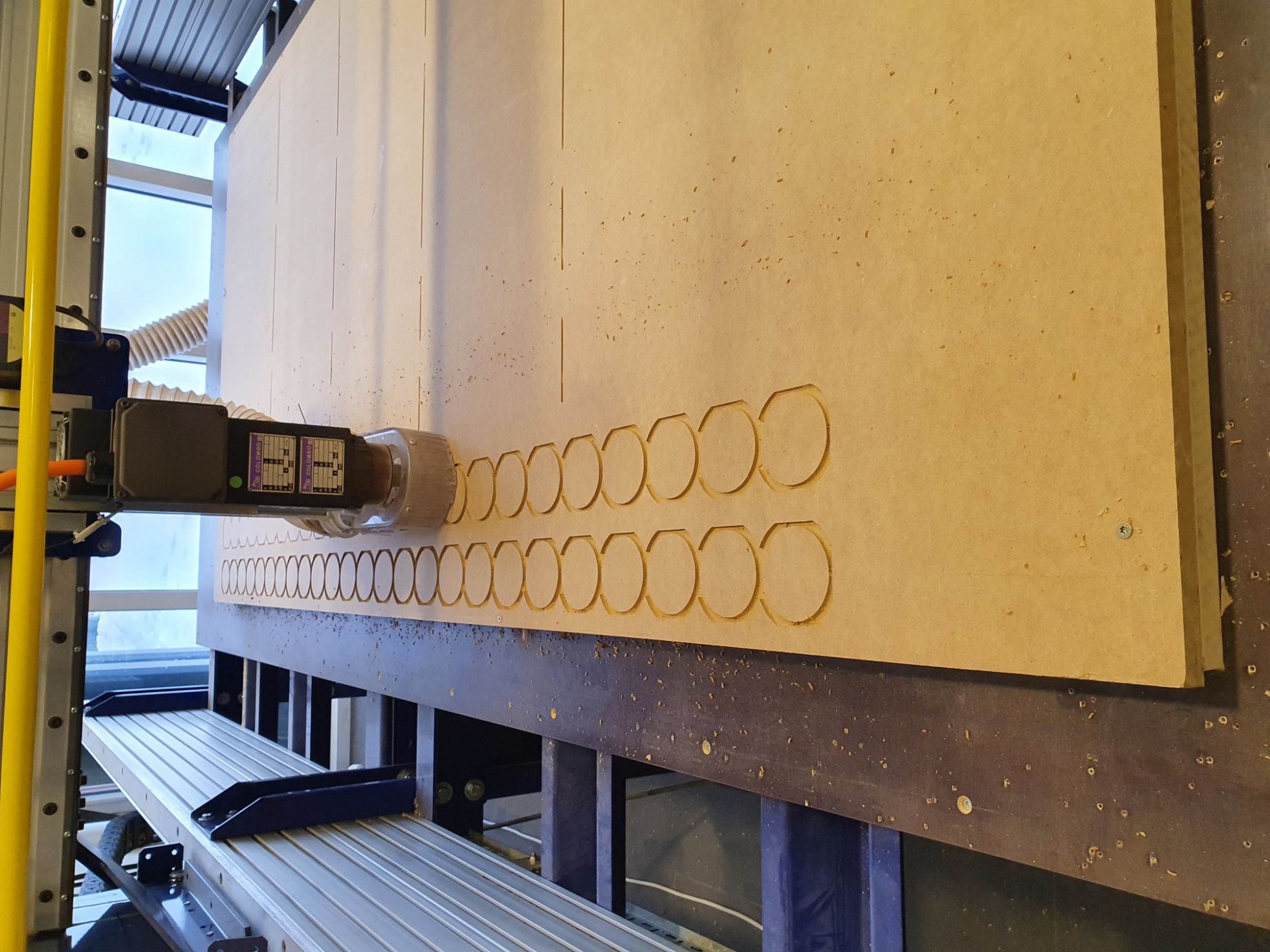

As restrictions have been eased a bit I am quite optimistic about the date I have with the CNC machine early next month. I have decided upon my simplest design yet. All suggestions would be very velcome!
1. I will do my own roundover, the largest roundover bit I have found is something like 12,8mm. I hope that will do.
2. I will chamfer the back of the baffle, as well as doing a roundover on the bracing (and probably some extra holes there.
3. I made a logo, as all respectable designers must have one. It combines a magical stave with an eighth note. As with all good art, the logo has deep hidden meaning and probably exposes the artist's vulnerabilities and sorrow.

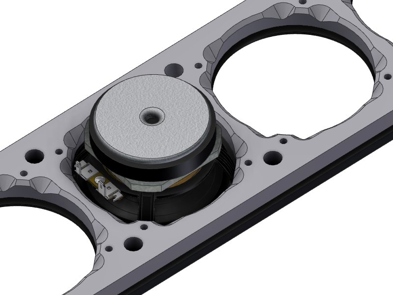

This went quite well. All the pieces are now according to my 20th revision of the design. I made the baffle as narrow as possible, and it is a bit flimsy. However, with bracing and glue, it should become quite steady. So I was happy for about twenty minutes.
Then I saw wesayso and Fluid being huge nerds with their simulation of the 6mm "wave guide". I can't say I was disappointed, rather inspired. This means I have the opportunity to "fix" my design by adding a second baffle, effectively sandwiching the elements in between. This helps with two problems; addressing directivity and the baffle edge, as I could make a baffle which serves no other function than to "massage" the front wave... and look cool.
Thoughts?

I'd say yes to a double baffle. It is what I have...
I used this opportunity to make that double baffle a CLD construction by using butyl in-between.
Front baffle is 6mm in thickness while the round-over I used is 8mm, flush at the front.

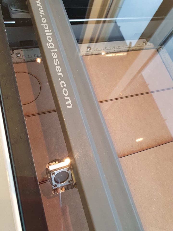

I got to play around with a laser cutter a couple of days back. If you all are starting to worry about what to get me for Christmas, a laser cutter could be a good plan-b. I was seriously amazed by this machine - how easy it is to work with and how quickly it goes through HDF.
