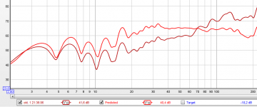

I got a bit of free time tonight. I made myself useful by setting up my UMIK-1 on my desk and installing REW + Equalizer APO. This is actually the perfect test environment, because I have the worst speakers known to man as my lab rats; logitech desktop speakers + sub.
This is the first time I have used any of this so I did not expect any results at all to begin with. To my surprise... I spent about 30 minutes setting up a filter (mostly from 20hz - 300hz) and it is just unbelievable how easily I can make these horrible speakers sound... less horrible! The little tweak I did created a sound stage and voices sound almost like voices. Compared to how it sounded an hour ago, this is quite simply astonishing. Obviously there is nothing going on below... 40hz or so, don't know what the mic was picking up.

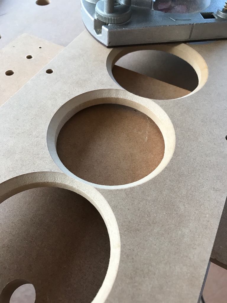

That, I did find out... I bought a cheap router and good quality bits, figuring that would get me through my build. The router lasted a week before the bearings were shot. I immediately bought a better router (brand: Makita, 1850 watt, single speed 22000 rpm) and that survived all I could throw at it. I've been using it ever since for all kind of duties. It even survived using it to machine 10 mm thickness aluminium baffles...
For that I did need to reduce the speed.

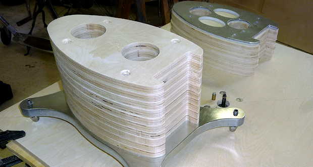

I found it very easy to operate as I have it upside down in a table. The table simply is a Black and Decker workmate with a big piece of ply on top of it. With the copy bits (the ones with roller bearing on top) I could do everything that I needed to do.
In this picture you see one of the router bits sticking out. The bolt with rings behind it was used to make soft starts easier. The router was mounted upside down and I used the guide system that came with it to bolt it to the piece of ply I used as my table. Simple, cheap and effective.
