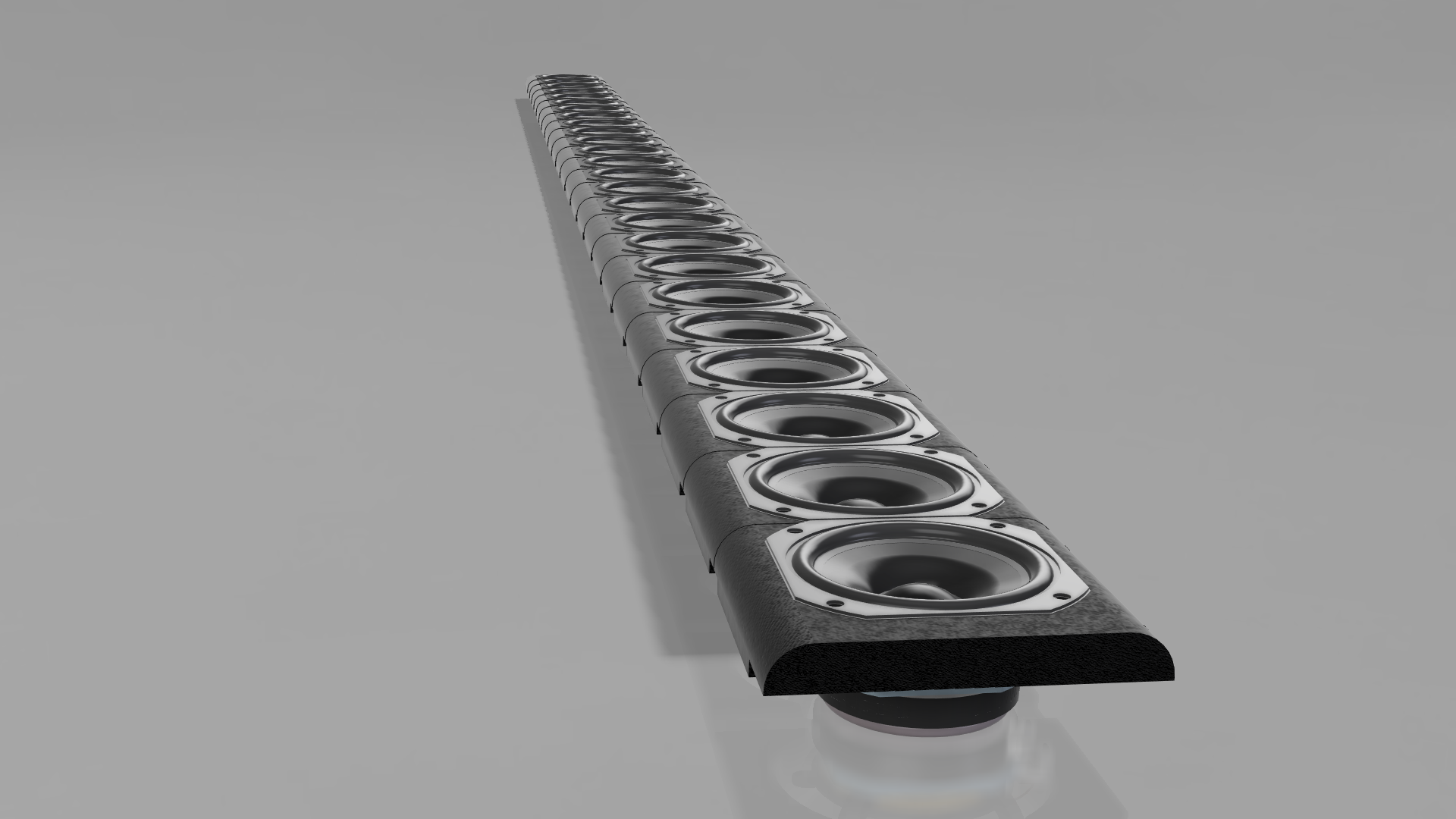

My first front-panel rendering is attached as proof of my intentions, but there are many things yet undecided.

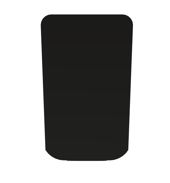

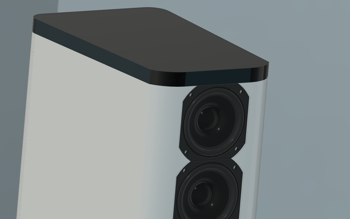

- a. I want a narrow front with sloping edges. Why shouldn't I?
- b. Every speaker will sit in its own chamber. Why is that a bad idea?
- c. I want to avoid screwing the front to the side walls from the front. What should I do?
- d. I am thinking about having a 5-10° angle on the side walls from the front, so that the boxes get more wide towards the back.
- e. I really want the back-side to be somewhat curve-shaped, and removable.
- f. Since I will be using MDF I need good ideas for finishing. I am open to many different ideas.
- g. Since I will be CNC-ing the hell out of those MDF-boards... why not add some kind of artistic expression on the side-walls?
- h. Can I glue everything? Can I screw everything together? What is the optimal approach, what is the worst?

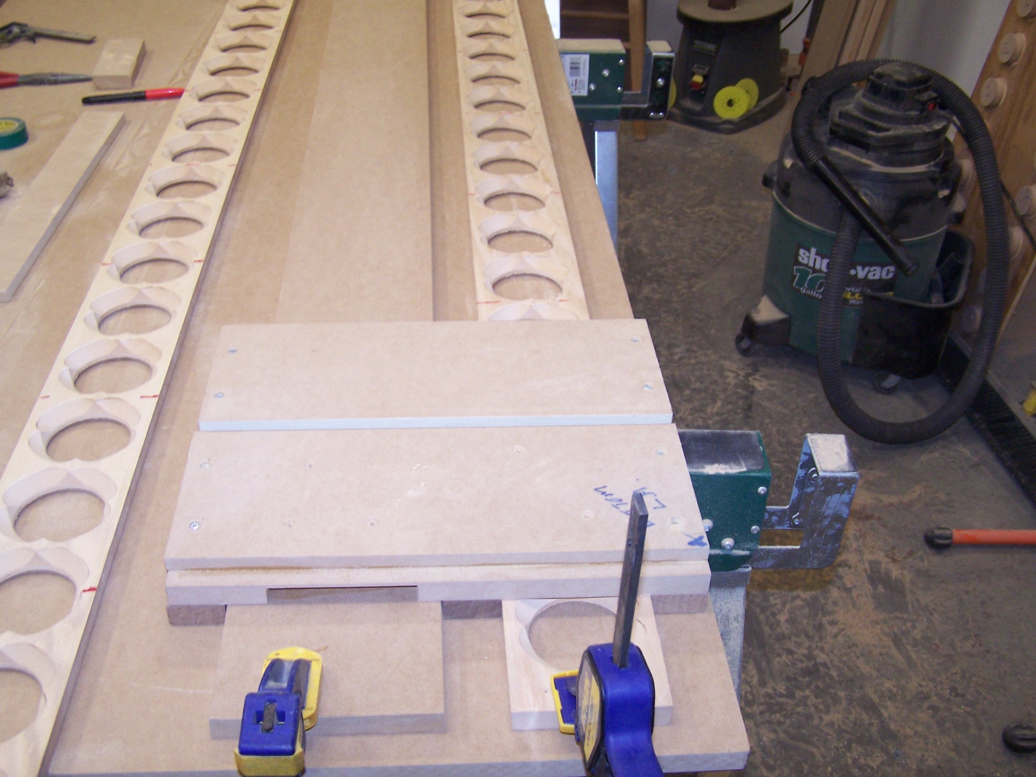

My IDS-24 w/tweeter are "unscrewed" , just folded and glued 19mm MDF.
Separate chambers for each driver secures rigid column and equal pressure profile.
Note the importance of chamfering the rear of midrange holes.

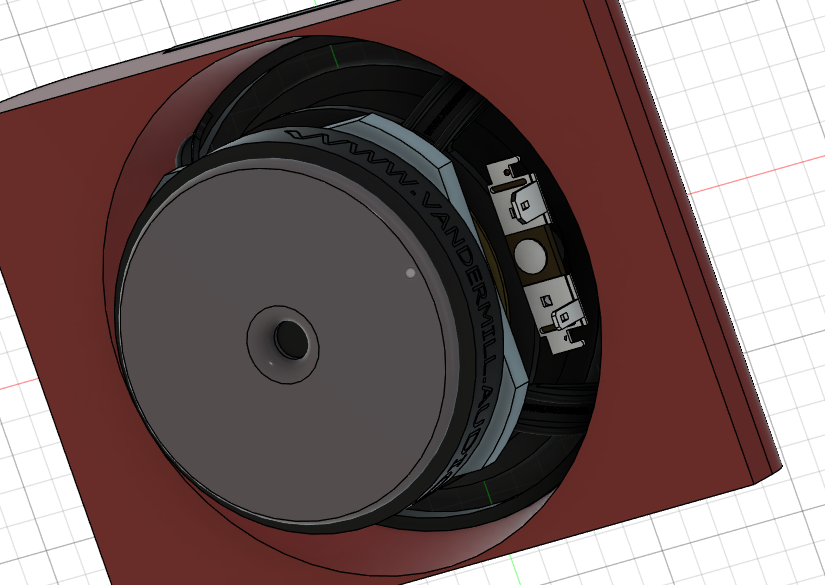

I will also be using 19mm MDF, but I find that chamfering the holes is a bit tricky without hurting the structure of the front - as there is less room on the top and bottom sides, since the drivers will have to stack closely together.
What angle can one get away with?
Wilbur; I see you used a similar overall shape as I was going for. Why did you choose this shape, why did you choose this angle?

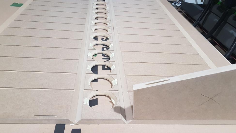

The shape: Trapezoidal section allows for target volume (approx 2,7L per unit) and limiting the cabinet depth.....and I like the IDS shape.
Chamfering the holes was not tricky with CNC. The drives are stacked flange to flange. Chambers are divided by 6mm plaster boards glued to the grooves.At least you should chamfer the holes at the sides. Reference is made to Troels' advice.

Wilbur: my design has chamfering, but I am not sure it will be enough; I will post a screenshot tonight when I get home.

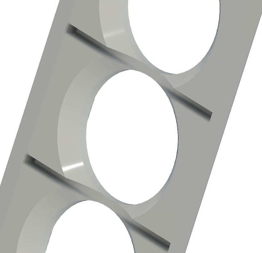

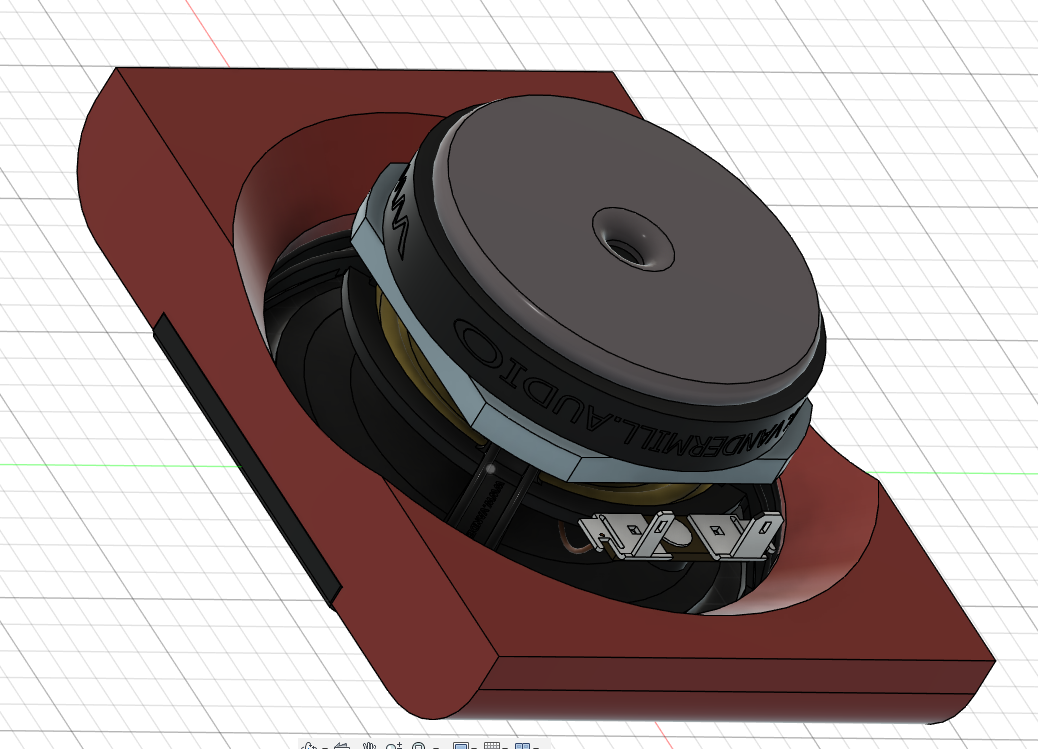

Chamfering
This is what I had in mind to begin with, a 10 degree chamfering from the top.
This has the chamfering starting from 10mm with the full 45° angle. Probably smarter?

The 45 degree looks better for the driver to breathe. Its close to what I used, save for some space to get bolts and nuts in behind the spokes of the driver. Still not behind a PC, so I can't look up a picture.This is what I had in mind to begin with, a 10 degree chamfering from the top.

I'm back on a PC, so maybe I can help out a bit...
- a. No problem at all in my view, As I tried to keep my arrays narrow too, preferably as narrow as a human head.
- b. Not a bad idea, but with drivers close together it is challenging to have a divider between the row of speakers. I closed up the chambers for the first ~15 cm from the driver out, but do have holes (at different spots) between those chambers. Closed should work though. I like the idea presented by wilbur-x.
- c. Incorporate threaded holes in the baffle? Mount them from behind? Maybe something like I did for my subwoofer build could work if the baffle is made of 2 pieces glued together... Front baffle design – Vandermill-Audio
- d. As did the IDS-25
- e. A bit harder to construct but doable, using kerfs to be able to bend a panel?
- f. No comments, I picked Birch ply because I like it better as a material to work with. I never considered veneer or something like that. It was either black or the wood itself like I tried to preserve.
- g. Even though I did just that on the side of my subwoofers, for anything playing higher notes (= shorter waves) I wouldn't do it. Even if diffraction would be minimal, it would still be on my mind . I see big round-overs on that front baffle... that I do like. One only needs to browse through Mabat's horn design tool thread to see that a continuous smooth shape out from the drivers p.o.v. would work best.
- h. Yes you can glue everything. Consider using dowels or interlocking panels...
By not chamfering behind the driver spokes you keep more material for the mounting bolts of the driver itself. I had a double aluminium baffle and bolted the drivers to the inner baffle. Here it is in real life:

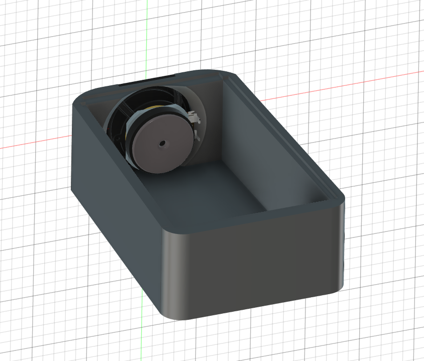

To get the volume within Fusion, you can model the inner space (roughly) and get it's volume I suppose. At least I think Fusion can do the calculation of volume for solids. To get it even more precise you could subtract the driver + enclosure from a solid as big as the two together. That's what I used to get my numbers. Something like the example in this video should help: Fusion 360 - How to Cut One Body From Another - YouTube
It may even be more simple following this: Quick Tip: Find Internal Volume - YouTube and it also shows how to get the volume.
That way you'd be making a model of the inner air and get it's exact properties.

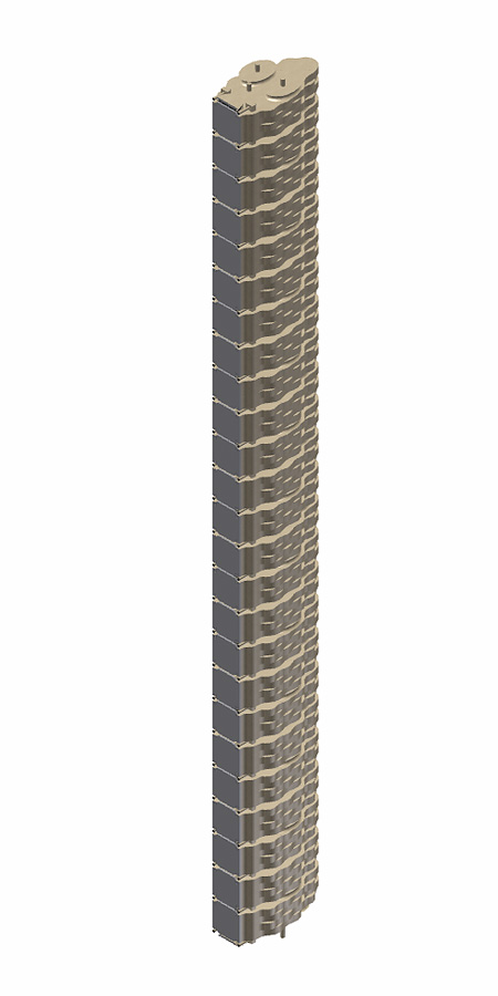

Congratulations on finally getting the PC up and running. All your comments are much appreciated. I am really happy my ideas are not dismissed as idiotic and dumb. Your threaded approach is tempting. One of the few things I have ever designed and built in my life was actually a stereo-rack using... you guessed it, threaded rods. There are many things you say I will have to take into account.

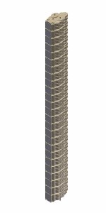

I have actually submitted a design to a couple of CNC-shops (one in the States, one in Iceland (but still 500km from my location)) - just in order to get a rough estimate on the price and whether I have to decrease the complexity of my design. Surprisingly the only feedback I've had for over a month from both of them has been similar: "We'll certainly take a look and get back to you." and "Sorry, we will look at it momentarily."
I decided to use a 2,5° angle - as I thought it looked better and would be slightly easier to work with.
It looks fabulous on paper!

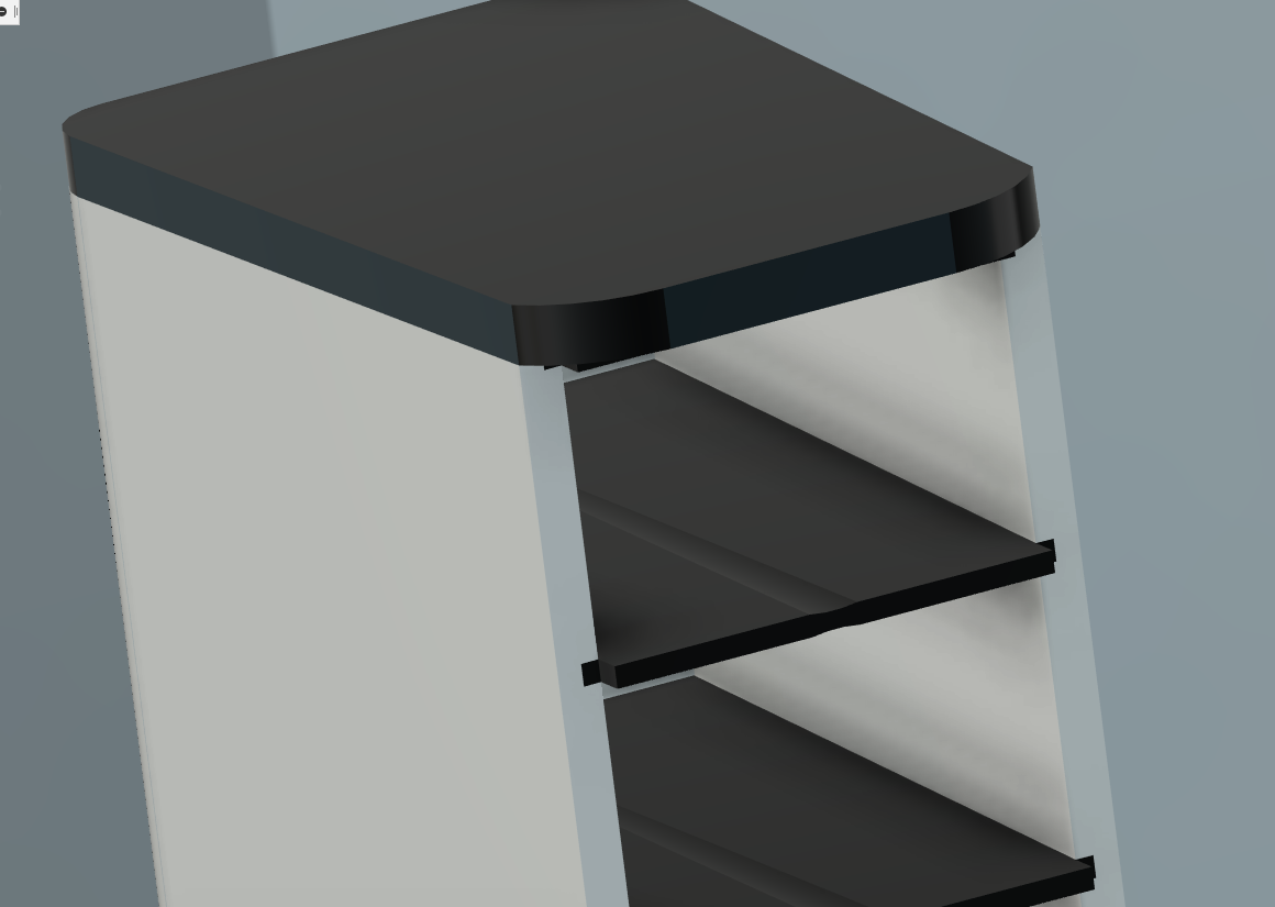

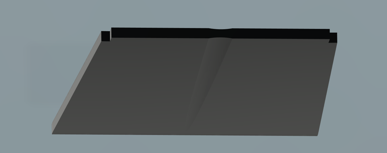

I managed to fit a 6mm divider, but not sure how that will work when building the thing.

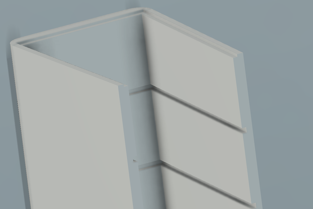

The dividers are probably overly complicated, but it just felt wrong not to continue with the curve shape along the top and bottom of the divider...?

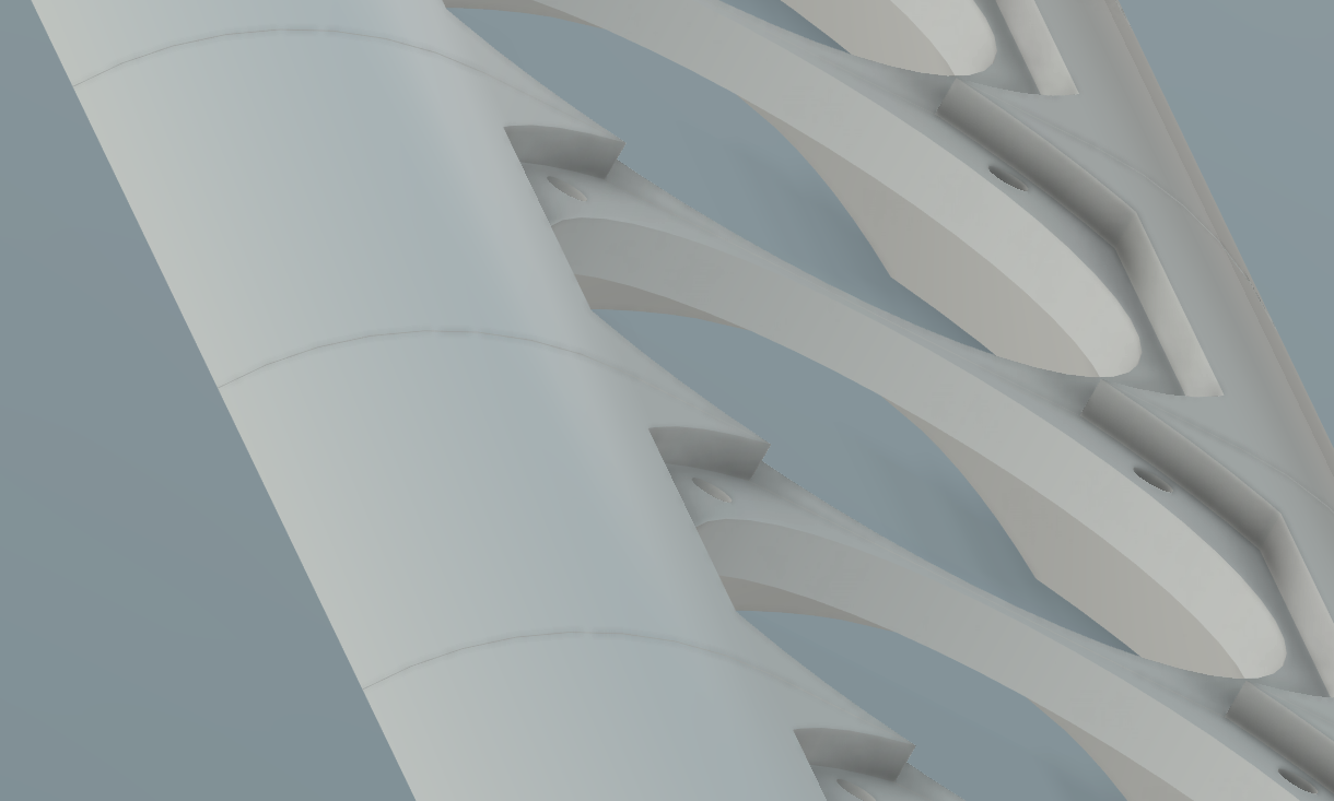

As you can see, I kneaded some interlocking into the dough - hoping that would make the assembling easier.
So hopefully everything will fit nicely together if the CNC-fairies are kind enough.
As I am not a particularly smart individual, I had at least 4 designs for the front before I made this one. I trusted non of them to fit the drivers. I the end I simply inverted Wesayso's driver design and slapped it into my panel, subtracting it's shape and then filing the edges. I hope it fits the drivers.
If the CNC-shops do not give me any positive feedback the next week or so, I will probably make a new design from scratch. With every fresh start I get better and it becomes easier to make fewer mistakes. As some of you have probably spotted none of the walls are single objects. I am not sure if that matters - but it feels wrong - and I would change that the next time around.
