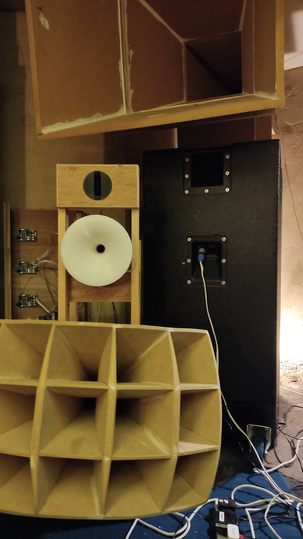

I've just started to play about with 3D printing horns. I have used the linked spreadsheet for a couple so far:
First I made a round 850Hz horn with a simple hypex profile
Then I made an elliptical one:

The system is a 5 way active horn setup. I'm looking to improve results for the JBL 2461 (1", about 1.6k-8k) and 2441 (2", 500Hz-1.6k). So far the round horn is a real improvement over the 800Hz tractrix horn I was using. The second elliptical one is currently printing!

Yeah I'm printing loads of horns at the moment! I've worked out a great way to extract the shape of e-jmlc horns, so that's on the printer at the moment.
I didn't make the multicells myself, but will probably sell them soon now I can print my own. This is much more fun.
As for measuring, not yet... I'm going to build a few with different topologies, have a good listen and then might measure of I can work up the energy to do so.

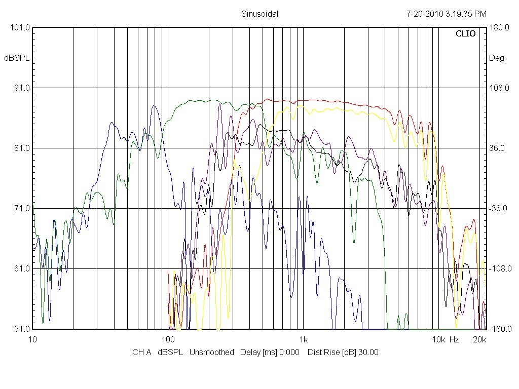

After a reunion with this unsmoothed response plot of a Klangfilm Eurodyn horn in combination with a (GIP) Western Electric 594A (mid driver)... I'm into spherical wave horns again ;)
(Red is on-axis, yellow is about 45° off-axis)
