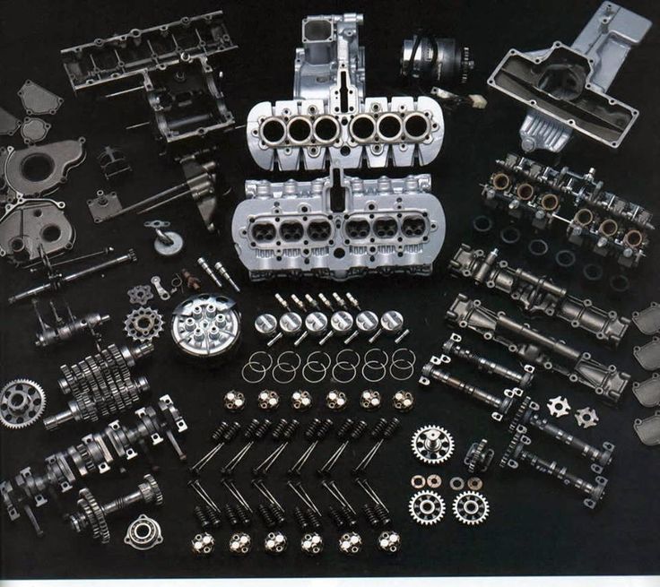

Honda's engineering masterpiece is this:
Complexity causes confusion and makes comparisons between up-to-date SOTA technology and that of one or a few decades ago difficult.
The NSX is undeniably a technological highlight in car history, but it is very hard to compare it with today's cars.
No matter how good, the NSX is far from perfect.
The almost 60 year old engine shown above is about perfect, even by today's standards.

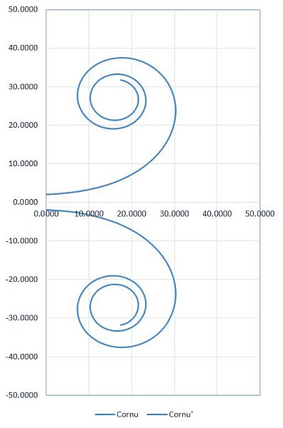

Cornu spiral
a new article about the Cornu (Euler) spiral is online.
Spiral Functions for Horns – The Cornu Spiral – Sphericalhorns

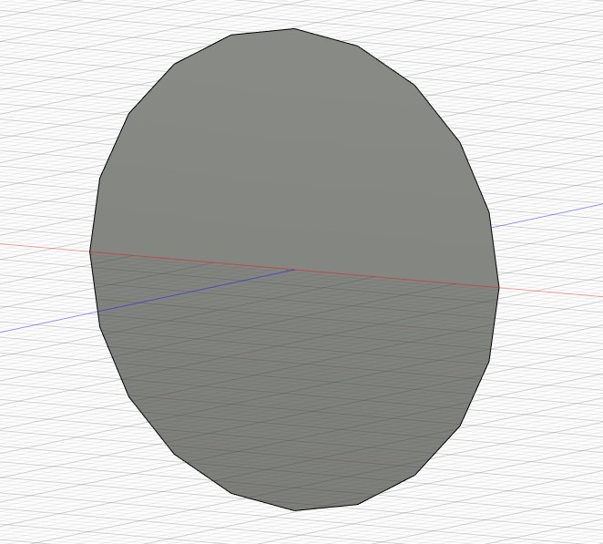

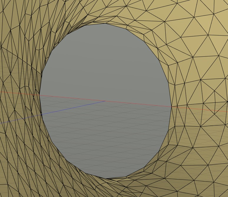

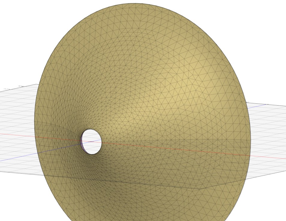

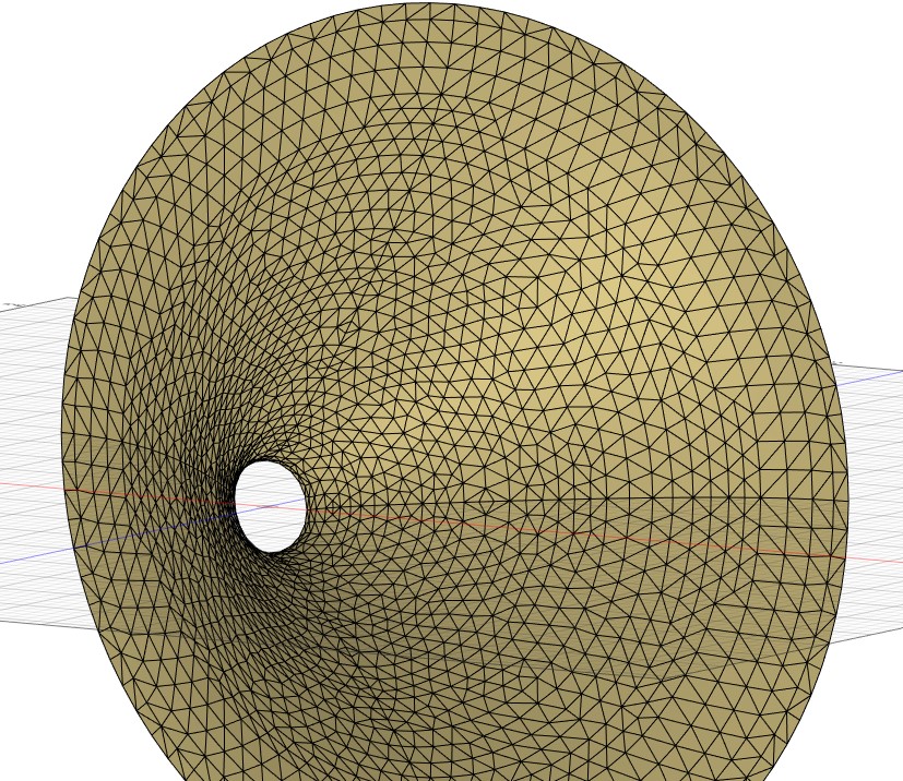

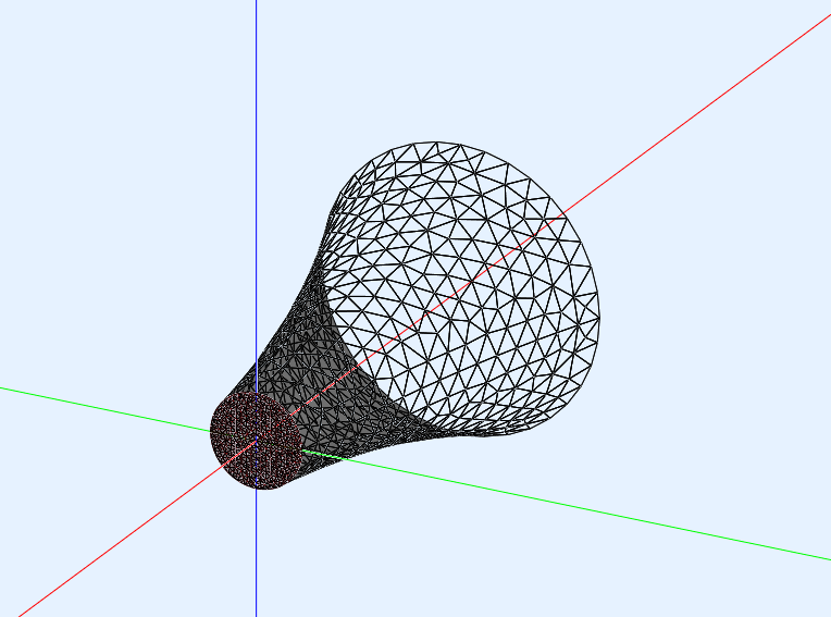

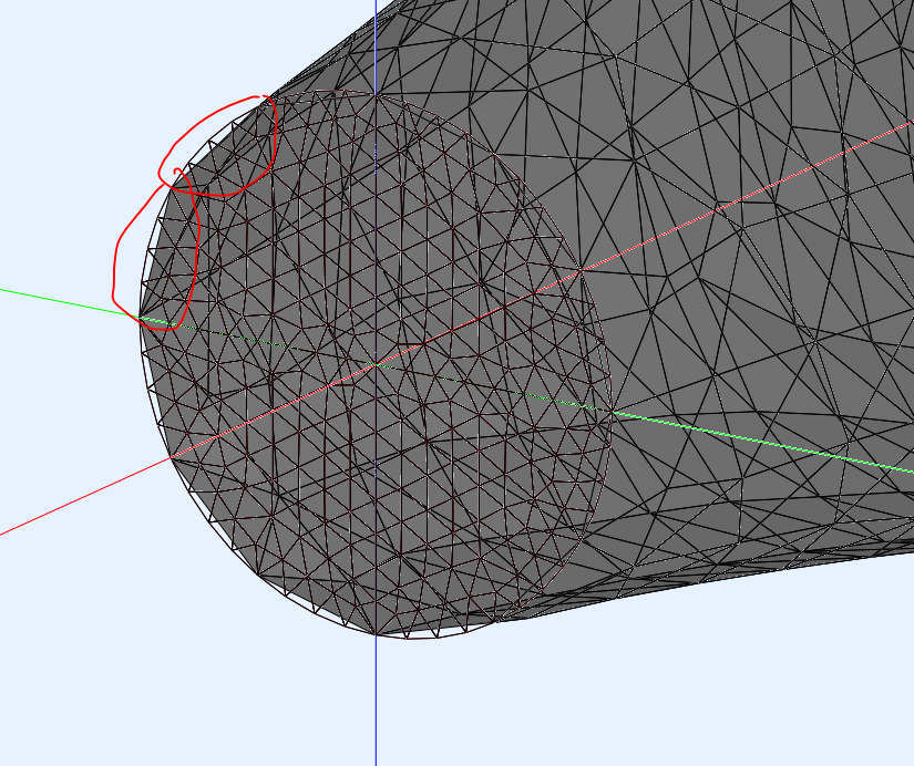

holes in BEM mesh
Hi Docali, I was reading through your article "BEM simulation for freestanding horns". You mentioned to use different mesh sizes for the different components. But how do you prevent holes in the model if 2 adjacent elements have different mesh sizes? In the next image I try to illustrate the issue. You can see the driver (fine mesh) and the inner horn (coarser mesh). When I zoom in you can see the holes in the model where driver and inner horn are connected (marked in red). edit: I have meshed driver and inner horn in gmsh separately.
Hi Megaet,
the article you reference to was written by DonVK. He is a member of this forum and you may contact him here.
But in his article DrBA Calculator and BEM Simulation – Sphericalhorns he mentioned the following:
"A new flat disc driver membrane was created in FreeCad [6] that exactly matched the throat mesh."
HTH,
Bernd
HTH,
Bernd
I think Don does it by drawing a polyline manually to match at the vertices.
If you have Fusion 360 or a similar CAD package you can create a surface patch over the open end of the horn mesh and export that to stl and mesh it in gmsh at a higher resolution.
I export the mesh as an stl from ABEC in the Options menu (need to solve the mesh first) insert that into Fusion (changing the units to Metres because ABEC uses metres as the file unit).
Convert the mesh to a Brep surface. Fusion needs to be in direct modelling to do this so right click on Document settings in the tree and select do not capture design history. Then in the solid model tab right click on the mesh body and choose mesh to brep command.
Then go to surface tab and create a patch click in the open end of the waveguide until the profile is highlighted and you will get a surface that matches.
Turn everything else off and export to stl. Depending on which side you created the patch from may mean that you have to swap the normals in ABEC to have the diaphragm pointing the right way.
