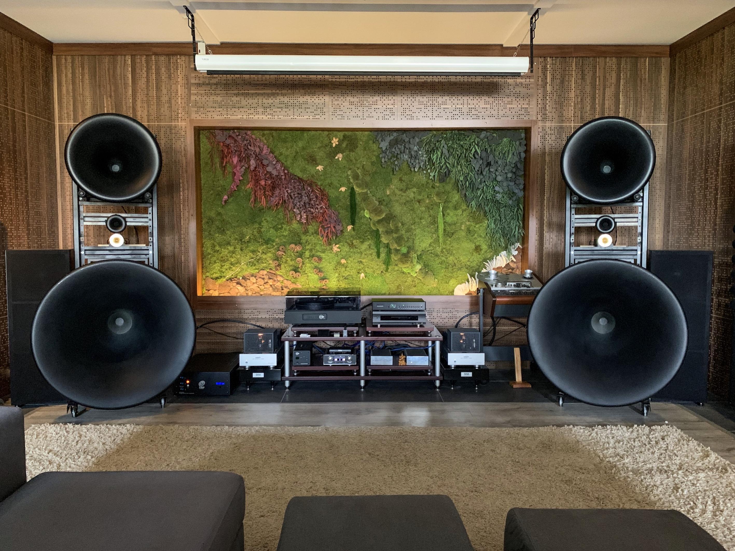

I am very interested in your spreadsheet. I would really like to see a midbass horn with 80hz cutoff, ellipsoid and has rollback. I would like to see it with different throats like 8" throat and a woofer behind it or with a 3/4" compression driver that can play down to 80hz like some we555 replicas.
I have a tractrix 110hz cutoff horn as midbass. If it was ellipsoid I could have gained on horizontal length and the rest of the channels would have been closer.
Think of my system (attached below) with your spherical/ellipsoids rather than my tractrix and jmlc combo, it would be much shorter with drivers closer together. It would have also wider coverage... I would like to build even if it is just to hear the difference.
Hi!
Your system looks fantastic! I assume that it provides a natural sound character with respect to the horns. The sweet spot might not be as pronounced as in my system but integrating a SHT is a difficult thing...

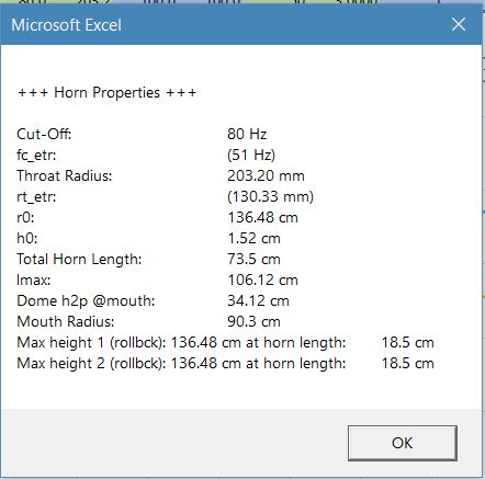

Thank you very much. I have checked with an online ply viewer, it looks intriguing 🙂 What are the dimensions. The depth of the horn, the mouth dimensions...
Sorry, 80Hz gives a huge horn! You are in the cinema league here:
The stretching leads to 100/54 cm diameter. 80 Hz should be completely out of scope. As the SWH has generally a smooth fall-off to lower frequencies one could go a little higher like 120 Hz and use a classical quadratic form as this has a larger surface and only about 108 cm diameter.
View attachment drba_swh_120_se800.zip
That is smaller than my 110hz cutoff tractrix horn with rollback which has about 105cm mouth. Am I getting something wrong here? I can have a wider horn as long as it is shorter and goes lower.
SWH has a larger mouth than tractrix. My numbers are radius and yours should be diameter. The 80Hz SWH round has about 180cm diameter.
