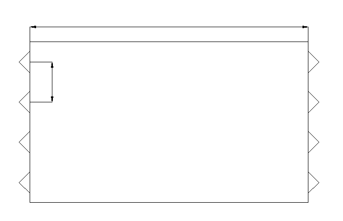

There has been a misunderstanding. When StigErik said the rear wall array has to play in reverse phase, it also has to be delayed from the front wall.
The mention of the distance between speakers is a different issue, referring to the close spacing of the speakers on each single wall, which affects the upper frequency limit of the array.
Yes, the DBA appears to be a specific subset of the multi-sub approach. The way that it is normally done is like comparing a Rubik's Cube both finished and mixed up, but in both cases it is a complete unit.of what Toole and Geddes are advocating.
Thanks AllenB. Also see posts #3 and #9.
So DSP removes the room length.
Bit more drivers won’t push frequency up, d dhould be the centre-to-centre of the furthest apart drivers.
dave
Yes. The delay due to the room length distance is distinct from the array driver spacing distance. Driver spacing limits the ability to produce a room width plane wave at higher frequencies.more drivers won’t push frequency up, d dhould be the centre-to-centre of the furthest apart drivers.

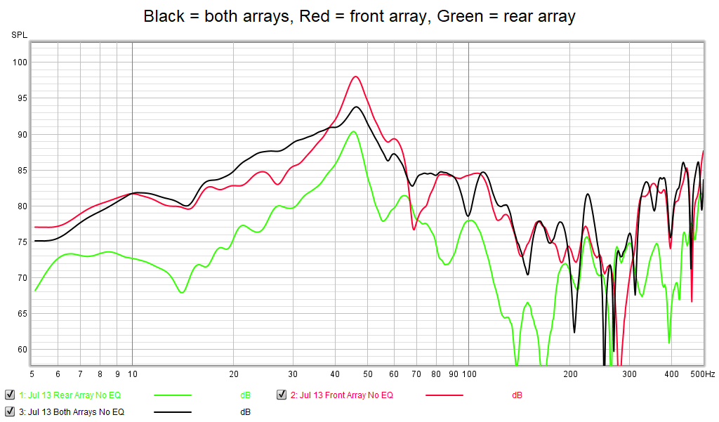

Here's a few more measurements. I just discovered that there were errors on previous measurements I've shown, so please disregard those.
These are done without any EQ what so ever, but with the correct delay and level on the rear array. No smoothing.
The theoretical upper frequency limit of my DBA is 136 Hz, determined by the speaker to speaker distance in the horizontal plane. And as you can see on the measurements above, the frequency response really goes wild above the upper limit, with large and narrow peaks and dips. Below, the response is a lot smoother.
No it should be frequency independent as the 'anti' bass is played with the exact delay of sound traveling from one side to the other.So it only works at frequencies where the spearation of the walls is less than the quarter wavelength?
dave
At some higher frequency it will not work anymore if the spacing between the subs is to large for wavelength played
