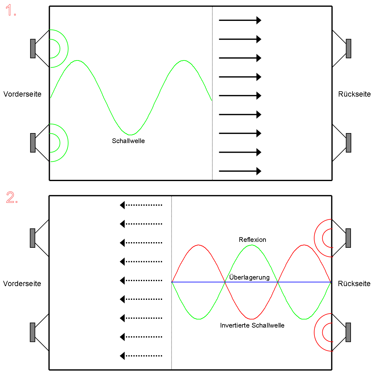

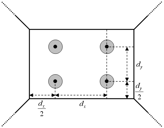

To create a DBA we must set up an array of at least four loudspeakers on the front wall, and a similar one on the rear wall. The rear array must play in reverse phase to actively absorb the plane wave from the front wall.
A simple way to understand what a DBA does can be described like this:

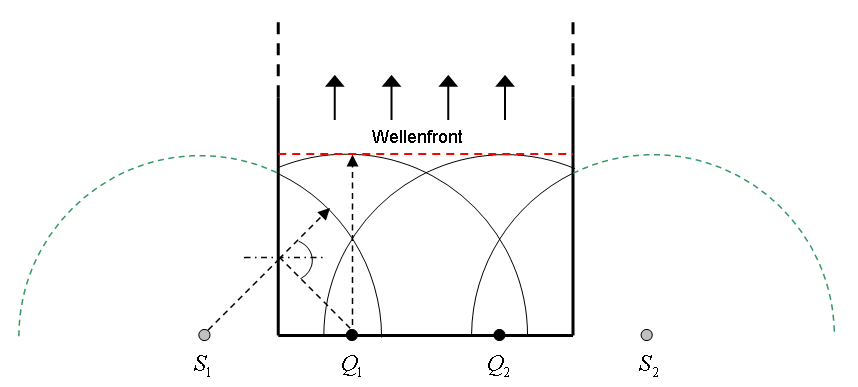

- The front array creates a plane wave which should cancel standing waves in the height- and width plane of the room (up to a certain frequency)
- The rear array shall actively absorb standing waves in the longitudinal plane

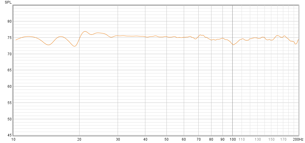

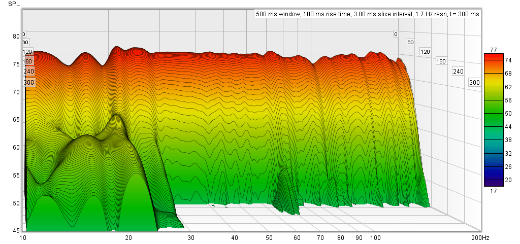

The result of this is that no standing waves should be exited, and you get a frequency response that is completely flat, and a decay without resonances. In theory at least. With some tweaking, it's possible in practice as well.
There are requirements and limitations of course:

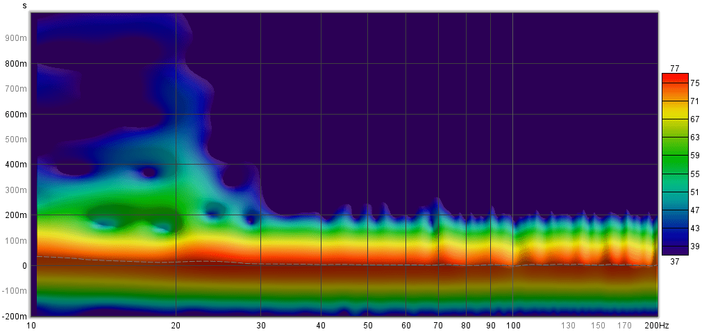

My own room doesn't meet any of these requirements. Even so, I was able to create this result with a lot of tweaking. The decay is very short down to about 30 Hz, where the neighboring room starts to contribute to the decay we see on the measurements here.

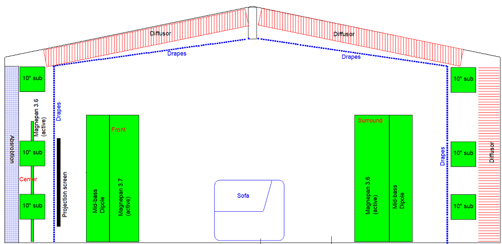

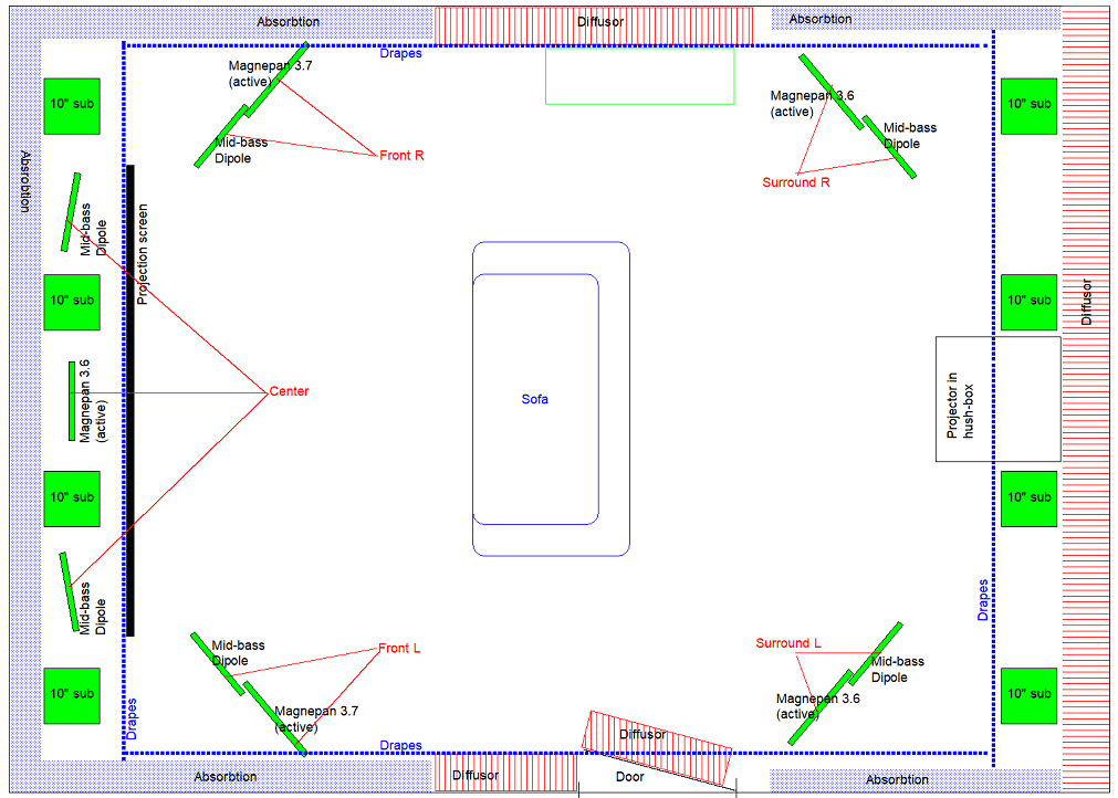

Here's my room layout. As you can see, the room is rectangular, but the ceiling is not flat. I also have a lot of acoustic tuning and large dipole panel speakers in the room.

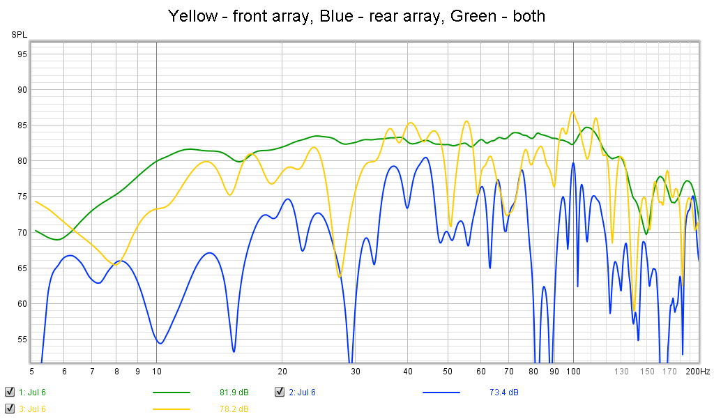

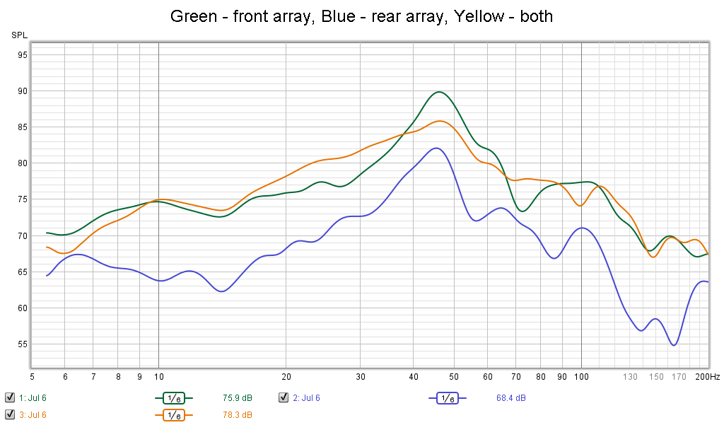

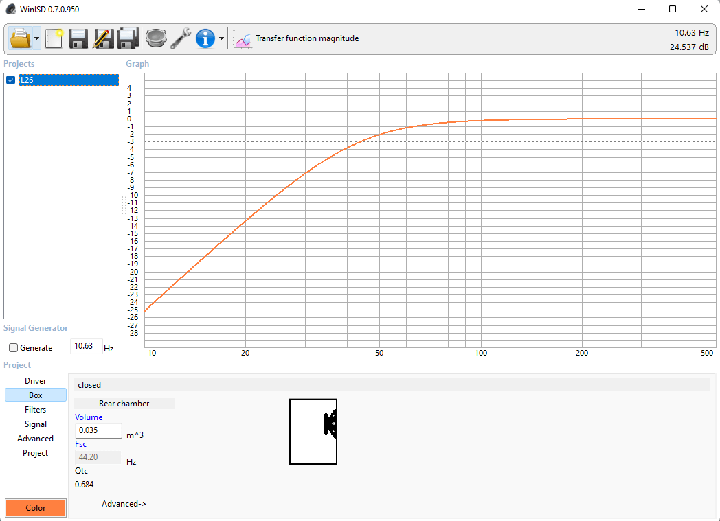

As you probably can see from the room layout drawings above, I have twelve subwoofers in each array. They are SEAS L26ROY in small closed boxes, about 35 liters each. This gives us this response:
Since the subwoofers are placed close to the front and rear walls there is a lot of room gain, so the resulting response do look a lot different. I will show some measurements a bit later.

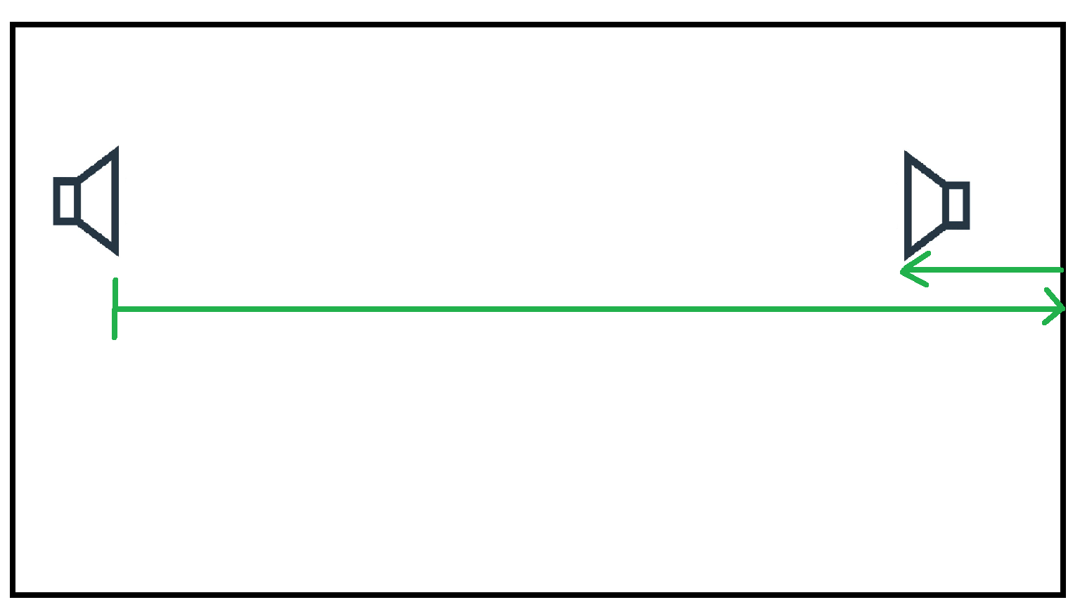

The first thing we need to do when configuring the DSP, is to set the correct level and delay for the rear array. This can be a bit tricky, and may require some adjustment under the way. A good rule of thumb is to set the delay equal to the path distance between the front array and rear, including the reflection off the rear wall. Like so:
In my case, I set it to 21.5 ms, which is equal to 7.18 meters. My room is 7 meters long.
The level must also be experimented with, but if you calculate the SPL loss for your distance, you won't be far off. I ended up with -7 dB on the rear array.
Also, the rear array must have the phase inverted. This can be done in the DSP or simply by switching + and - on the speaker terminals.

Wow! So if I count right that's 24 subs? (each sub position in the top view has 3 subs on different heights?)Placing your listening position in the middle of the room is usually a bad idea. This is where you will get the worst bass response. With a DBA however, it does not matter. In fact, the middle of the room may be the best location.
I assume you run bass in mono?
