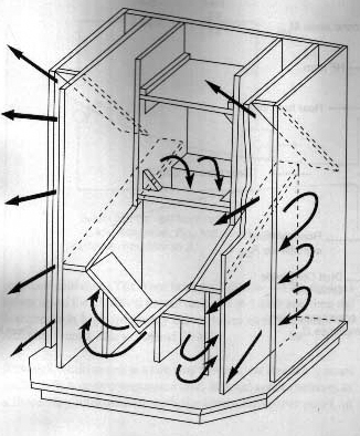

Speaking of visuals...
I too have looked at lots of horn designs, and this seems to me to be very "buildable".
It is really a box within a box within a box -- the outer two being flare extenders -- the inner being a pretty standard folded back horn.
Its sound is legendary and is allegedly down only 6db at 18hz

Hi Qi,
is that a tannoy westminster you posted?
If so then I think the -6db is much higher than 18Hz.
The flare rate (don't know the symbol) is quoted as 0.9 from memory and this translates to about 30Hz - 35Hz. The horn length is truncated to about 12feet(3.5m) with the result that the mouth area is only about 5sqft (0.4sqm). It is intended for away from boundary location and so only gets floor loading rather than back wall or corner loading.
And yet I have seen it said that it sounds superb particularly the IMPACT of bass and it has no delay on mid and treble. Just a phase reversal to eliminate the crossover suckout.
Hi Andrew
Thank you for your post.
You are correct.
I agree -6db @ 18hz figure is "aggressive". It is from their website.
Some say it is an expanding pipe, not a "real" horn. Could that be it?
If a four-stack of labhorns will "only" get down to the mid-twenties (Tom Danley's own words), then something else is at work here for that figure to be true (heavy corner loading?).
All I know is...
I have heard it and loved it (there was a hint of colouration where the back horn acoustically crosses to the front horn -- a slight "hollowness").
It is a mature, proven design (Guy R. Fountaine is a legend, as you know)
It is smaller than a labhorn stack (it is approx 5' x 3' x 2')
Only one driver is required
The driver T/S parameters are well known (i. e., a less pricey substitute driver could be found as an option)
Built properly they are visually stunning (if you like "traditional")

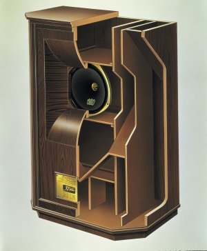

The westminster is a totally different animal from a labhorn.
W is a full range hi quality domestic loudspeaker that will fill very large rooms (in fact it needs a large room to perform properly). L is a PA bass only (28Hz to 80Hz) designed for enormous power and when stacked can drive a large outdoor crowd to ecstacy (the legal kind).
W is a true horn in the triple sense:- Treble horn using the paper cone as a flare down to 1kHz, mid horn using the ply front wings from 300Hz to 1000Hz and back loaded horn from 30ishHz upto 300Hz.
There is no trickery involved just a carefully chosen set of compromises that give an overall performance that would be difficult to achieve in a smaller box with only 100W of drive.

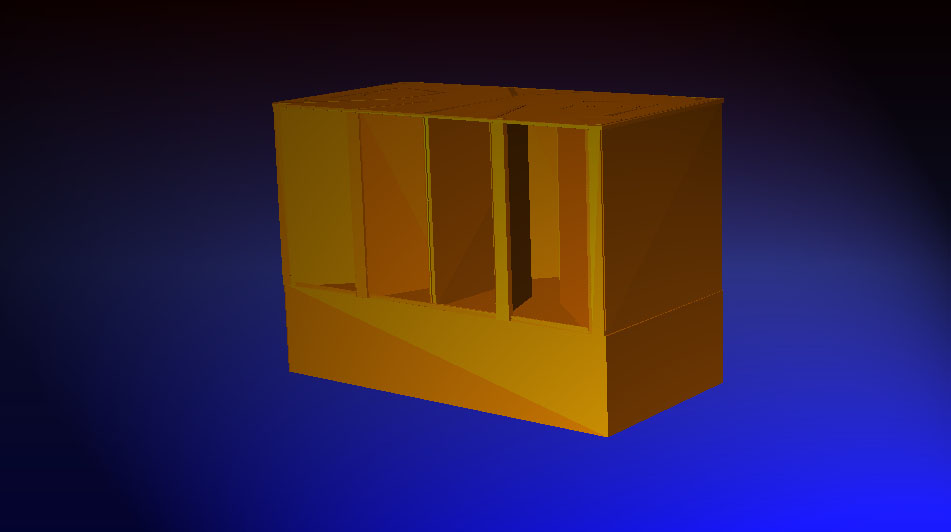

Labhorn vs Westminster
depends on what you are trying to achieve.
The Westminster is compromised even though overall it performs well and in a few respects very well cf. a vented cabinet.
The advantage of the labhorn is that it will go down lower if you extend the mouth or stack them. The larger mouth and similar flare rate will have reduced the ripple compared to the Westminster. When driven with low power they should have lower distortion and have the potential to easily handle peaks. They also save driving the main speakers with low bass allowing the mid/bass to perform better.
For a low bass speaker you can improve on both designs choosing the compromises that suit best your circumstances but anything deeper WILL require a bigger box/mouth and lower flare rate. What those two designs show is that some deep bass can be achieved even with ripple and drooping response with seriously curtailed length and reduced mouth size.
AndrewT
But at what additional cost and effort?
For example, here is an outstanding example of DIY craftsmanship -- design concept, build quality, testing methodology, documentation, etc.)...
http://www.geocities.com/hulkss
It utilizes two LABHORNs with mouth extension.
According to the extensive testing on the web page it has an F3 of 30hz, and an F10 of 20hz in room (and it is HUGE).
I personally would still go with a DIY Westminster...
Using one driver not two. it is cheaper, smaller, better looking (IMO), and with greater bass extension (unless you are saying TANNOY is misstating its numbers of -6db @ 18hz)
I also find it interesting that Tom Danley's new "hot creation" is his TOWER OF POWER -- an 18" x 18" x 84" "tapped horn" tower (looks suspiciously like a TLINE to me, but WTFDIK)
If I were going the two LABHORN route I would modify the throat to accept one driver only, and vent the driver to a triple fold TLINE for the bottom octave (15hz tuning) -- OR, since it is the bottom-most octave (where the ear is most forgiving), a simple EBS should work just fine.
Artist concept (work in progress) ...
I don't doubt your choice of the Westminster over a multi box and multi amp array. Particularly since you would be buying a professionally designed and tested speaker system that is guaranteed to meet specification and sound good to boot.
I fell in love with the Westminster the first time I read about it and saw the pics. But at what a cost. I just could not contemplate it then nor now. The last time I saw a price quoted it was over £13,000.00 per pair. How many labhorns and amps could you buy for that?
I will have to settle for much less but having had Tannoy Berkleys for nearly 30years and got used to the easy power delivery (although missing extreme low end extension). I do look forward to building and developing my proposed sub-bass horn using Tannoy drivers (all hidden in and dominating the loft)
However I digress, the main point I am trying to make is that it seems possible to make compromises in the design and implimentation of horns and still end up with adequate or somethings excellent performance. These compromises should be extendable to lower frequencies to allow true 20Hz or sub-bass performance to be achieved if we can get the balance right.
This thread and a similar one running concurrently may help achieve that balance.
BTW I looked at hulkss some time ago (a previous web page) and thought he had gone to a lot of work to lose both back wall and corner loading and still achieve a tiny increase in mouth size.
AndrewT
Stated eloquently.
My quest, however, is to reverse-engineer and DIY build the Westminster
It has been done before (by MR GREEN of Bangladesh, a fine gentleman I am told).
It can be done again.
Also, I have read (source: MAGNETAR and others) that ideally the front horn should REALLY start as low as 80hz, not 200hz -- for articulation and detail.
This is one of the first tweaks I would look into (assuming the -6db @ 18hz is "real")...
