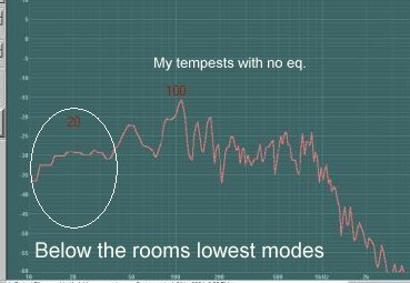

Are you saying My 3 tempests at the moment will not go deep ? I get an easy measured 105dB @ 15Hz at listening position and on an RTA it measures flat to 10Hz. Didn't test lower / louder as my room was protesting 😀 Not sure what the room size has to do with bass output ?

Delaying the mains is a good tactic for time aligning the main system with the horn subs, but you just added another set of components into the signal path of your mains with the resulting loss in tranparency. There is no free lunch.
I am sure that your existing tempests would do very fine to get down low at high output, especially below the cutoff of the horns. My comment was that you will start to run out of room (physically) with both the horns and the monopoles along with your main speakes and electronics, and you could save space by making the monopoles into some sort of chair or couch.😉
With this setup, you will clearly have outstanding bass with the capability for huge output. It would be impressive for that small space.

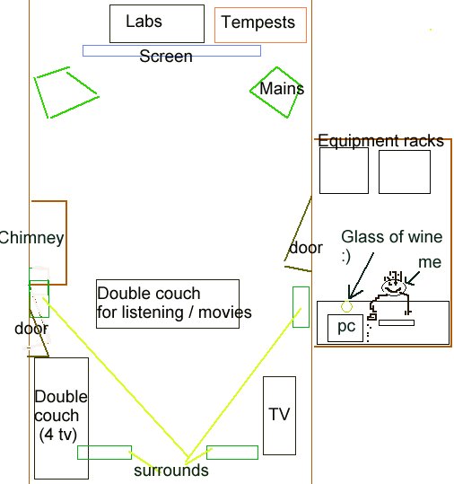

Re: the extra set of components. The digital xo will be there to cross from the labs to the subs anyway. It happens to be
the way I xo my main speakers aswell, so I've already got that 'resulting loss of transparency' in the chain. Using the delay will not add to the loss.. and I'm pretty sure that a digital xo will give analogue active filters that can do the xo, eq and delay that I need a fair run for the money.
I am happy with the dcx, warts and all.....
Re: space. The labs need to be 29" from the side wall which leaves a space 22" x46" x 8' for the tempests (may need to build a new enclosure for 1 of them though🙁 )
The screen goes in front of the labs/tempests, with the mains in front of the screen.
Rob
A silly pic of my room.(with planned subs)

Hi
I do those kinds of pics ,too...
They're great for planning and thinkin things out
Smart move to put the equipment in the other room.
cheers 😉

Well at least your smiling Rob.🙂 Thats a good sign.
