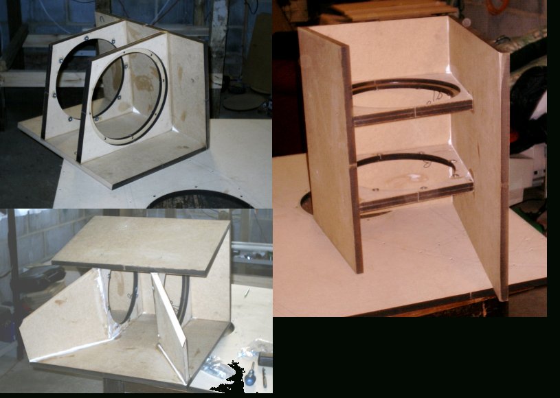

Just finished cutting all the parts for my labhorns. Am starting assembly Monday.

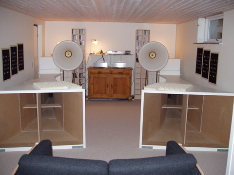

seems there are a few people nutty/dedicated enough to consider this "path" to sound reproduction in a domestic setting
its on Bert's site under the "showroom" side tab:
http://www.diy-systems.com/
Hi Scott
Thanks soi much for the link. Some really nice systems there.
Good candidate for the LABHORNs also.
AVANTGARDEs fir the DIYer -- great idea.
So many beautiful designs ... so little time...

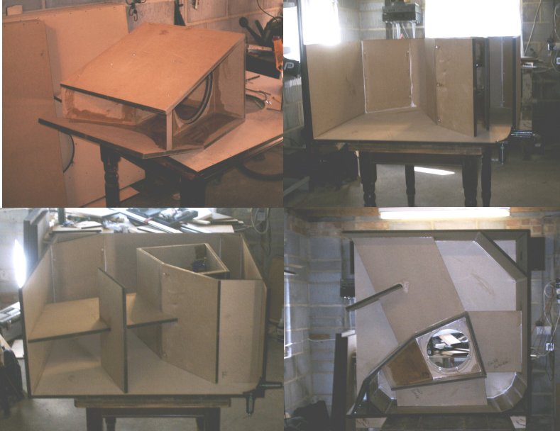

Only had a problem with 1 piece (the very last piece I fitted - typical!)- I made the top brace fit a bit tight and it shifted the last nose flare panel a bit. Will be correcting with belt sander and sealing all joints with resin tomorrow.
Hopefully no.2 will go very easily now I know how they go together properly.

Mark, the sawdust isn't the problem - it's paying out for the drivers that hurts me 🙁 😀 😀
Rob.
I have but one question
Is that a brown burn mark that I see along the edges of the MDF?
If that is the case then you probably have a blunt blade or a fence askew, or both.

RobWells said:Laser cut😉 All mitred edges done on a circ.
Rob.
Nice going, Rob!
Do tell all...
What is the incremental cost for Laser Cut?
Can you give details on "done on a circ." ?
