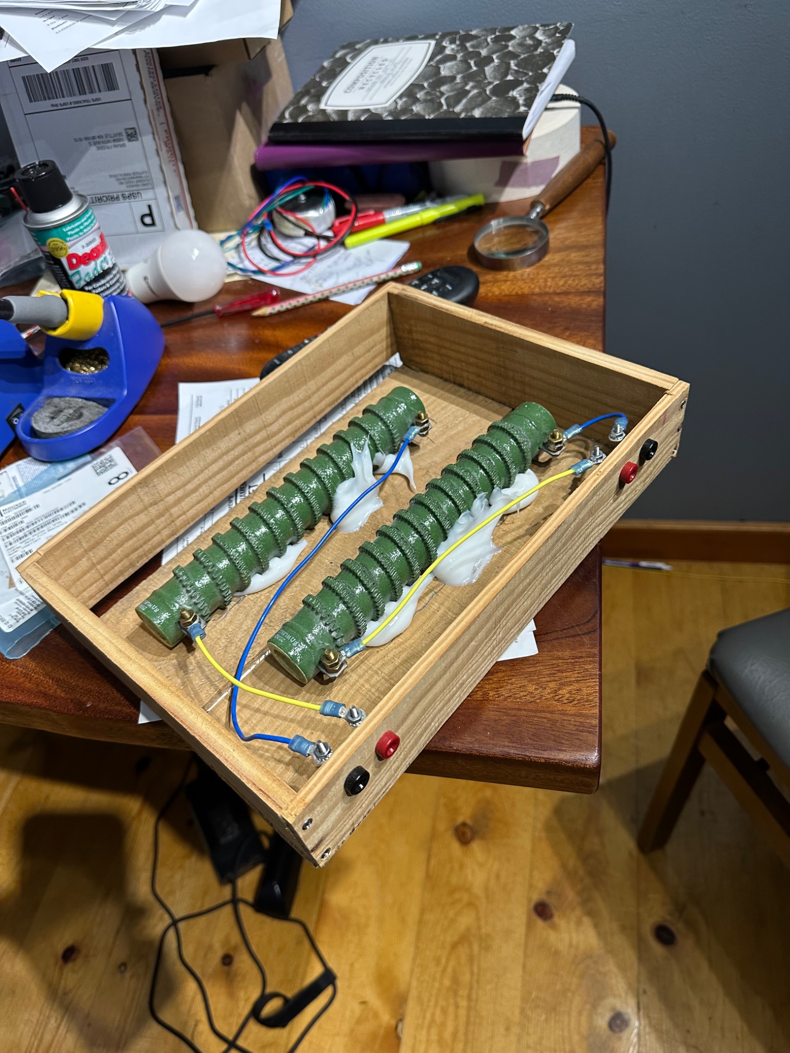

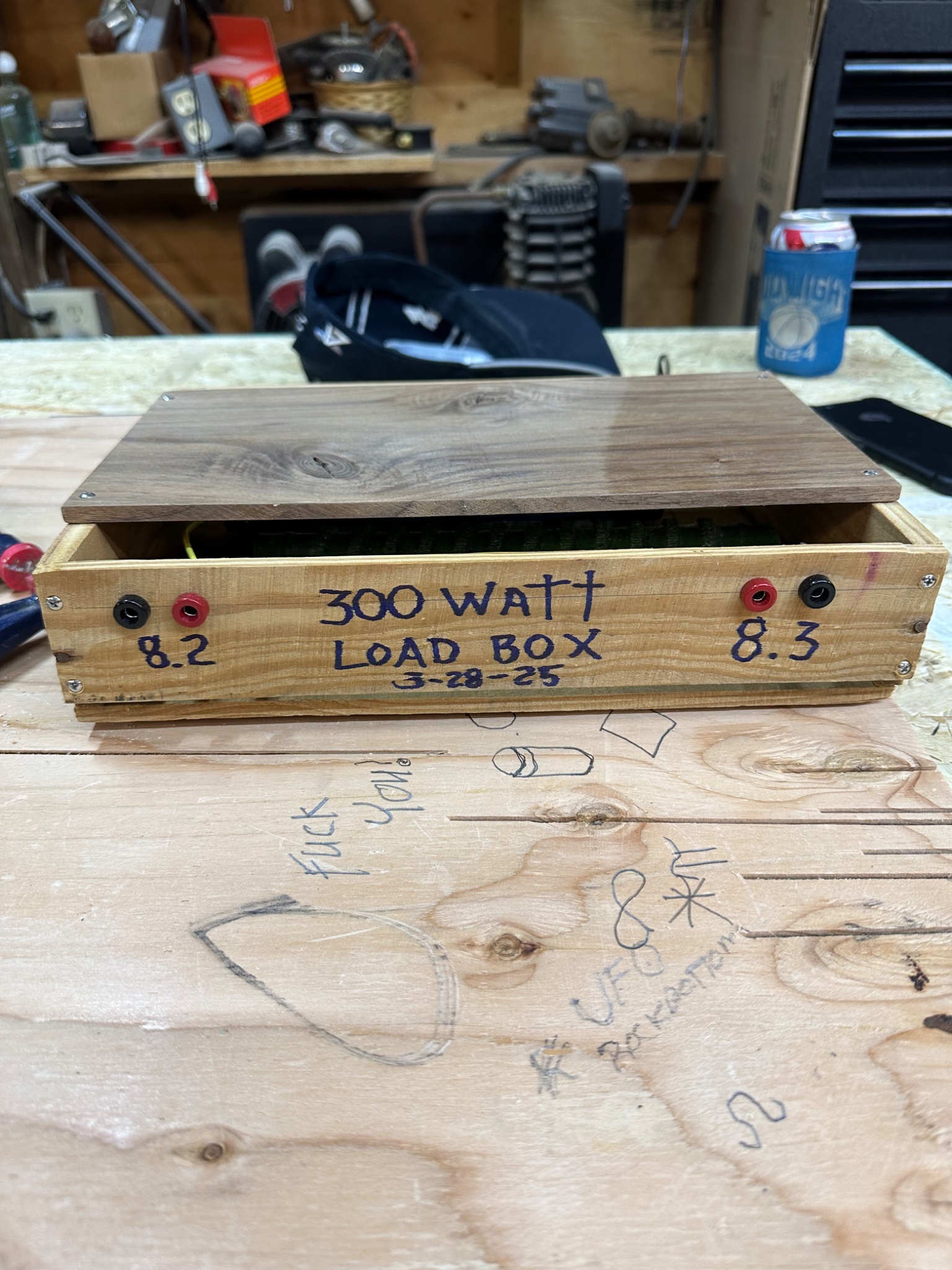

For comparability's sake I use a resistor as load. For a functional test the reactive load makes a lot of sense. For that I use a cheap 4" driver with huge parts of the cone removed. The remaining paper is stiffened up with epoxy. There still is sound, but way less then with an intact speaker.
Speaking of getting loaded!
