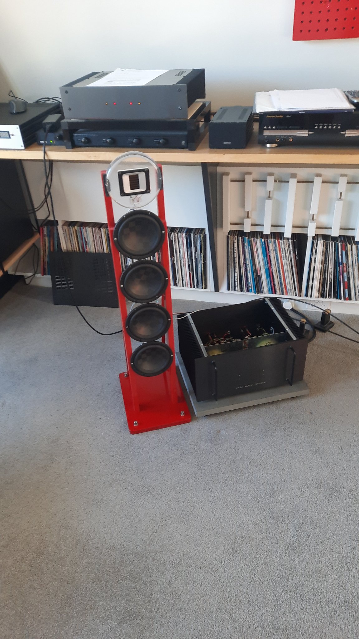

Why did you get rid of them? What are you driving now?
So my new spkrs are 'zero baffle':
- 4x SB Acoustics 6 1/2" Textreme mid/bass drivers
- and the SB Acoustics ribbon tweeter.
I posted a pic earlier but here it is again:

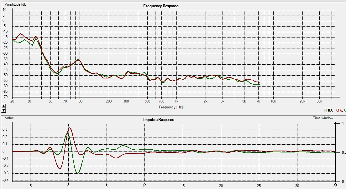

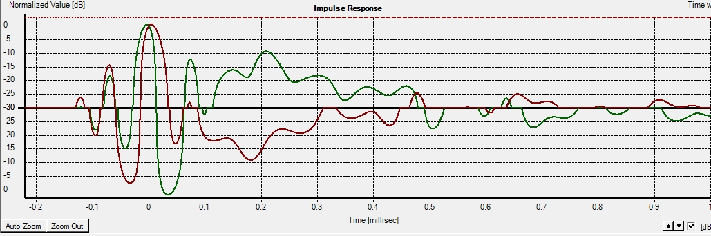

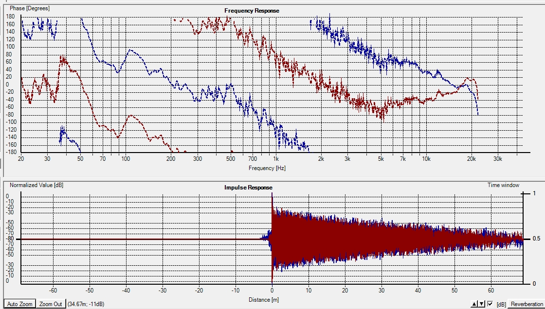

It seems the phase delay of the tube amp replaces the phase at the proper place...., such a weird thing to see,
This simply looks like the green amp is inverted and delayed. Try the measurement with reversed polarity. No idea what's the delay component - different mic position, not the same measurement session?
Had a 2nd look at the phase - it is 180° different (e.g. 200Hz). So it's pretty sure one of the amps is wrong in polarity!it does looks like the polarity is reversed.
But there still seems to be a delay ... can you repeat these measurements, at least with one amp with switched polarity so we can have a closer look about the delay issue?
