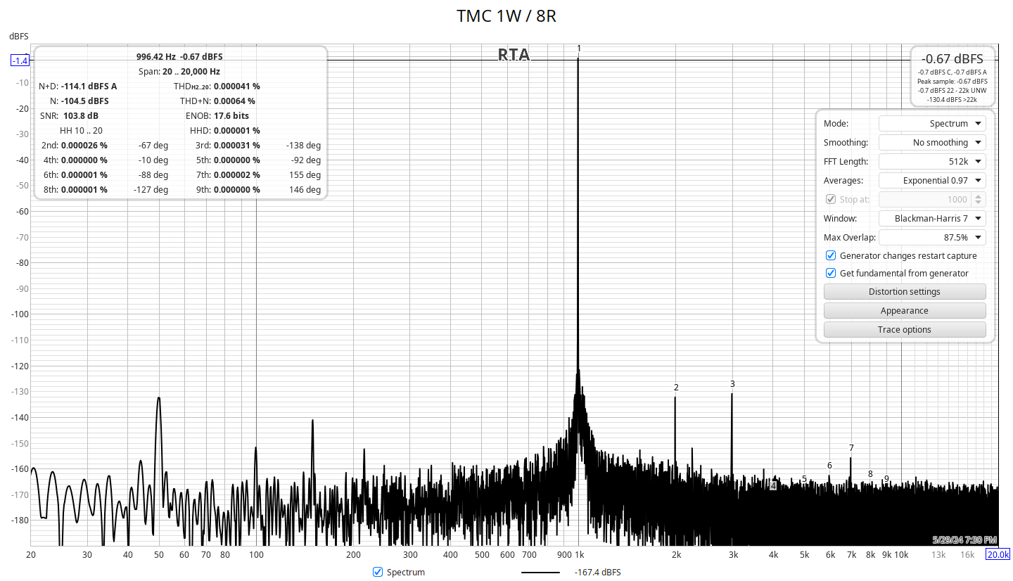

The image in post #251 shows 3rd harmonic in what I would call "compressive" phase.
Yes, about to post that.... I kept counting peaks... also it shows a phase shift....

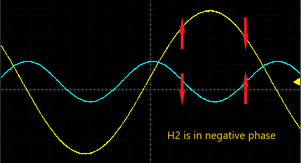

About H2. Assuming no phase shift.... the negative H2 will slow down the rise time of the leading edge of the fundamental. Will this be measured as a temporary low pass filter? For a particular fundamental frequency. How will this affect a wide bandwidth... say across the audio spectrum.
Has anyone ever taking the effects of H2P and H2N and H3 upon the fundamental and then calculated -over time- the filtering action? In some cases this might be like tuning down the treble, and other turning it up... like riding the treble control.
Is is a frequency based distortion, but when analyze its effect over time ( dV/dt ) then it becomes a time based distortion. What kind of graph would we use? A waterfall?

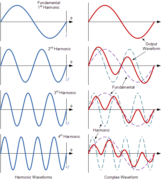

Here's an example of what harmonics do the fundamental... unfortunately it's only positive harmonics, but you get the idea of how the fundamental gets modulated... Note how the 3rd harmonic makes the fundamental look like a square wave!
Of course, no one with a straight face would design an amp with harmonics of the same amplitude as the fundamental.... unless you are creating a square wave generator.... but you can get the idea...
https://www.electronics-tutorials.ws/accircuits/harmonics.html

Image is distortion residual combining all distortion separated from the fundamental. Looks like mix of H3 + H2, producing uneven summed distortion waveform peaks.
This is how pure H2 in negative phase would look.

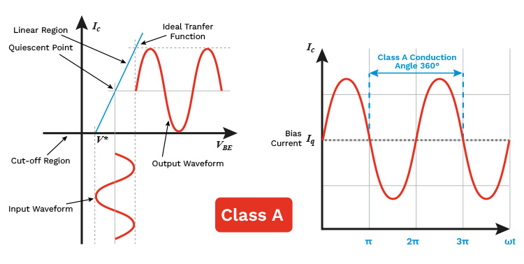

I would think so. To understand things better its very helpful to know what a "transfer function" is. It may also be helpful to know that talking about one frequency at a time, at one particular level, giving one particular distortion profile is really only valid when only one frequency is present. So why do we perform distortion analysis that way? Because that way its possible for human mind to make sense out of a spectral display. OTOH, if there are too many frequencies at once, the spectral display can become in indecipherable messy jumble of spectral lines.Doesn't that mess with the everything?
In a better/closer-to-realistic model than above, there is assumed to be a slightly curved transfer function that produces distortion. The curvature can change with frequency, but rather than think of curvature change in terms of frequency (in the frequency domain view) we can think of the curvature (as viewed in the time domain) as a function of the rate of change of voltage (there is a relationship between the two views in that higher frequencies have a higher rate of change in time, but combinations of multiple frequencies added together can have even higher rates of change with respect to time).
The latter paragraph kind of gets more toward the way of thinking about and modeling distortion which was proposed by Earl Geddes.

EDIT: Some info on transfer functions at: https://ccrma.stanford.edu/~dtyeh/papers/yeh07_dafx_distortion.pdf This includes some graphical representations to help develop some intuition. Graphically is also a way we used plot approximate distortion waveforms for things like tube circuits.
Here is a graphic showing a linear transfer function graphically:
