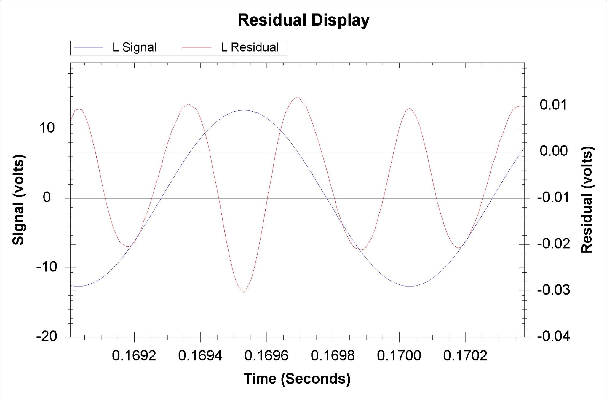

I've always thought this to be the case, and I've fiddled with it using the H2 generator.If amplifier distortion is relatively high ( 0.1% or so) second harmonic with -90° phase to the fundamental is known to make virtual sound source perceived as further away and +90° as more forward ‘in your face’ impression.
The phase of an even component HD with relation to perceived imaging being "front or back" has always made sense to me, but when things seem so simple, my understanding is usually wrong. But ... here goes nothin' to see if my understanding of "why" in the most basic terms is aligned with reality.
If the (let's say) 2nd harmonic is "positive" (in the vernacular being used commonly around the forum), then the distortion product (voltage) is 'added' to the fundamental at their relative peak voltages. Edited to add - I haven't done the math to see if the "overall net" across the entire waveform is higher or lower. Thus... that frequency would be very slightly louder. Thus bringing it forward in the image.
If it is "negative" then the distortion product is 'subtracted' from the fundamental and the resulting voltage is slightly lower...
If an amplifier has a consistent distortion behavior across the frequency range and within the power band used to play the music... then the "imaging" or placement of instruments / voices / room effects may likely be more consistent / less "muddy" perhaps.
If an amplifier varies the distortion characteristics (and many many that I have measured do vary) both across the frequency spectrum and within the power band ... then the soundstage can perhaps be more "muddy" or less defined.
If there is little to no meaningful distortion, then one could likely assume that the soundstage from the recording may be more "accurate". Is it more pleasing... who knows?
Since we know how our ears / brains detect spatial placement (see below) ... it seems plausible, but I'm not willing to conduct a definitive study.
"It includes differences in the precise time at which the sound reaches each ear (interaural time difference, ITD) and the intensity of the sound reaching each ear (interaural level difference, ILD). The ITDs are more effective for localizing low frequencies (lower than 1500 Hz), and the ILDs are more effective for localizing high frequencies (higher than 1500 Hz). Frequencies in the range of 2000–4000 Hz are poorly localized. In addition, spectral changes that occur when the sound encounters body parts, such as the torso, head, and pinnae, also provide information on the location of the sound source".
Excerpt from - Measuring “Where”: A Comparative Analysis of Methods Measuring Spatial Perception - Fostick and Fink
Edited to add one example of a "negative phase 2nd". I can't seem to quickly find an example of "positive phase 2nd" from my measurements.
Attached picture is the correct example of what is called ‘negative phase H2’. I’m not sure if effect on virtual source perception is created only by H2 affecting amplitude or by something else.
We may notice that ‘negative phase H2’ is suppressing rising edge of the fundamental while boosting the falling edge and flattening the top. With distortion being 0.1 – 1%, amplitude deformation is 1/100 to 1/1000 part.
