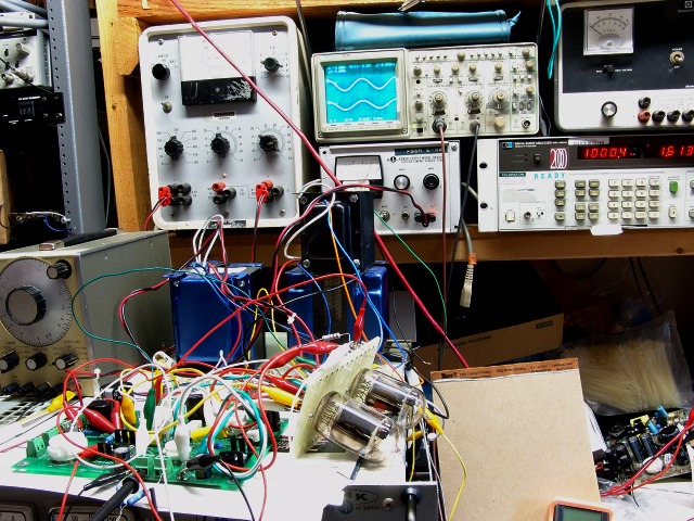

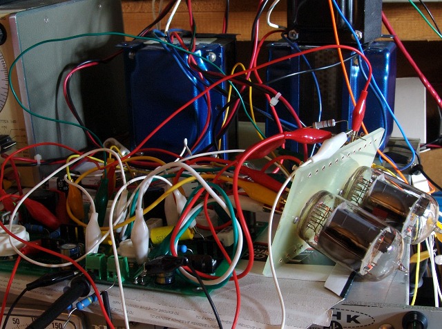

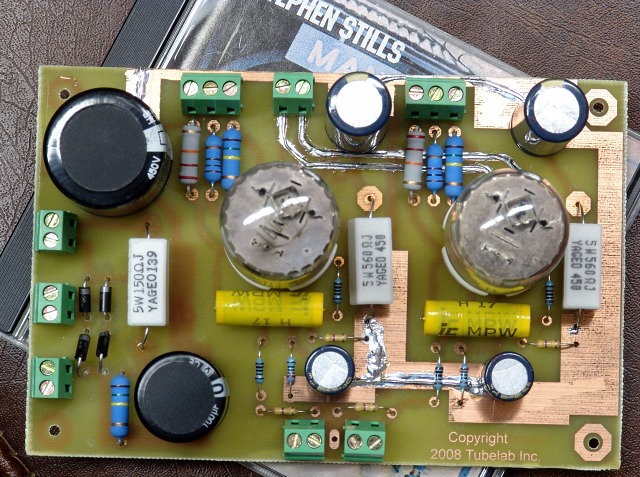

In a really DUMM, but surprising one hour experiment, I took a working Tubelab SSE board, removed the driver (12AT7) and output (6V6GT) tubes and wired in a compactron triode - pentode tube (6LR8) with cheap Radio Shack clip leads. This should have been a full on TV and radio jammer when powered up, but much to my surprise it not only worked, it worked good. I used the RF spectrum analyzer "sniffer," an OTA TV set, and an AM radio tuned to a weak station, all in proximity of the "furball" during testing and never detected any hint of oscillation as I messed with the amp while it was operational, tweaking component values, again with clip leads.
Once operational, listened to it for a while, then powered off and traced out a schematic for what I had created and laid out a PC board for it. It also worked on the first power up. This messy "furball" of wires rivals some of the thumbtack and tube sockets screwed to a pine board projects I made as a kid. I don't think it's possible to make a messier amp design.

The biggest problem with the furball is it’s a very tempting target for the furball (cat). Then it becomes a fireball, with possible collateral damage to the cat.

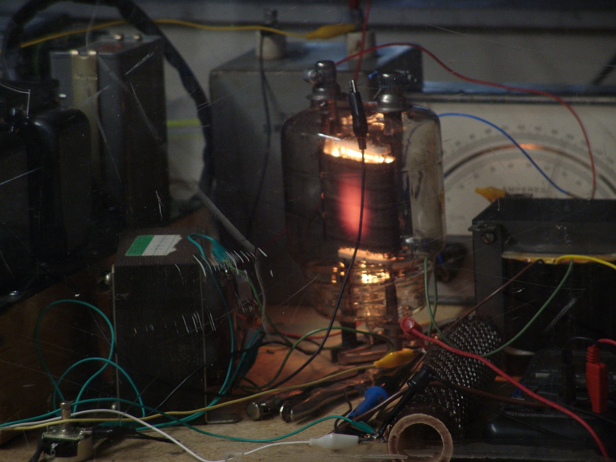

I built a cathode follower from one of the other (not 6HV5A) similar beam regulator triodes and tested it with a HP204C audio oscillator and a 600 ohm OPT being used only as a choke in the cathode. I got all sorts of squirrelyness and weird sounds when I connected it to a speaker which was wired directly across the OPT primary. I replaced the audio oscillator with the headphone output of a Sony Discman and got quietness. Cranking the Discman to full output brought sound, clean undistorted sound with loose flabby bass. Power output was probably in the milliwatts and the tube needed a lot of B+. I don't remember how much, but likely way over 500 volts. I had 1 KV and a 2 KV power supplies back then. Attempting to use the OPT in the plate circuit in "normal" OPT configuration created a full on TV and radio jammer, probably due to the point to point construction with flying leads. No clip leads though, and very few parts just a grid resistor and blocking cap at the input. A 3K ohm Transcendar OPT did the same.
This is one group of tubes that I have yet to tame. Nobody has bought any of them in 10 years of taking them to hamfests and I have a good size box full, collected one at a time over maybe 40 years.

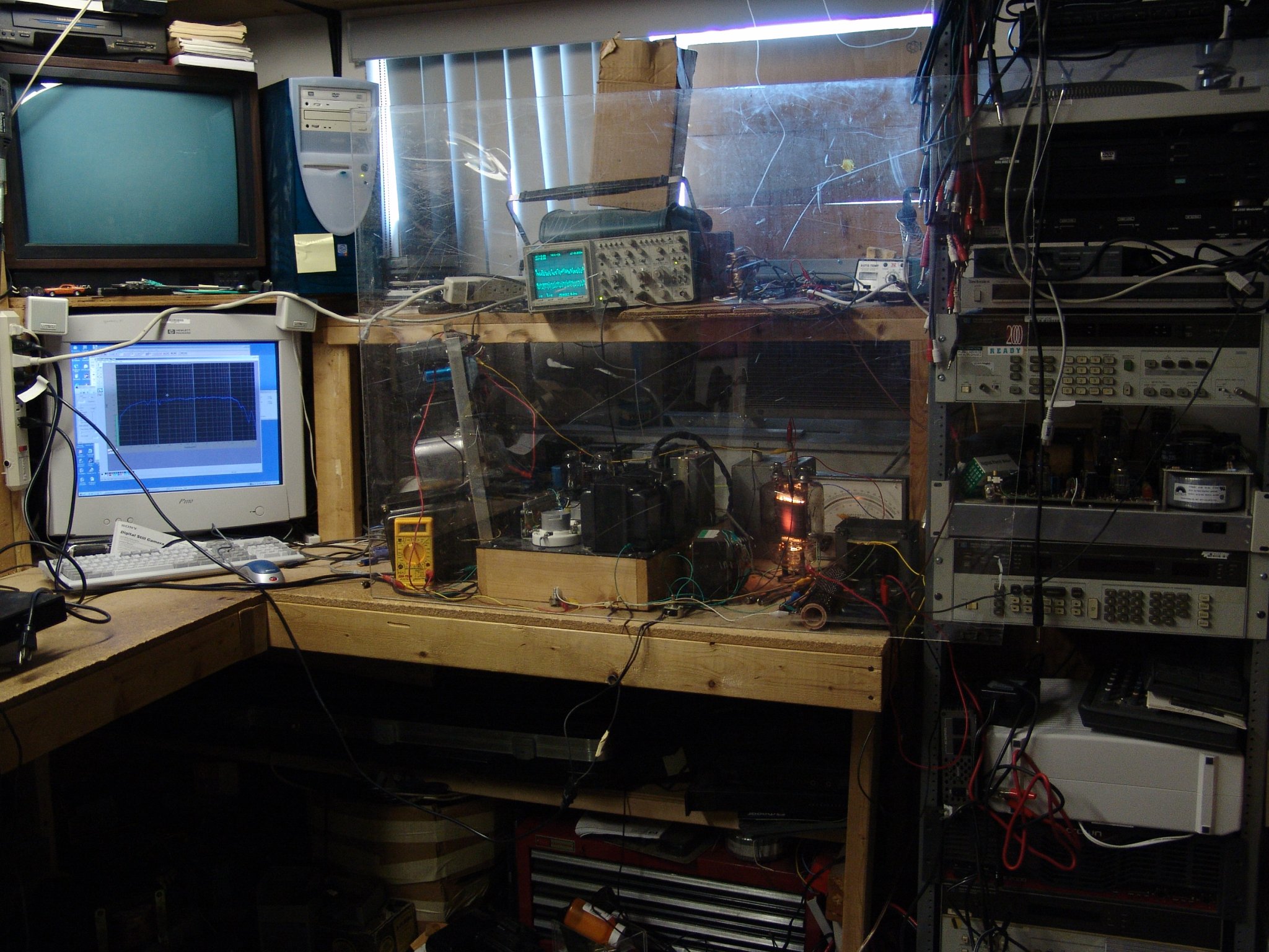

As long as beam triodes take 2KV to make any real use of people are going to continue to stay away from them. Self included. If I ever start doing anything with that kind of B+ it will be transmitter triodes. At least you can make some real power with those, and might be worth spending $1000 apiece on appropriate output iron. And having to work with one hand tied behind my back. Maybe less chance of getting 2 kV across your heart, but far more chance of dropping a tool in the middle of your work and vaporizing it (in your face).
I even shrugged off transmitter tubes a few years ago. I sold the remains of the 845 / 211 amp that I built almost 20 years ago at the last hamfest along with most of the tubes that would fit in it. The reality of my degrading hearing has led me to realize that I can't hear the difference between a 300B and a triode wired 6L6GC any longer, so a lot of the big voltage stuff has been sold. I still have a few 833As in a box somewhere along with a custom Transcendar output transformer for them and a power transformer out of a Harris transmitter to really wake up an 833A. In reality, they are still here because nobody seems to want them cheap and that 200 watt SE triode guitar amp is way too far down the unfinished projects list. The "200 watt SE OPT" is just to the right of the glowing tube. Glow at that level is normal for these tubes, but forced air cooling is recommended for the terminals. A custom Vice Grip tube socket is not recommended. Neither are the clip leads. There is 1500 volts in that yellow one! These pictures are about 20 years old, and I haven't built it yet.........
Note the 1/4 inch Lexan "blast shield" between me and the electricity when in use (except for a few carefully taken pictures).

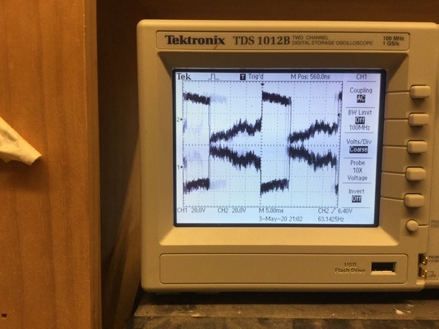

I’ve run into more than my share of local oscillations in cathode coupled circuits. Nothing destructive, but often initial symptoms defy explanation. Here’s a pic of a pair of complementary k-followers breaking in and out of oscillation at a 60 Hz rate. Driven by the instantaneous h-k voltage. Yes, it as elevated to the -68V bias. But the audio signal was large, and when it got large enough the oscillation started. That shifted the bias dramatically, and shifts back when the oscillation cuts out. There is hysteresis. But the oscillation frequency was so far above my scope’s capability you can’t see it. Just the audio riding on it. Solution was to move the bias PCB with the pots right between the two tube sockets and use the resistor leads to connect the board to the socket. Instant grid stopper.
When I saw something similar happening on an LTP using a silicon current source I instantly thought sh*+, it’s oscillating - and no way to add a grid stop because the feedback resistors are already using the available terminals. I put a 1k resistor in the tail , which would be unnecessary for the audio since the 2SC3902’s Zout is already high. But it got rid of the RF troubles.
