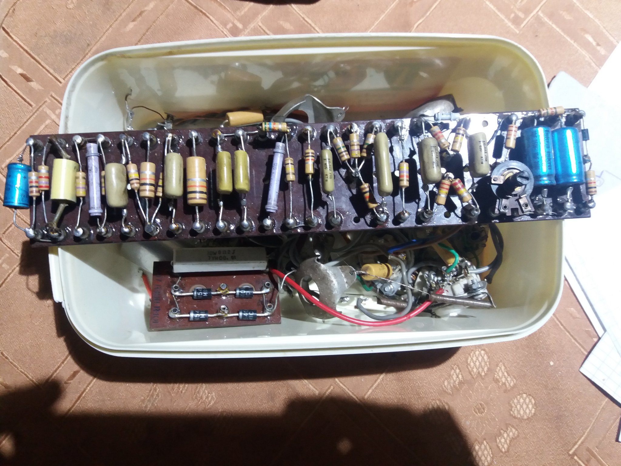

For sure that tube amps needs grid stopper resistors , especialy for output power tubes in high power PP amps, both for g1 and g2 , and connected directly to socket terminals , also it is not bad to add 10 Ohm/1% resistors from each K/g3 socket terminal connected to minus/earth common lead , just to made good bias level individual test points ,
btw, IMHO good guitar tube amps need to be made using only turet boards and not any PCB , same as is done in old Fender-s and Marshall-s,
here`s my DIY asembled turet board for one future Marshall 100W S.L. replika which use only very selected pasive elements , Iskra resistors & Philips blok condensers , Iskra turet board .
