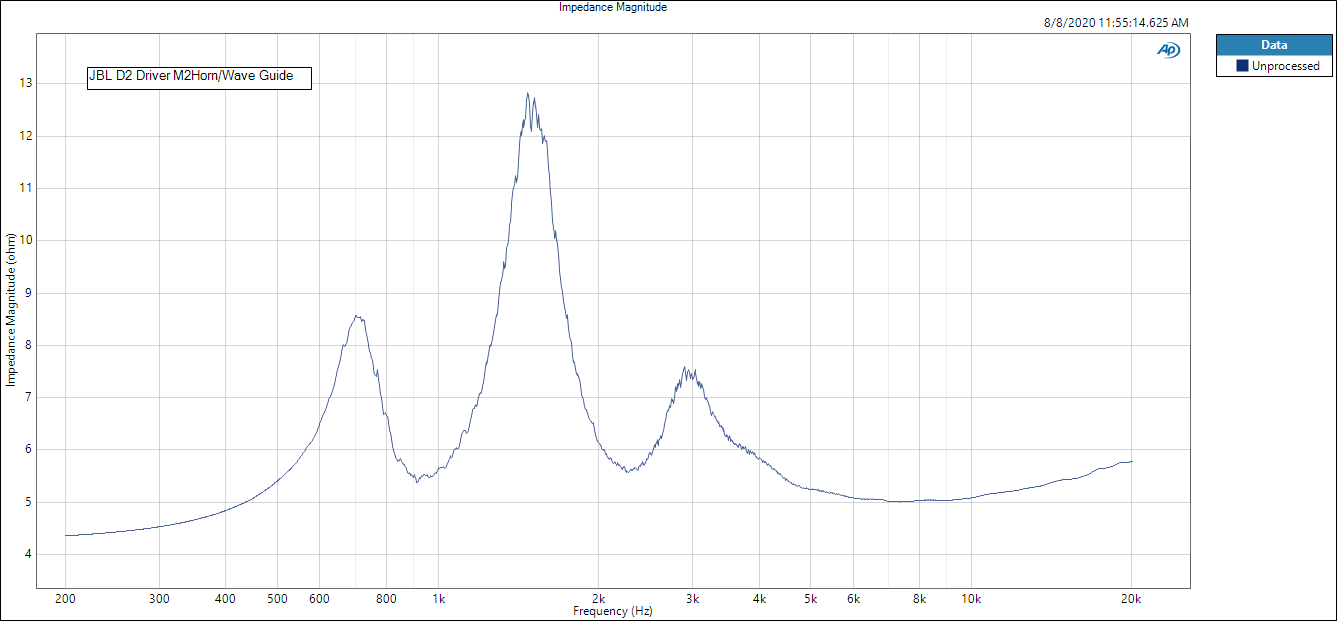

I sometimes use JBL D2 Compression drivers and M2 wave guides with resistors in series and in parallel to help tame the impedance peaks plus DSP equalization. The crossover is above most of the nasty acoustic impedance peaks.

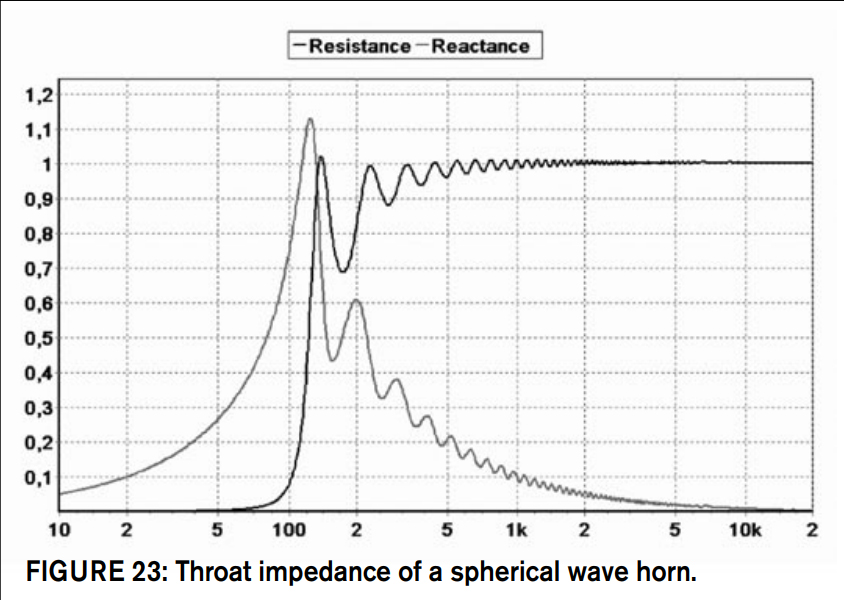

No need to struggle. Keep in mind that a CD with an attached horn / waveguide is an electro acoustic transformer; it is not solely electrical or acoustic. Remove the horn from the CD and run an impedance sweep of only the CD and you get one version of the impedance plot. Attach any horn that matches the bolt pattern and run a second impedance sweep. That impedance plot will be different than the first plot without a horn attached. If you want to dig deeper change out the horn again on the same driver and you get an entirely different impedance plot. The difference in plots is due to the varying acoustic impedance of the different horns / waveguides. If you are into it attach your OS horn if you like.
Short version the electrical sweep of the CD voice coil is a direct reflection of the acoustic impedance of the attached horn / waveguide. There are in fact distinct measurable differences in acoustic impedance.
Just for grins I have measured many of these CD / horn / waveguide combinations.

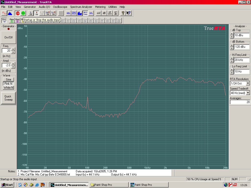

See the attached JBL 2425H CD with a JBL 2342 horn.
This is typical raw horn data. with smoothing I can make the plots look like the plots that you posted.

Since it's (old) Biradial diffraction horn with minimum phase resonances (Don Keele) you claim proper EQ does not help and you still hear them?
Yes much of the Frequency Response can be straightened out (equalized) with a 31 band equalizer or DSP. Yet still many of the signature horn sound characteristics remain; diffraction, harmonic distortion, intermodulation distortion (distortions caused by compression) and frequencies that reflect about inside the horn & are delayed relative to the direct radiated sound that does not bounce around (HOM’s). This horn can and does sound pretty nice but it still is a horn.

You're not going to vary acoustic impedance messing around at the driver terminals, but you can avoid subsequent issues with your crossover at the electrical level. Maybe that's what you meant?I sometimes use JBL D2 Compression drivers and M2 wave guides with resistors in series and in parallel to help tame the impedance peaks plus DSP equalization. The crossover is above most of the nasty acoustic impedance peaks.
Also some of these impedance variations are related to the compression driver rear enclosure. Surely nothing directivity related will come of that, nor does it need to be avoided?

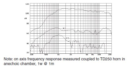

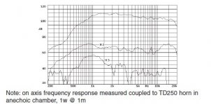

“Horn drivers have the worst nonlinear distortion compared to other components of professional sound systems (omitting free propagation distortion). Some of the driver’s distortions can be mitigated by proper mechanical measures. However, distortions caused by nonlinear air compression and propagation are inherent to any horn driver.”
Unlike amplifiers where THD+N is measured in parts per million, drivers are measured in parts per hundred or percent.
