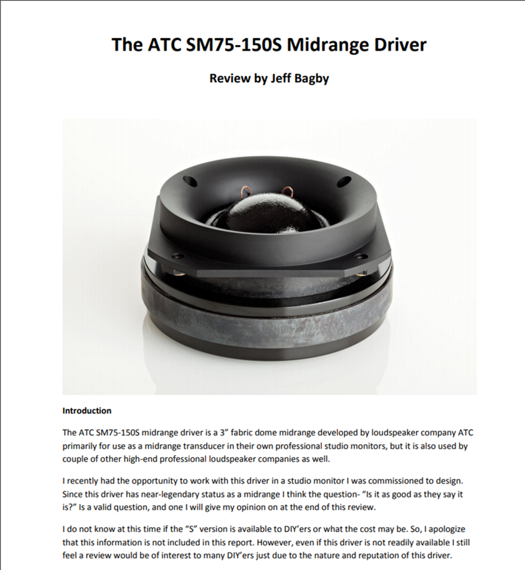

I find it's interesting that I sometimes feel that larger ATC studio monitors sound like high efficient horn speakers despite of their very low efficiency. I guess ATC's forward soundstage (a little more in your face presentation) due to mid dome and/or sharp edge of the enclosure makes me feel so. Tasteful voicing, I would say.
Your comment made me think of one of the best speakers I've ever heard, which was 15 years ago. It was a PMC monitor with (I'm pretty sure) the ATC mid dome and a volt 10" or 12" in a TL. It was natural with warmth, and tons of detail. Driven by a Bryston amp.

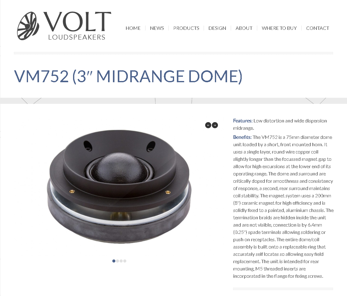

Rob.
attachment.php
vs
attachment.php
The specs don't line up either, in my opinion the Atc is the better of the two...if it made sense to use with the Axi, I'd buy a pair....still considering it anyway...=(

Hi Camplo,
It was about 20 years ago when I heard the PMC's. I'm still pretty sure they used ATC's back then (IIRC ATC stopped supplying other companies / selling that dome mid at some point. I remember because I was looking at building a clone but couldn't buy the ATC mid.)
Sterophile agrees with my memory if that helps :
Stereophile
Post number 22 here suggests there may be ATC's in the older versions of their speakers too.
Rob.

The domes will still have thermal compression. I have always disliked this about domes especially when I cross them low.
It appears one has been designed for baffle mounting and one for waveguide mounting, maybe?
