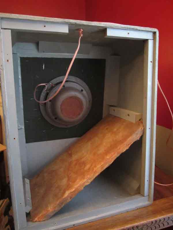

All those poorly designed, efficient LOUDspeakers must do something right in my ears.
One reason is that they are LOUD speakers and not faint-whisperers (with which one could live) or loud-screamers. They remain relaxed with authority up to higher SPLs than the faint-whisperers or loud-screamers.
