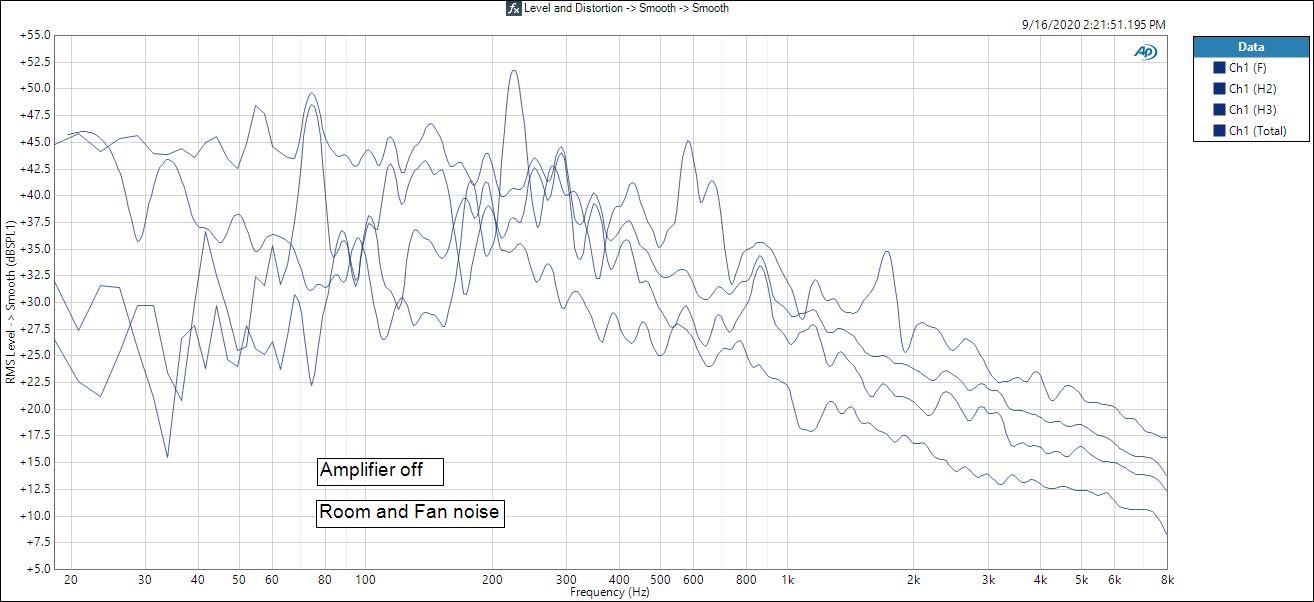

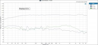

For grins these are plots are from the 6-1/2 inch peerless woofers in sealed enclosures on my bench.
The AP calibrated microphone is just a couple of inches away from the driver dust cap. I was not thrilled with the level of H2 andH3 distortion.
So I disconnected the APx555 analyzer output to the APx power amplifier. With no output from the speaker. the microphone measured only room, analyzer and amplifier fan noise.
There was very little if any difference between the driver H2 and H3 plots with the speaker functioning and the driver plots. Must be time to take the instruments outdoors with the microphone much farther away from the instrument cooling fans.
I will set up a couple of cd/horns and measure them at similar levels and post the plots.
Plots have 1/12 octave smoothing
