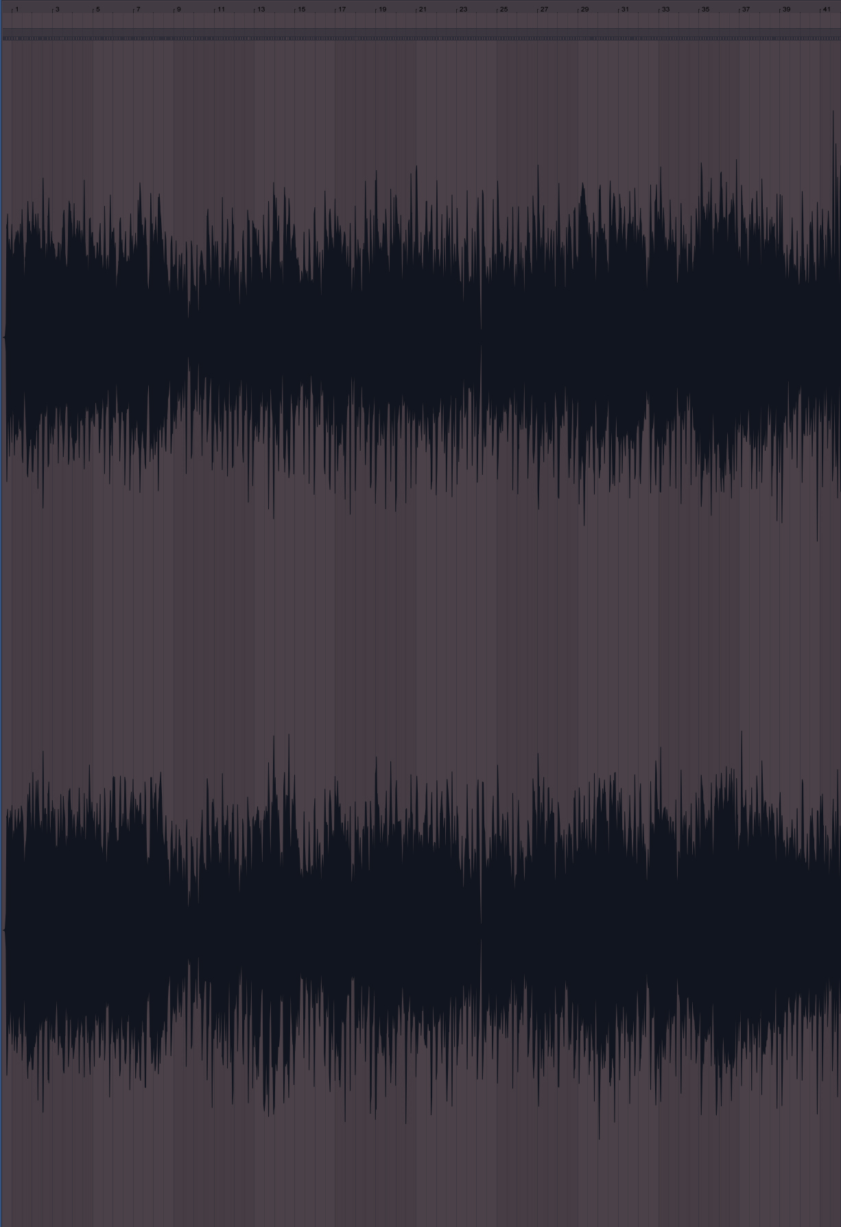

- A system is static if the output at time t depends only on the input at time t - the dynamic range is dependent on the time of input
- A system is dynamic if the output at time t depends on the input at time t as well as the input at other times (i.e. in the past or future)
- I don't think that audio signals are static.
- The dynamic range of an audio signal lies between 40 and 120 dB. - That dynamic range is static within the recorded signal
The signal is static...you are looking at it at a different perspective than I am portraying...I agree with you, a signal presents Dynamic material but in a very crude sense, the signal is static....
I took a picture of some signal to prove my point...stare at it for as long as you like....come back tomorrow...this signal is not going to change...I can take this signal imprint it on vinyl, cd, mp3, stream, etc....slight variations result in different material that in the same sense are static...so for our experiment....we take the one source playing one track, over several various systems....measure the recreation over the various systems....and the rms and peak energy will have changed(measure the rms and peak energy in this picture today or tomorrow it will not change)...point made.
Static - standing or fixed in one place : STATIONARY

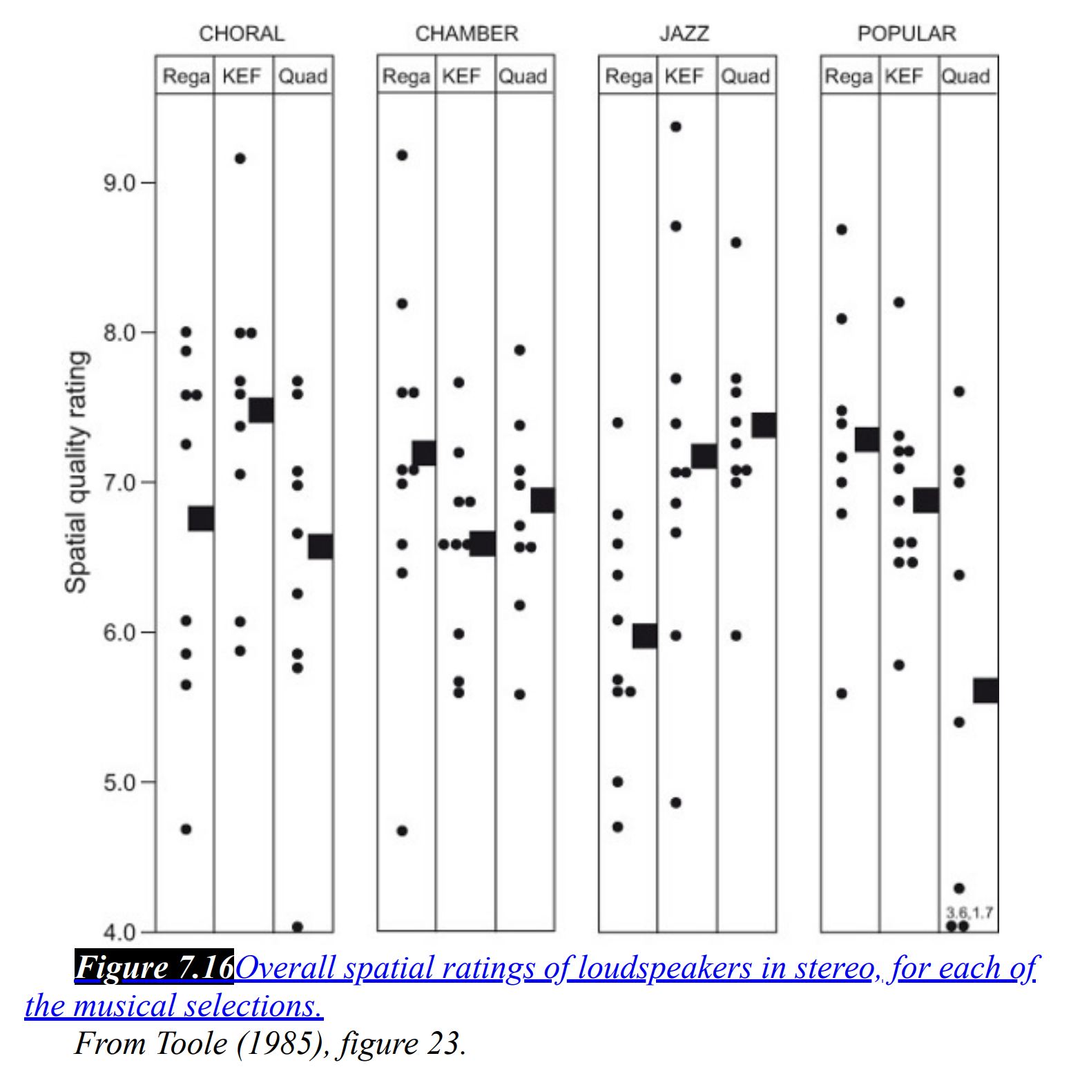

Your statement reminds me of this research by Floyd Toole. Loudspeaker directivity influenced preferences depending on music style. Narrow directivity (reduced lateral reflections/higher resolution(?)) had lower preference except for jazz.
Although, maybe I misunderstand what high resolution means in the context of the loudspeaker. The thread is about compression drivers so I think high resolution means narrow directivity through the use of horns.

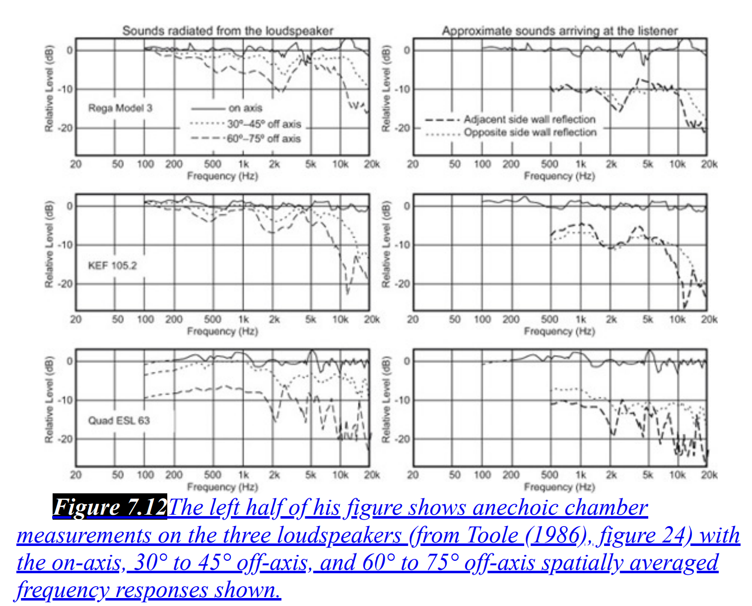

The speakers tested did not have smooth off-axis, the information is from chapter 7.4.2 The Effect of Loudspeaker Directivity - Toole 1985.
In these tests a loudspeaker with narrower dispersion, but with more uniform output off-axis, was given lower ratings than two loudspeakers with wider dispersion, but uneven output off-axis, suggesting that some amount of laterally reflected energy is desirable, even if it is spectrally distorted. Would loudspeakers with wider, more uniform, dispersion have done even better? - Toole
Toole's directivity research preceded Olive and Toole's work you referenced.
