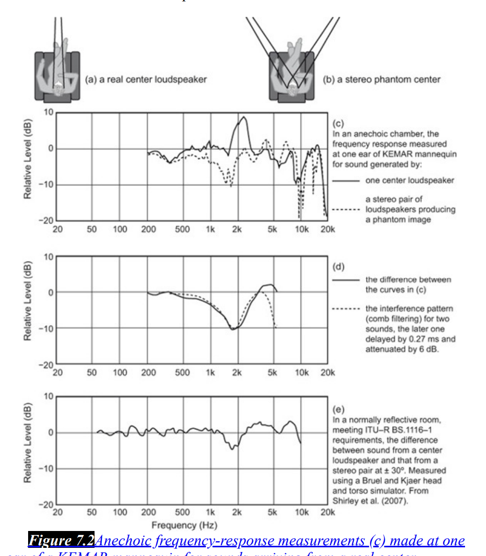

Toole covers it in Chapter 7.1.1
The stereo phantom center will suffer from a significant dip in the
spectrum around 2 kHz because the sound from both loudspeakers reaches
both ears at different times. This interaural crosstalk cancellation is the first
dip in an acoustical interference comb filter as explained in Figure 7.2.
Figure 7.2 Anechoic frequency-response measurements (c) made at oneear of a KEMAR mannequin for sounds arriving from a real center
loudspeaker, shown in (a), and from a stereo pair, shown in (b). The curves
contain the axial frequency response of the loudspeaker used in the test, and
the head-related transfer functions (HRTFs) for the relevant incident angles
for that particular anthropometric mannequin. The important information,
therefore, is in the difference between the curves that, around 2 kHz, is
substantial. The smoothed difference is shown in (d). Nothing is shown
above about 5 kHz because it is difficult to separate the effects of this
specific acoustical interference from those of other acoustical effects. The
dashed curve is the first interference dip (the first “tooth” of the comb
filter) calculated for an interaural delay of 0.27 ms (appropriate for a
loudspeaker at 30° left or right of center) and for an attenuation of the
delayed sound of 6 dB. (e) is the same kind of measurement done in a
normally reflective room, showing that early reflections within the room
reduce the depth of the interference dip.
Data from Shirley et al. (2007).
Figure 7.2d shows the difference between the curves, revealing the result
of acoustical interference. This can be confirmed by a simple calculation.
The time differential between the ears for a sound source at 30° away from
the frontal axis is about 0.27 ms for an average head. A destructive
acoustical interference will occur at the frequency at which this is one-half
of a period: 1.85 kHz. It won’t be a perfect cancellation, because of a tiny
propagation loss, and a significant diffraction effect. The wavelength is just
over 7 inches (178 mm) that, because it is similar in dimension to the head,
will experience a substantial head-shadowing effect at the ear opposite to
the sound source.
