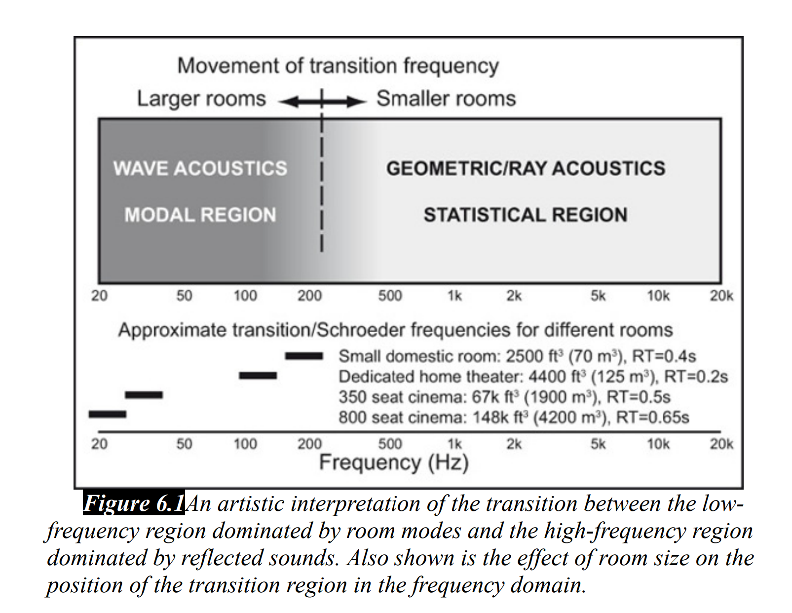

We call it the Schroeder frequency but there's actually the ray acoustic region, followed by a sparse modal region, followed by the modal region. Schroeder is within the sparse modal region.
Most speakers in the multi-way forum are designed to operate in the ray acoustic region. Few speakers in the multi-way forum are designed to operate in the sparse modal region. No speakers in the multi-way forum are designed to operate in the modal region. Modal region speakers are in the subwoofer forum.
john k... summarized points from a research paper on designing speakers to operate in the sparse modal and modal region here. (I'm really grateful to john k... for posting that information because it used to befuddle me.) In Pursuit of a 20-20k Dipole Loudspeaker
When you're in the modal region you have a physics problem and a psychoacoustic problem. The physics problem is the sound waves are so long they get squashed by the room boundaries. The psychoacoustic problem is your brain needs to hear the low frequency long enough to recognize what it's hearing. By the time your ear has been exposed to the LF sound long enough for your brain to recognize it the sound wave has bounced around the room many times and has hit your ear from many different angles. Further, we have difficulty localizing low frequency signals even when we are in a large room or an open field. If you can't localize a low frequency in an open field you're definitely not going to localize it in a small room where it's bouncing all over the place.

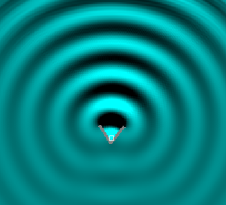

Higher directivity will still lower the energy of the other reflections...higher amounts of direct energy equates to clarity.

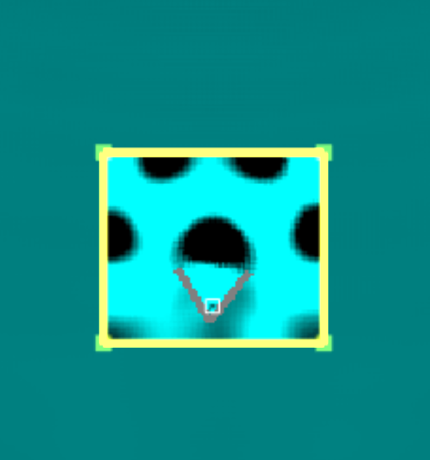

Use the ripple tank simulator. Add a horn. Then wrap a small box around the horn, because that's your room relative to long low frequency wavelengths.
Ripple Tank Simulation
For sure the room dominates, so truncated horns loading just enough to couple to the HF suffices, or in many cases, just use [multiple] H.E. [horn] drivers in a sealed or damped vented alignment depending on the desired efficiency/cutoff point.
GM

Omg thank you so much! someone posted this ripple simulator in my thread earlier this year and I haven't been able to find it buried within the pages...oh you one.
