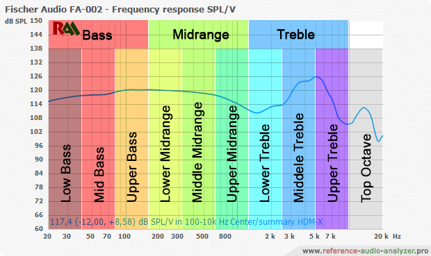

Human hearing accuracy peaks at ~1 kHz and peak sensitivity around 4 kHz, so thinking the DRs. Geddes are telling it like it is. 😉
GM
GM

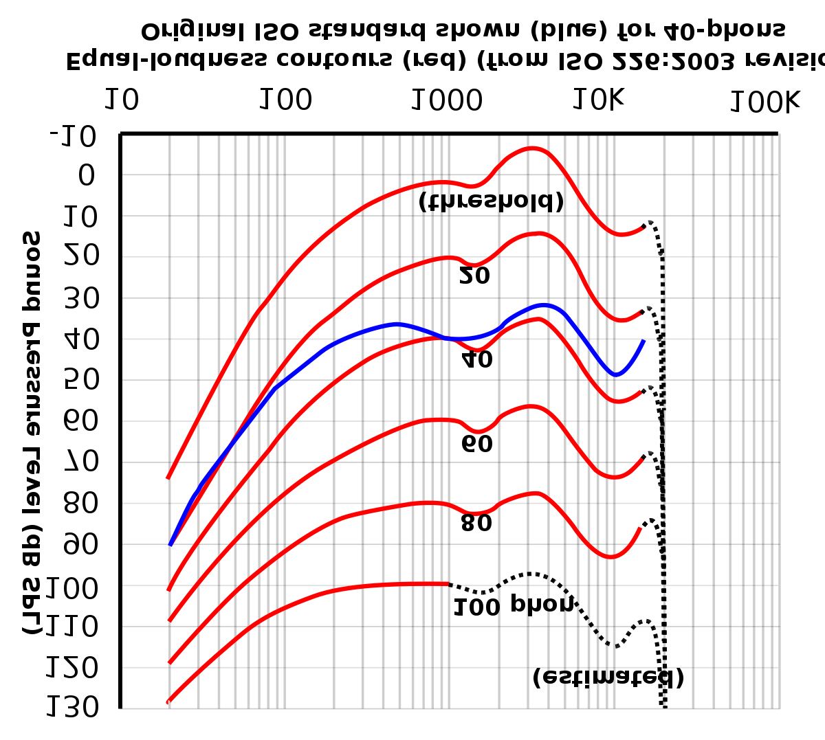

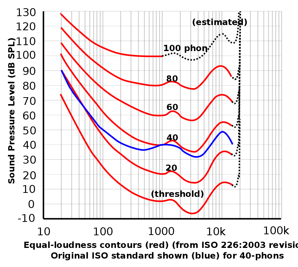

Gotta say, couldn't disagree more, there is much more going on than where hearing sensitivity peaks
you can look at the equal loudness scale and reverse engineer sensitivity of some degree.....looks at about little before 1000hz to 6000hz to be the most sensitive to spl.....just like a horn, if the ear is sensitive to spl in that area it is going to exaggerate any flaws as well....it would seem...now the brain is pretty complicated so theres more to it than that but 700-7000hz what I read Geddes calling the critical range....now line those numbers up with what I just reversed engineered using logic....one might suggest that the horn that is known as the ear canal? has a resonate note ~3200hz....I present resonate/tuning note and cutoff....
using my approach of reverse engineering, I could say that, the perceived resolution, in this area accompanied by the rise in sensitivity, to spl in the same area, is suggestive that sensitivity and another layer of SQ is intertwined....and that higher sensitivity systems may have have an advantage over lower sensitivity systems based off of that alone.
My hypothesis is that also regarding acoustical haptics, that as ear sensitivity dwindles, lower and lower, our sensitivity to physical vibration offsets that and has an opposite curve of increased sensitivity....

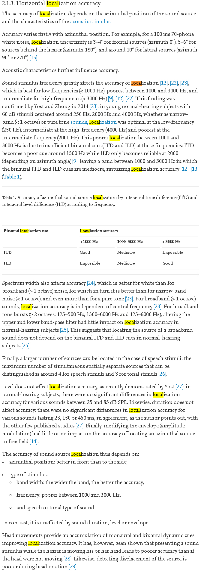

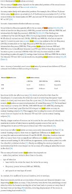

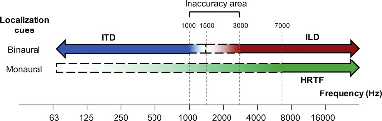

can you source where you have read the information regarding localization vs frequency? It was said that we can't localize frequency at certain spectrum? really?
I posted this in the thread on major frequency ranges so I wouldn't forget where I put it.
Sound Source Localization
Another one to keep in mind is that we have difficulty localizing frequencies below 7,000Hz on the vertical axis. I don't know if that means it is beneficial to keep 7,000Hz+ off the ceilings. Sheetrock ceilings might naturally absorb those frequencies, I don't know.

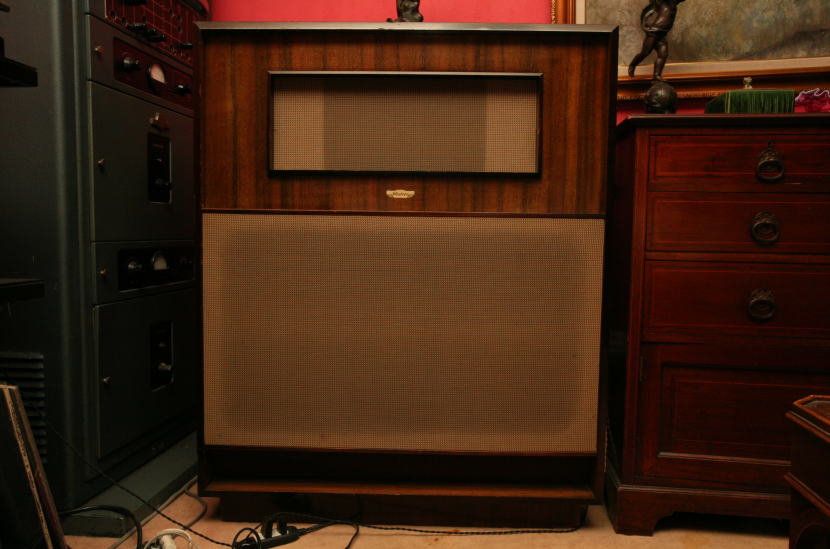

Totally bollocks. Look at the Shindo speakers, very traditional systems that employ famous Westrex and Altec components.Is it pretty much consensus that compression drivers in traditional horns stink for home audio?
Is that about the gist of it?
The original Westrex horn speaker was made for home audio listening, too.

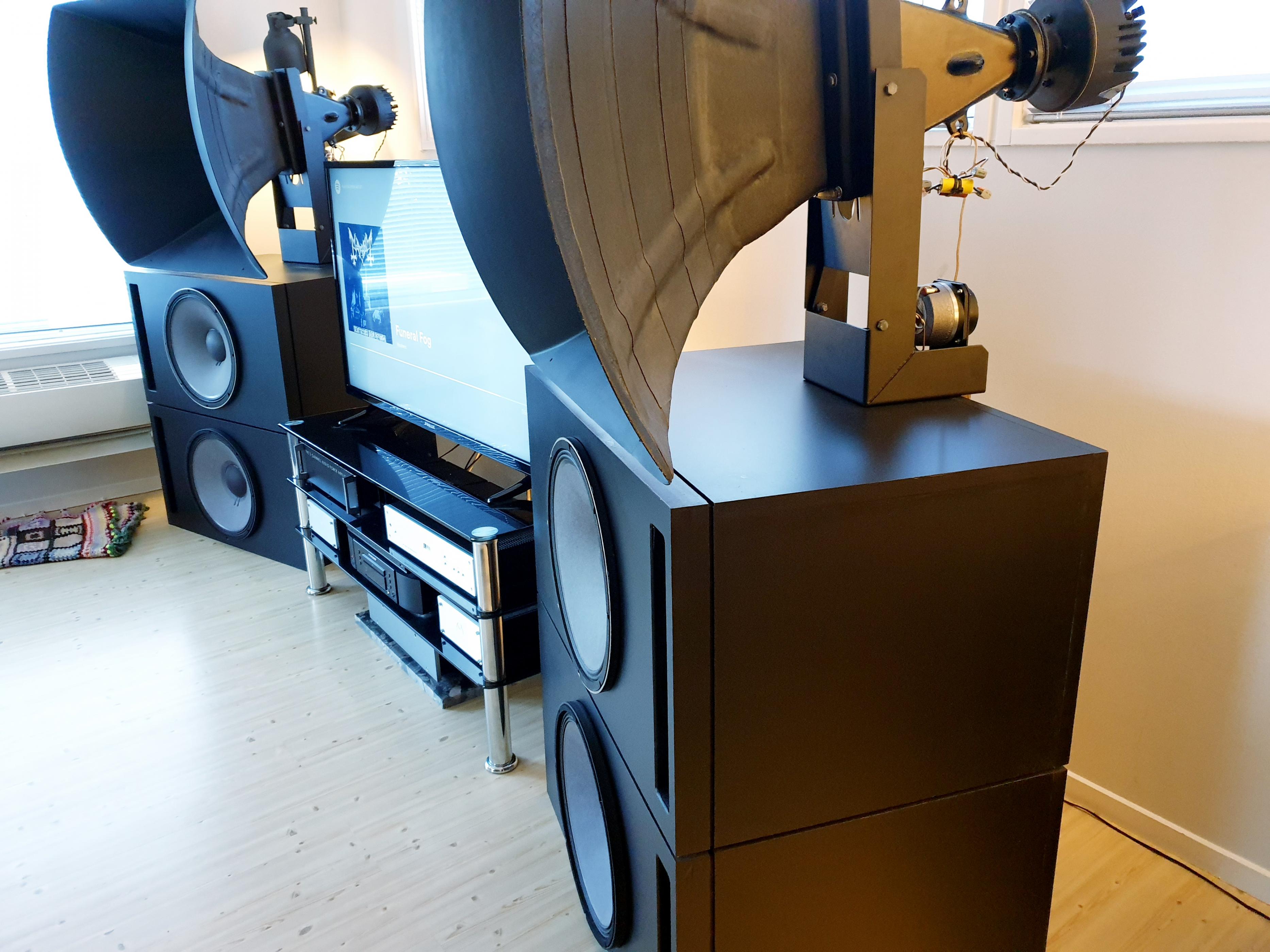

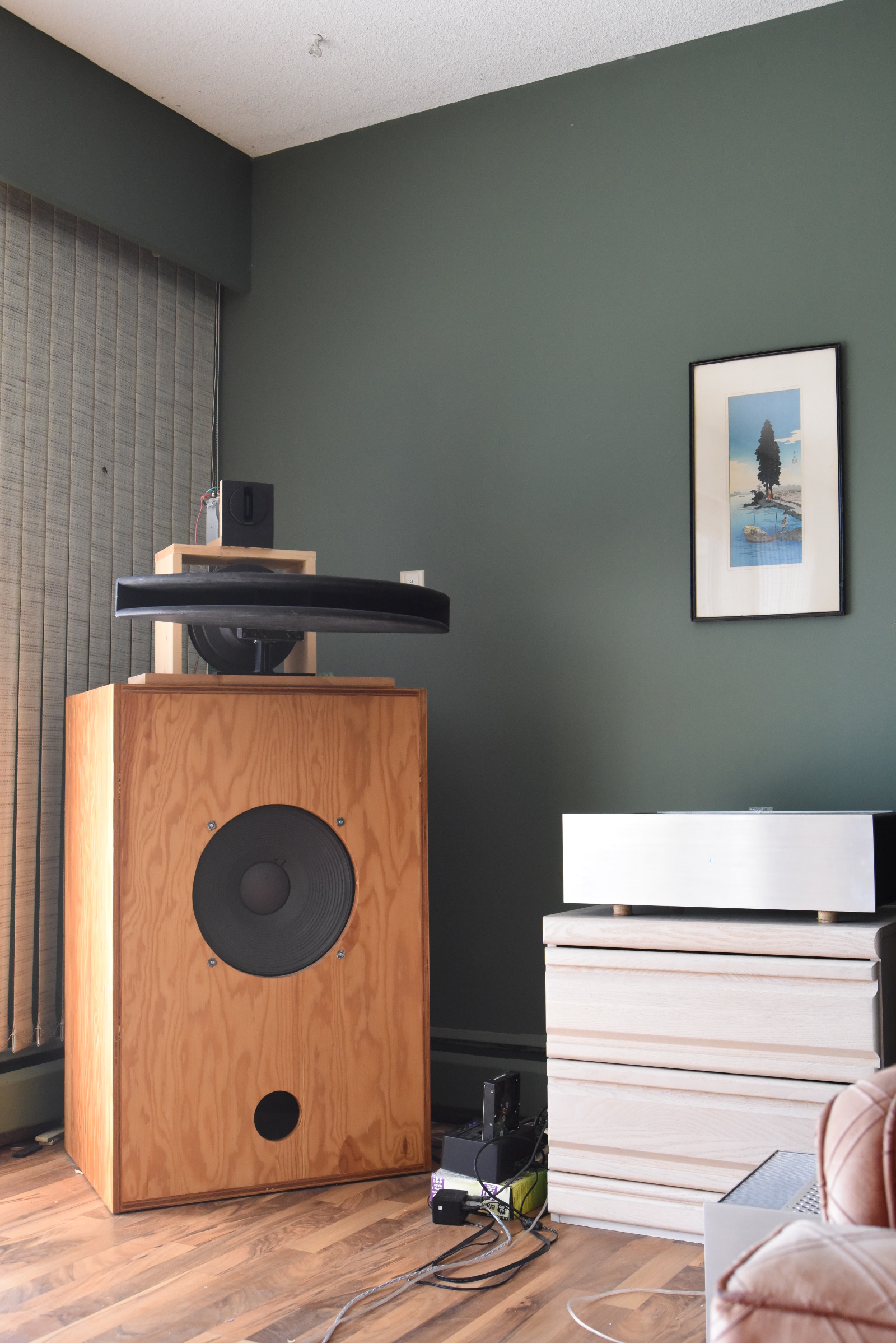

Here are some observations / opinions on why my horn system performs as well as it does, despite some of the "techno-babble" I have seen here.
Driver selection: The Low midrange, I originally had 2441 JBL drivers, with original diaphragms. I then replaced the original diaphragms with Truextent beryllium diaphragms. This was an expensive but worthwhile upgrade, more extension, more detail. Also had TAD 4002 drivers which were also very good. From there I went to the Classic Audio field coil driver with beryllium diaphragms, which I feel is as good as it gets. Dr. Bruce Edgar gave me a 20 minute lecture ( which went right over my head) on why field coil drivers are superior to fixed magnet drivers. I will not even try to explain this here, but it does give me some flexibility dialing in the sound by changing the power supply voltage.
The upper midrange driver : a custom design field coil driver made by Jeffrey jackson and Dave Slagle using a JBL beryllium diaphragm. Only a pair or two are in existence.
Tweeter: I have tried the Fostex T500mk2 and it is excellent, also a Sequerra T1mk4 tweeters, good but too low sensitivity ( for my use), same with Raven R2 ribbons. The best is the TAD ET-703, a great match, high sensitivity, beryllium diaphragm. Now, as rare as hens teeth and expensive if you do see them for sale.
IMHO you must have a mid bass horn, that is high sensitivity, that closely matches the other drivers. This is where most horn systems fall flat. This is why I used 2 Altec 515b's in parallel. If you have to pad down all of your compression drivers to match your mid bass horn / box speaker, IT IS A TOTAL WASTE OF POWER and sucks the life out of the compression drivers by adding all the additional passive crossover parts !!! This doesn't mean you can't get good sound but you will not get the speakers full sound potential. Adding active crossovers, amplifiers, cables, DEQX, etc. makes things worse--I have tried. A simple, high quality, 6db crossover sounds the best--IN MY SYSTEM--with the drivers I use !!! YMMV.
Time alignment: All the drivers voice coils are in line within 1/8", with the exception of the subwoofers.
Hope this information helps some of the compression driver / horn lovers here !!!
