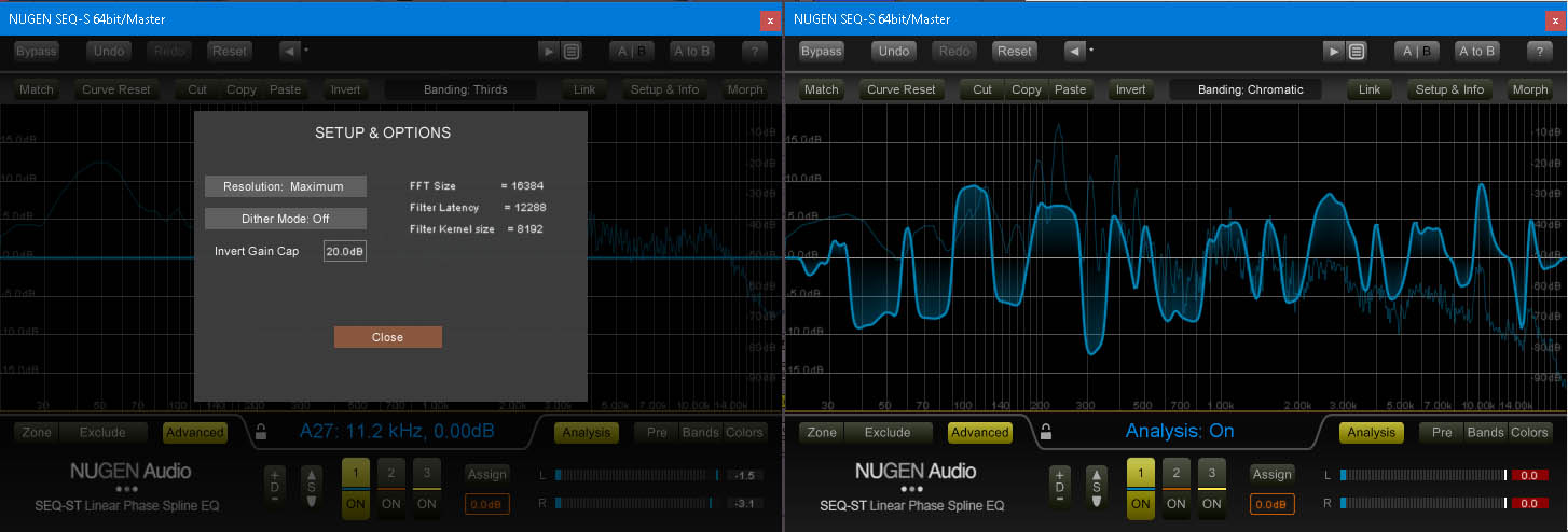

I think because of my experience in the music studio I immediately focus in on FR and quality of Eq. The accuracy in which filtering is implemented, is critical to final outcome...somehow the expensive stuff is still low quality in resolution regarding manipulation of the signal curve (in the loudspeaker application world). In my DAW my favorite linear eq has many points of control

Camplo, how much delay can you tolerate?
For music production, I can probably tolerate "a lot"...like when I get several of these cpu intensive plugins going I have to increase the buffer size on my focusrite which in turn further increases latency....I just set my focusrite2 to 1024 buffer size and in Ableton it says 22ms output latency....for every 3rd party plugin I run, add 1-2ms of latency/per... if I recall? Linear plugins add more latency than that, per instance.....there are ways to keep plugin instances low and still use as many as needed, but I'll have over 20 plugins running on a project...
I won't tolerate high system delay because I play fps games competitively...I have since 2000 actually lol...not straight but you get what I mean...so I am well aware of latency vs input relationship...as well as your output (sound and visual) and the top competition want to see low numbers.... everywhere. So for the sound system you could see why I personally would sacrifice linear filtering for latency.
I don't understand how taps relate to resolution with minimum phase eq. I have around 16 points of parametric eq per channel with the crown input cards....whats the equivalent of that in the linear filtering world.
