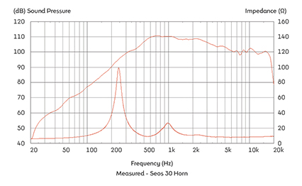

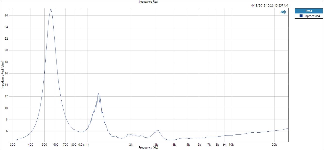

- This isn't true for all horn/CD combos....is it?Turn off all the analyzer smoothing tools and look at the raw data plots. The CD/horn/waveguide plots look like saw teeth.
Here's my driver on Seos 30
Not much going on in the Impedance that I see.....Is this FR "saw toothed"? The charts are definitely smoothed but the impedance doesn't have much character to it at all...I think you might be talking of certain Horns....I've had enough discussions here to believe that certain profiles like that of the Salmon, are very very neutral, requiring the least amount of eq, in comparison to other horn/waveguides....
Maybe you can find (and post) some measurements to visually express your view of this relationship. I have read of other highly praised CD's that even though the FR wasn't as nice as the comparison drivers....its impedance showed much lower resonance. I have not personally took time to compare dynamic driver impedance to that of potential horn/cd combos....
