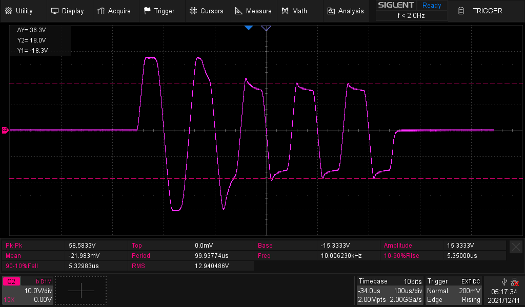

Attached is a scope screen shot from the SOA protection test of my latest mono block power amplifier (300 W / 4 ohms) . The SOA protection includes a "natural current limiter" per Bob Cordell to provide rapid and clean limiting until the slower V-I limiter kicks in. The V-I limiter is dual slope - one for above ground and a different one for below ground. The test waveform into the amplifier (gain = 20) was a 4 Vpp, 5 cycle burst of 10 kHz sine wave within a 100 ms period. The amplifier load was 1 ohm. The first cycle shows the clipping provided by the "natural current limiter." The amp puts out 28-30 A into a 1 ohm load for the first cycle. The second cycle shows distortion from the V-I limiter starting to kick in. By the 4th cycle, the V-I limiter has stabilized with the peaks limited to ~ +18 A into the 1 ohm load. Although there is over/undershoot and some slope across the tops and bottoms, it is fairly clean. The waveforms look much better at lower frequencies. This is a pretty severe test. I do not have screen shoots for reactive loads.You really need to see VI limiter waveforms to understand it.
Seeing is believing! 🙂
Do you have a 1 ohm speaker I could borrow? 🙂Try it with a speaker.
Oh, I forgot, the measurement was made after the output L-R network (1 uH // 2.35 ohms) so there was a tiny bit of reactance in the circuit.
Yes.
The BIG one, who triggers VI protection like crazy (for very good reason), is at the low frequency resonance.
