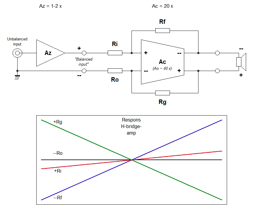

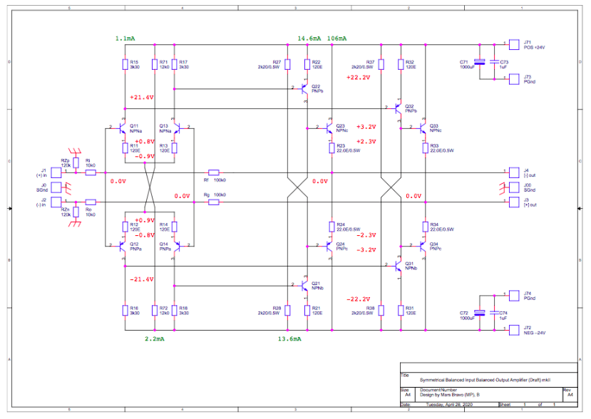

Symmetrical differential front stage, and a double Sziklai output: the Hiraga Bridge.
Named after Jean Hiraga, to honour the master.
This is my 'small exercise' design, somesort proof of concept of an 'interwoven' balanced bridge design.
Open loop bandwith (in simulation) close to 100kHz.
No rocket technology involved.
Bonus: no balanced input signal needed.
Extra bonus: no popping, no safeties needed.
Goal is to omit Q23, Q24, Q33 Q34 and replace Q21, Q22, Q31, Q32 with low output impedance ('v-fetish') compounds on which I'm working now (very promising).
