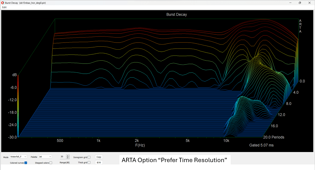

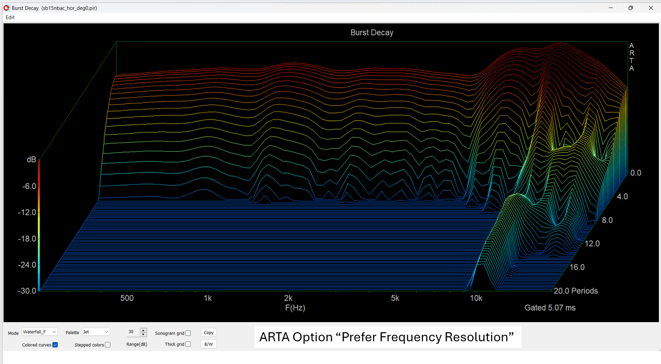

I have been wondering about this smearing that you speak of. I would like to get your opinion of something...By contrast, the other methods do not show the signal information at the microphone/ear, but rather a smeared approximation of it.
Here are two burst decay plots as processed by ARTA. This is a far field measurements of a 5" driver, installed in a cabinet. The gate window is about 5 ms. Both plots are made from the same impulse response, which is in turn made from a 4-sample average of Periodic Noise.
ARTA offers two options when presenting a burst decay plot. One is "Prefer Frequency Resolution", and the other is "Prefer Time Resolution". I use both plots to gain insight into speaker behavior, but I have often wondered about the math behind the plot. I am guessing that both plots are limited, but limited in different ways. Is this related to the smearing that you talk about?

There are two related but distinct answers to this question...I have been wondering about this smearing that you speak of. I would like to get your opinion of something...
Here are two burst decay plots as processed by ARTA. These are far field measurements of a 5" driver, installed in a cabinet. The gate window is about 5 ms.
A Wigner Distribution is limited in its resolution by Heisenberg's Uncertainty Principle. The non-linear windowing I mentioned previously is intended to trade-off time resolution for frequency resolution determined by this principle in order to better approximate how our hearing works as we move from a transient model to a steady-state "spectrum analyser" type one.
This is different from the additional smearing of the Wigner Distribution that occurs in producing decay (or attack) spectra, spectrograms or the like. You can imagine every such display a starting with as Wigner Distribution then filtering out information. If the ARTA is a Cumulative Decay Spectra, then by its (mathematical) definition, it will have discarded information that would have been evident in a Wigner Distribution.
The question to be answered is what relevance can be given to the discarded information...
Further wrt the plots you have shown: You can see the greater frequency resolution in the top plot where three, possibly four resonances are observed above 5kHz and within about the first 4 periods. In the lower plot, these peaks are smoothed into maybe two apparently broader resonances, but where features in the resonant decay at 5kHz appear more evident.I have been wondering about this smearing that you speak of. I would like to get your opinion of something...
Which display is correct? They actually are both "correct", but the analysis/display method smears different aspects of the information presented. And that is just the decay, what about the attack spectra information too?
The question is then which display better models what you are hearing? I suggest they are both unduly compromised in this quest.
