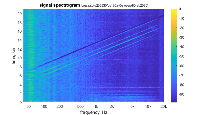

Sure, have a look at the residual error err=mic-filter(rir,1,spk):
Do you see the dark band after the main sweep line? If rir was unbiased, there should have been noise there, same as before and after. If you see the dark band, that means your model overfitted the observation noise.

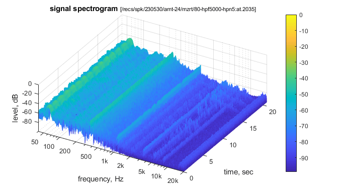

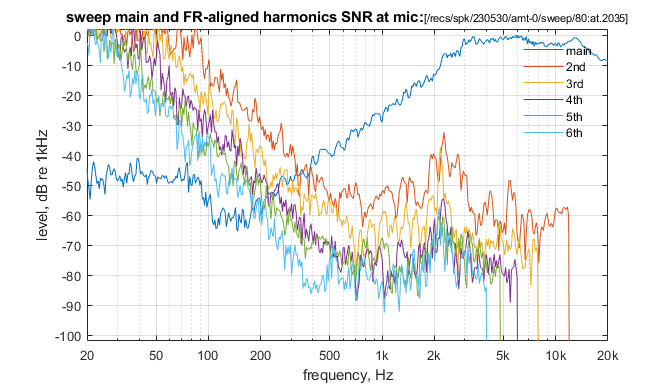

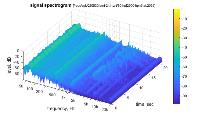

Regarding tweeters: let's consider ATM tweeter from ADAM. That's how it measures on a tone, producing 80dBSPL:
You can expect lots of distortions if you cross it at about 2500 Hz, right? on Mozart piano concerto it looks like that
... quite a lot. But if you cross it at 5000Hz, the residual becomes practically inaudible:
You can not expect such a difference from sine sweep test, can you?
(pls ignore fridge noise bands)

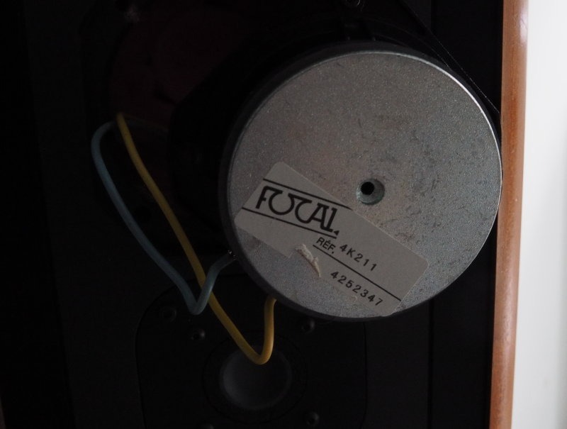

I am lost. Due to my fault, my loudspeakers spent half a year in poor conditions. When I brought them back, the midrange turned out to have deteriorated beyond listenable. The speakers are old, there is no direct replacement. How do I find out a nice 3-4" midrange, 250...2k5 Hz? I ordered a bunch, started to test them, and found that I had more questions than answers. Then I ran into this thread and found that I am not alone.And for testing, I’m more into the proof of the pudding. If literally no one can taste the difference, there might be one, but is it of any value other than academic?

So, what speakers are they? A picture of front and back would help. If it's something like 5" cone with metal sealed back, you aren't looking at an expensive speaker. Someone here may be familiar with them and can provide guidance.

Here they are. Yes, the replacement would be expensive ... and I do not want to buy 10 candidates, $500 each, and find out that they are of inferior quality. So I am profoundly confused... in the same boat as others.
What brand of speaker, or are they home designed and built?
You should be able to find the specs on those Focal speakers. They may even have a modern equivalent, probably better.
D
Deleted member 375592
Speakers are Focal Spectral 908.1, ca 1994. Someone on this forum had exactly these midranges for sale - but in 2008. Unfortunately, Focal does not make anything suitable as a replacement anymore, I asked a local dealer already. I tried to measure some candidates in his shop (car stereo) ... no success. So... let's look at the other vendors, right? There are so many measurements published, right? But then you read the comments about how badly people disliked the drivers that measured so well. I got some drivers from solen.ca Again, no luck. There are acclaimed Purify drivers, but they are of much lower sensitivity. Little by little, I became very interested in the topic of measurements vs reality, and here we are🙂
