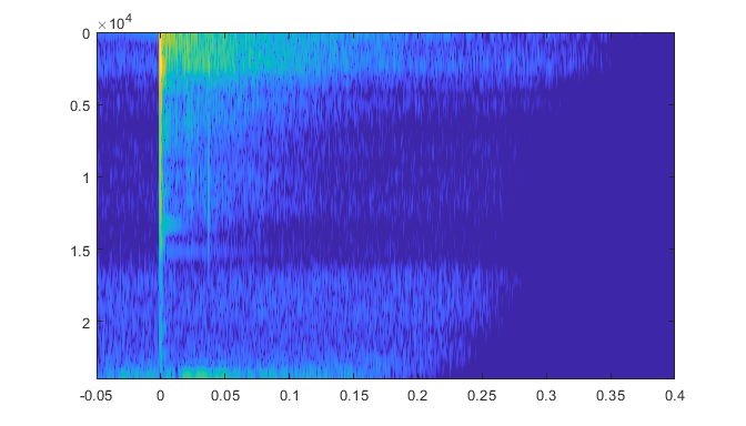

Thanks for this Mike. Anyone here willing to do a waterfall from the IR?Here is the RIR, attached as zipped .wav
My question is, "Do you recognise Angelo's method (it's not just his log chirp) as a Matched Filter measurement?". Thanks for the history lesson.Of course, I know what orthogonal Matched Filters are. I don't remember which Angelo's papers I read but AFAIK, the first open publication on the topic is the 1960 'Theory and Design of Chirp Radars' which refers to classified publications from 1947 by Darlington.
If you want an error estimate, just do the measurement several times and you will have enough info to do statistical analysis & error estimates very quickly.
What methods do you propose that have better LF noise immunity than Angelo's method within a limited time window?With all due respect, I disagree... but, please, don't allow me to punish you with a 1000-page lecture on adaptive signal processing.
How do you do your IRs & RIRs?
Can you explain why the noise at t<0 has disappeared by t = 0.4?The Theory of System Identification gives you a slightly different RIR, including on lower frequencies, like:View attachment 1283984
Everything left of t=0 is the model noise. Thus, you know that what is at t>0 is not perfect, and how badly not perfect. You know then that there is something wrong at f>16kHz (which is, I guess, Barkhausen noise) while the matched filters fool you into unrealistic belief.
Are you claiming this "TSI measurement" gives more useful info than your #434 spectrogram? BTW, 2ms is about 2 feet

Very good question!Can you explain why the noise at t<0 has disappeared by t = 0.4?
Yes, it is a feature of ReLS which is a biased estimator.

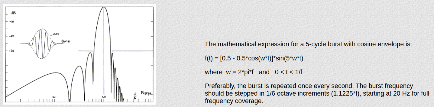

I would like to focus on those practical measurement techniques that are available today to a speaker designer. I want to discuss
(1) those measurements which should be used to select the best drivers for a project.
(2) The measurements needed for simulation and to implement the design.
(3) The various techniques and equipment that people use to perform the measurements.
I would also like for us to distinguish between those measurements which are crucial to the design process, and those which are nice to have because they make the design process faster. Which measurements become important when aiming for top performance?
So I will start.
Impedance sweep: A driver impedance sweep both in free air, AND as installed in the cabinet, is one of the most crucial measurements. It reveals the driver Fs, the Le, the Re. Impedance wobbles show the existence and frequency of potential resonances. The impedance data is used in simulation to model passive crossovers. I use DATSv3 for this. It automatically calculates the Fs, Re, Le, and for sealed box designs, the Qt of the driver+cabinet.
