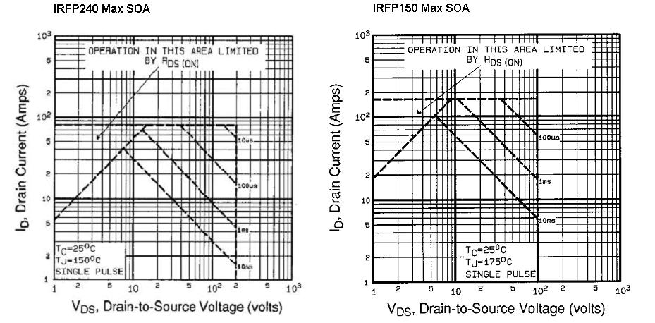

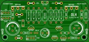

I just checked with our only local shop in town but IRFP150 is missing, on the other hand they have IRFP240 so I'm wondering could I use it instead, see attached picture of Maximum Safe Operating Area for both FET's if that helps.

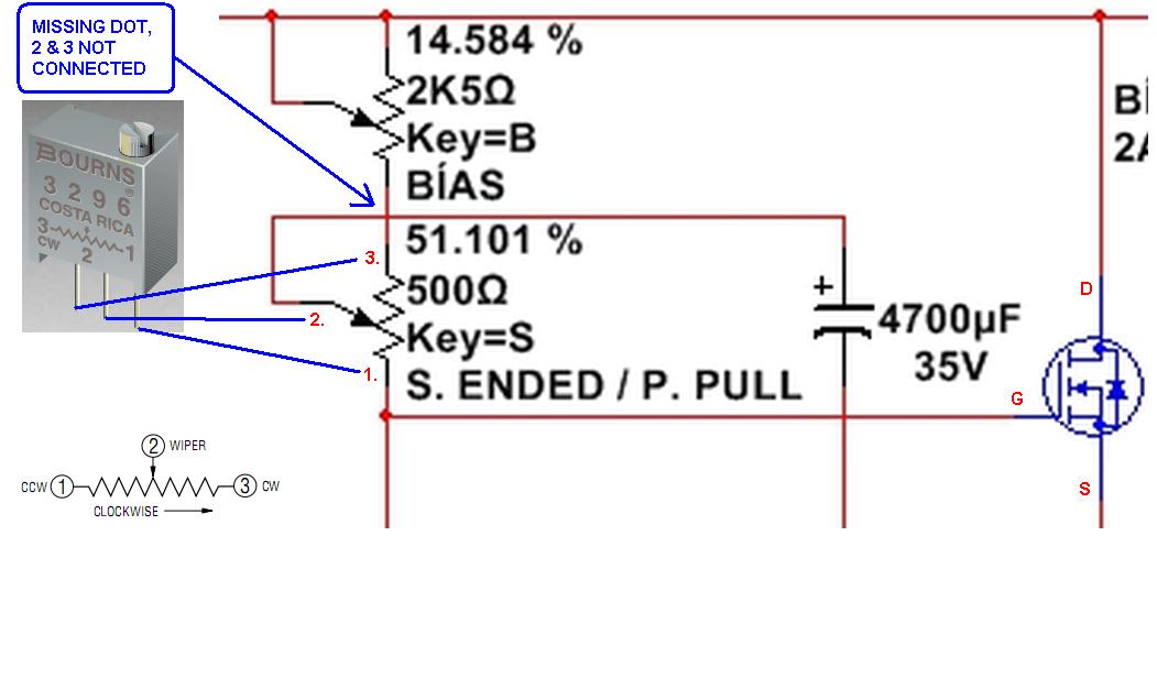

X when you trim the 500 Ohm trimmer CW, does that mean the trimmer wiper (center leg) goes towards the one end where the 2,5 kOhm trimmer is connected, and vice verse, CCW is when the wiper goes towards the Gate of the output FET?
My amp uses IRFP240 - works fine and readily available like tap water. I will have to look at my pots to see what way the CW and CCW are set. However, if you orient them as I have in my photo it should be consistent. Although it's of no consequence as you simply go the other way. Although without measurement you won't know I suppose. Let me get back to you.
My pot is labeled and wired such that when the turned CW, the value presented between top pin (3)/wiper (2) which are connected together, and lower pin (1), is that the overall resistance increases. Standard Bournes 3296 (actually a Chinese "Bonens" clone - don't flame me, they work just fine at $3 for a bag of 20) pot.

Thanks a lot X, good to hear IRFP240 will work!

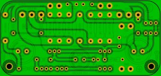

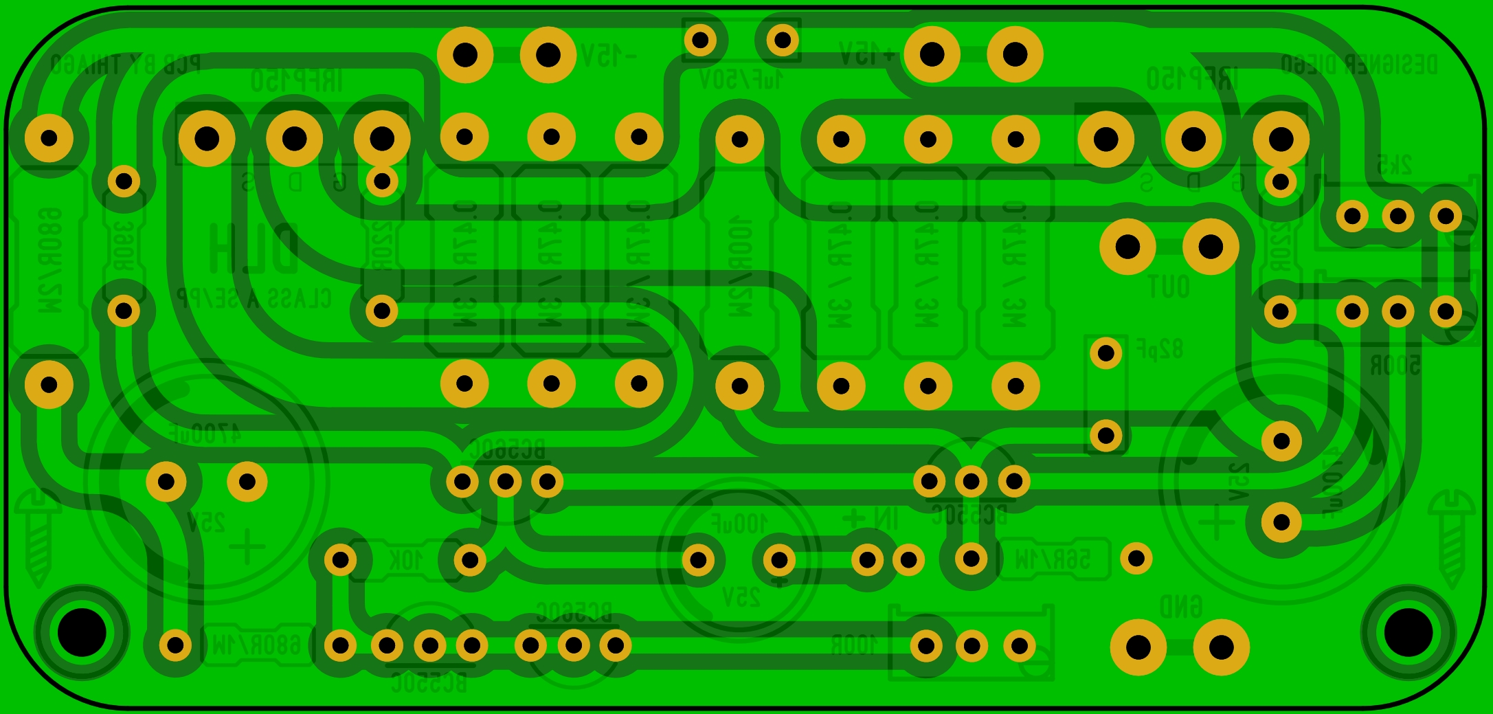

I must be a bit slow today... did you say you connected the 500 Ohm trimmer leg 2 and 3 together, please check attached picture.
This may also be reason why the offset starts to wander when adjusting the SE/PP trimmer?

I sure did! Doh! That's what happens when you layout PCB's by hand marker in the wee hours of the morning. 🙂
I will take an xacto to it then - but I assume this may completely change the bias setting. Maybe I will leave alone for now and just enjoy it 🙂
Thanks for pointing that out.
Oy vey! 😛
Yes it looks like to affect the bias as well as the overall resistance decreases, I wonder now how much that did with the decreasing H2 distortion in your earlier FFT measurements, anyway now it's time for a break over here too, and tomorrow am heading over to our local candy boutique collecting some goodies! 🙂

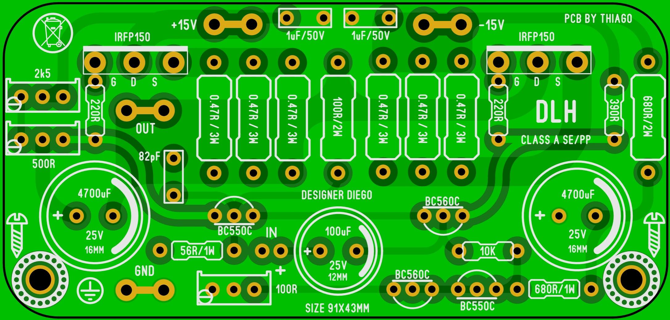

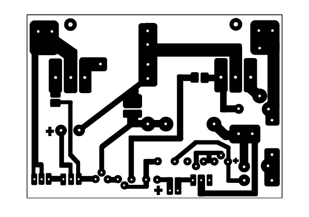

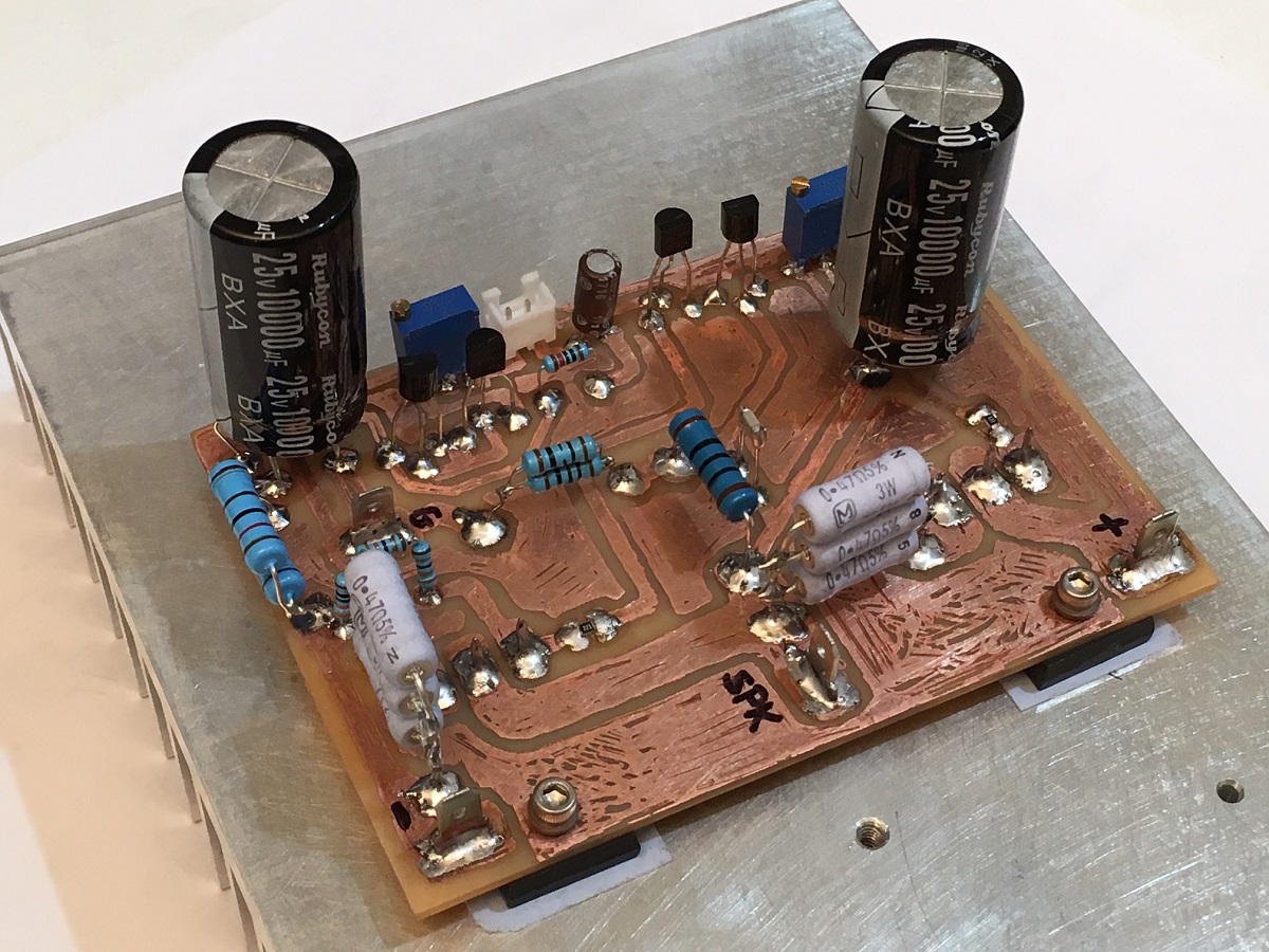

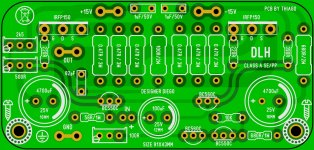

xrk971 DLH Layout
Here is my layout if anyone wants to try it. It conveniently matches the budget phenolic copper faced boards on Aliexpress/eBay (measures 97mm x 70mm).

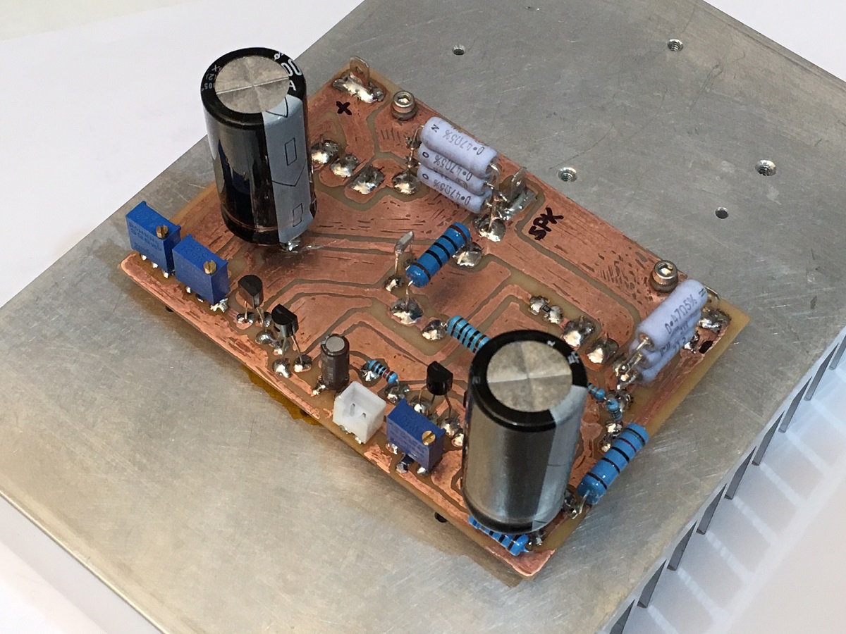

Placement of parts just follow this photo - pretty easy actually. You can also choose to put copper on bottom side like traditional PCB and have through hole parts on top.

I think it's because I miswired the trimpot. I connected the wiper to the upper leg but wiper should not have been connected to upper leg.
If so, it has an easy solution. Anyway, your amplifier has given spectacularly good numbers

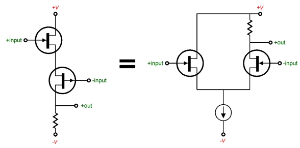

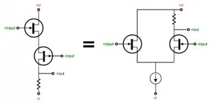

Thanks for the link. I had already seen that page. Broskie has admirable works, although he did not take full advantage of the four (4) terminals of the bastode (like NAD people and others). Those designs are cousins of my design. Mentally they took the bastode and used the same amount of terminals that are normally used in an LTP (only three (3)).
The fourth terminal adds a lot of technical potential to the circuit

Is it possible to change the Output Mosfets to say IRFP264, increase supply voltage for a higher output into 8 ohm loads?
Irfp250, 244, 240, 150, 140.
Are all appropriate.
Irfp264 would still certainly work but maybe not optimally.
Thank you 2 pico... I am just looking at parts which are rated above 250watts to maximize dissipation. What higher voltage would be safe to get about 10-15 watts into an 8 ohm load? Thanks in advance.
I am quite happy running all those devices at 35W each.
20V rails at 1.5A would certainly be ok.
You just need the appropriate heatsinks, and transformer VA rating.
