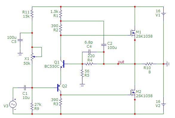

The design premise was to avoid the greatest number of capacitors in the signal path and as part of the feedback network. The effects they cause there are known and demonstrable. The input capacitor cannot be avoided, since it allows the use of the amplifier in a universal way, unless we know the previous circuit.
Given this scenario, there are two options: Single power supply and Dual power supply. Which would we choose?
The answer was found by analyzing the need for very low noise in the absence of a signal. The elements that contribute to the own noise of the amplifier are those of the feedback network, among others.
In the single power supply option, the network resistors are exposed to a voltage of half of the power supply. If, on the other hand, we try to keep Johnson's noise as low as possible, we should set low resistance values for the network. This results in high power dissipations with little signal or even in the absence of signal. If the power sizing is not enough, we will have too much Johnson noise due to the temperature itself than to the resistance itself. This makes it not practicable or economical, to keep the noise level low. As the dissipation in the feedback network is not zero with little or no signal, there will always be an important contribution of noise, either by temperature or by minimum resistance values.
In the dual power supply option, things are very different. With little or no signal, the dissipation of the resistances of the feedback network is negligible. This allows to use relatively low values, with the consequent lower noise of Johnson and with the consequent smaller thermal jump over the one of environment. This maximizes the detail of the sound over the noise itself and help lowering the distortion. When there is a kind of high-signal pulse train, while instantaneous dissipation increases, and therefore temperature, the increasing noise is masked by the signal itself, which is several times higher in level. Masking helps us in this case 😉. Even it would not be unreasonable to use associations of various metal film resistors, so that each receives the lowest possible voltage. The maximum power oversizing is in accordance with keeping the lowest noise possible more than maximum signal excursion requirements.
The current through the pair of input transistors was chosen at 12.5 mA, allowing them to be operated in their most linear zone of the hFE versus Ic curve. This current simultaneously allows to obtain optimal slew rates and high open loop gain.
There is a triple function for the pair of input transistors: as a differential amplifier to correct errors; as cascode, to favor a more extended and linear frequency response (in open loop); as a phase splitter, with greater gain symmetry compared to the unique transistor of Hood design. The Hood splitter bjt transistor suffers from a certain gain asymmetry towards both branches.
The current for the pair of output mosfets that best linearity offers is in the order of 2 A.
All these considerations make the DLH measure and sound as it does 😉.

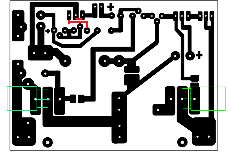

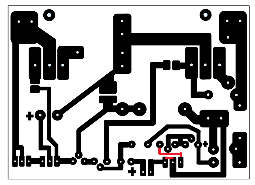

Note that my layout from post 93 has a couple of errors (in red). I will post an updated pdf later, or you can just draw in the fix yourself. Otherwise, the layout has been tested to work as shown below.
I am using just a single 0.22R 3W Panasonic resistor in place of the 0.15R 10W. It doesn't get that hot and the 3W works just fine.

Thanks for the detailed explanation between single and dual rail operation. I am playing with a variant in LTSpice with single rail and it performs very well in simulation for a headphone amplifier. I like cap coupling on the output for headphones for built in dc protection. One neat thing about this amp that reminds me of a Pass M2 in operation is the very slow ramp up of bias current. It starts at zero and slowly comes up over about 45 seconds before stabilizing. If you listen to it while this happens I think you hear the amp going through Class B, then AB, then pure Class A. Kind of neat but main benefit is no turn on/off pop. So a great feature for headphone use. I normally use a cap multiplier to slowly ramp current up in an amp, but here it is not needed.
Very interesting what you say about dual rail amps having lower Johnson noise for same bias current vs single rail. I am not sure I follow why still? Dissipation is the same in the resistors - all we did was change where 0v is referenced.

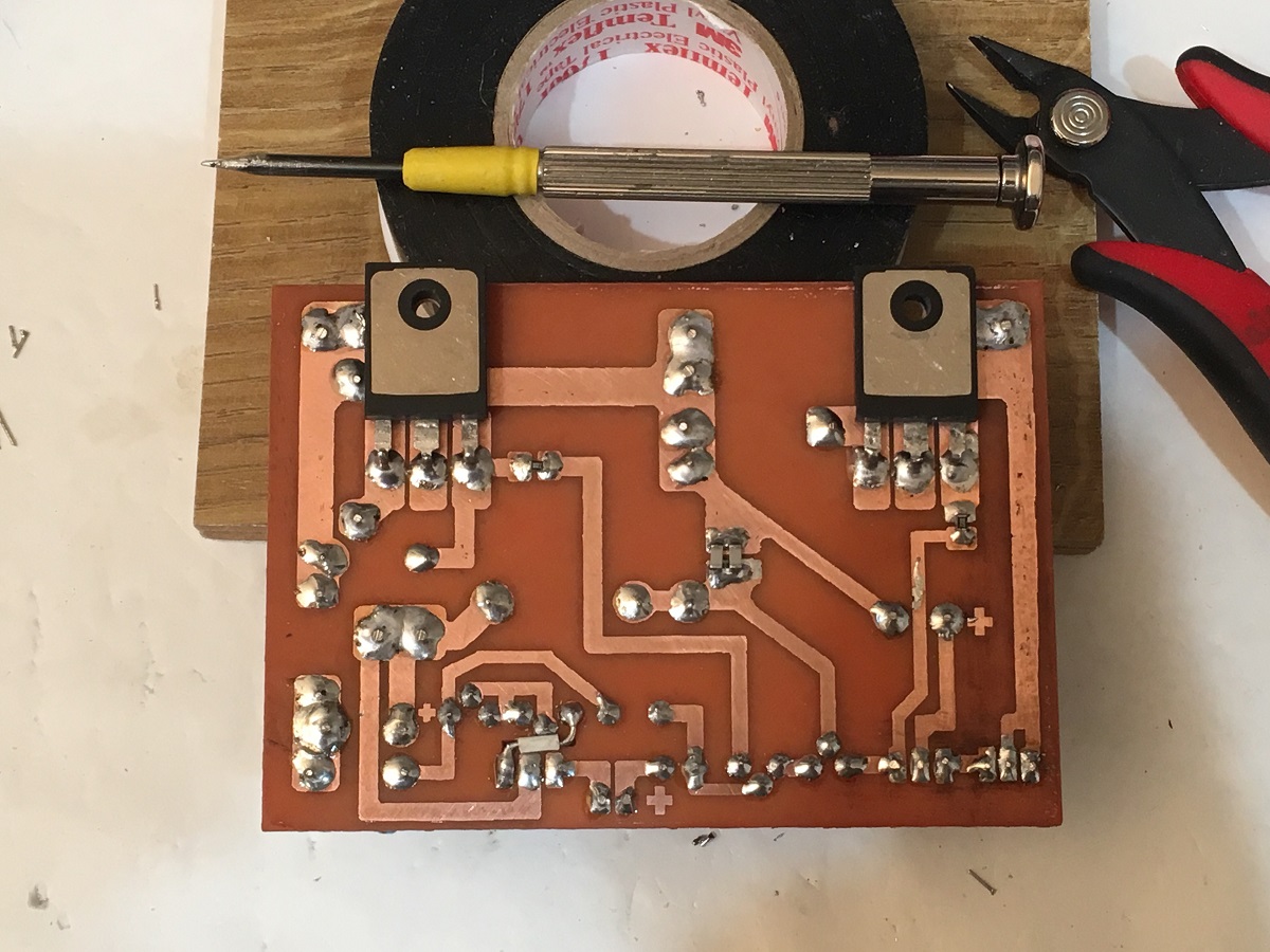

Using Sharpie to trace PCB
To understand what I explained, imagine two networks similar to the feedback network of this same amplifier. Each of the two networks will consist of two resistors of 100 ohms and 56 ohms, respectively. The maximum power specification of the resistors will be 2 W for the 100 ohm and 1 W for the 56 ohm, respectively.
With dual power supply, the network will receive peaks of up to + - 8 V, due to the output signal. In the absence of a signal, the network receives a negligible voltage.
With single power supply, the network will receive positive peaks of up to 23.67 V (ground reference) and negative peaks of up to 7.67 V (ground reference), due to the output signal. In addition, we will have on the network an average value of 15.67 V, due to the imposed condition of not having capacitors in the feedback network. In the absence of a signal, the network receives a voltage of 15.67 V.
It is evident that without signal applied, one network will develop heat, while the other network will not. While the temperature of one of the networks is similar to that of the environment, the other could be at a much higher temperature.
Although the resistances of both networks are similar both in value and physically, they are not exposed to the same operating temperature with or without signal.
I hope this helps to clarify everything.

Hi Myles,
Only black color Sharpie works. I tried blue thinking it's all the same - it's not. Use it for 30 to 60 seconds at a time and replace cap to let it recharge otherwise it dries out. Color until you see no copper. Usually one layer and touch up bare spots. You can't really add second layer as fresh ink dissolves first layer and it's a mess. You can also use nail polish or even kids acrylic paint - it needs to be acid resistant for circa 5min to 20min depending on how strong your etchant is. I use muriatic (HCl) from hardware store aka "sidewalk cleaner" and drugstore hydrogen peroxide for cleaning wounds. About 1 part HCl and 2 parts peroxide. Use a small plastic spoon to stir acid solution constantly to have it etch evenly.
It's not as neat as laser printer transfer but sure is fun and fast. If you take care and use sharp razor to clean up Sharpie mask before etching it can look very neat. No undercut etching if timed properly. Don't leave in acid too long and stir solution constantly.

Thanks for explaining this. I have LTSpice sims of dual rail and single rail amps and it's easy to check DC dissipation of resistors. I never noticed the single rail amps being hotter on feedback resistors - but makes sense since it sits at half-rail. Your amp has very low self noise indeed. With no music playing the output measures 0.0mV AC on my Fluke 101. Few speaker amps can claim that.

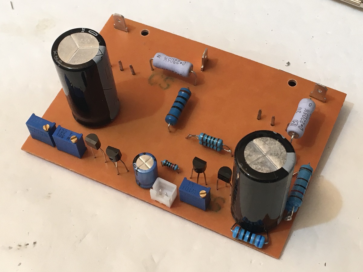

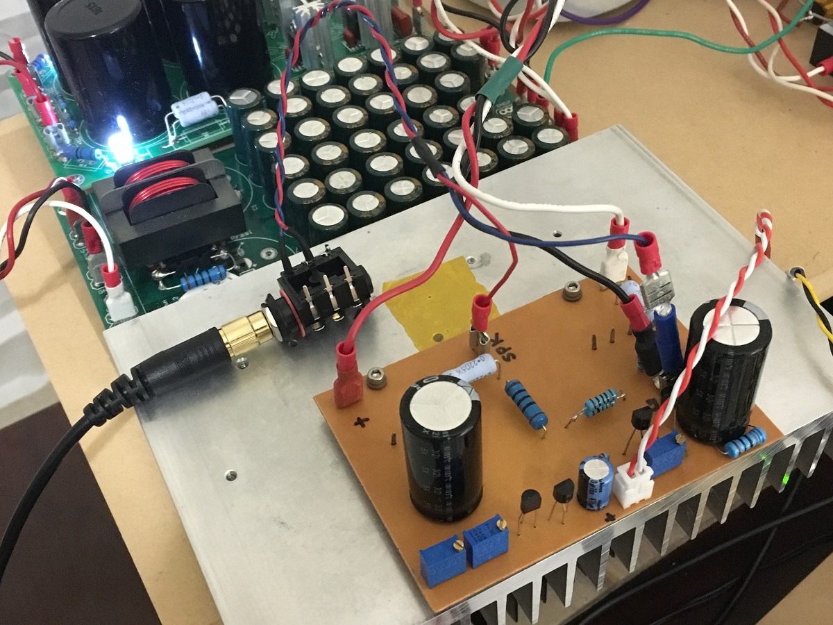

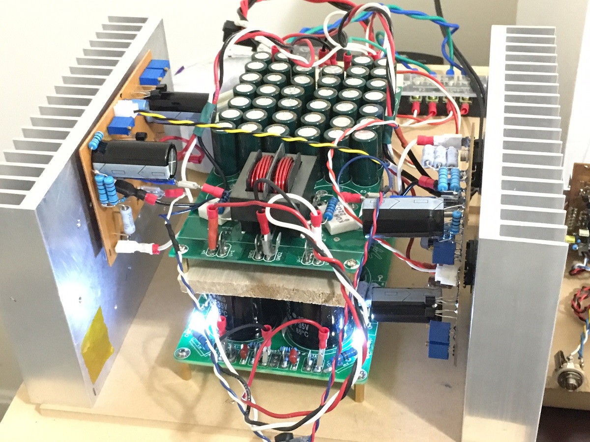

In Stereo finally. Just listening to headphones at present. Very nice SE Class A sound.
X,
Neat work. 🙂
Running at lower power for head phones or with the higher voltage power supply option you referred to earlier?
Running +/-15v rails and 1.2amp bias. Cooking pretty hot but amazingly, the 100VA Antek AS-1015 is able to handle the whole stereo amp.
Wouldn't it be appropriate to place the thermal compensation transistors in close contact with the phase splitters? The amplifier has a DC gain of about 2,75 and with ca. 2mV/K VBE temperature coefficient the output could exhibit some unacceptable thermal drift. Especially if used with headphones.With no music playing the output measures 0.0mV AC on my Fluke 101.

Once warmed up the drift was only +/-25mV so not a problem but headphones was not my main use. Just testing for sound quality. Nothing beats a pair of high sensitivity headphones to ensure noise and hum are not a problem. Also, headphones don't have room effects so are more revealing of true sound signature of amp. For headphone use, I am making a single rail with cap coupled output. Much smaller and using all SMT.
