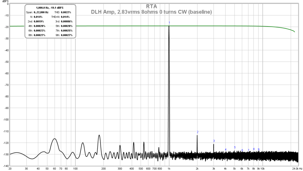

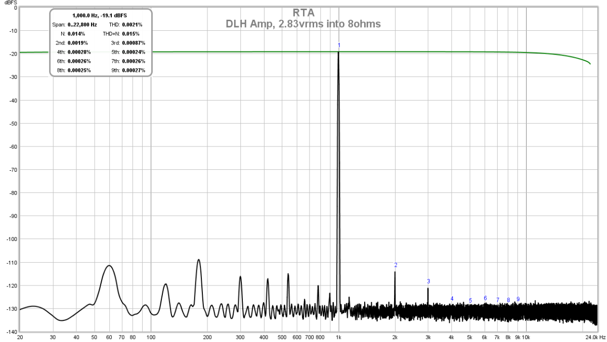

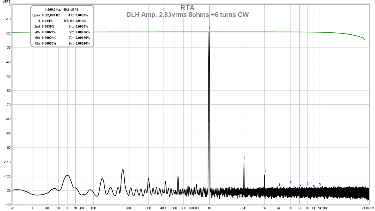

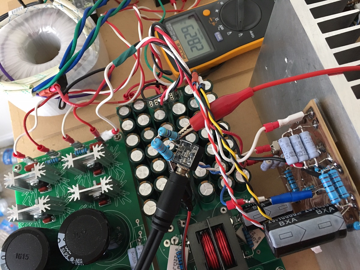

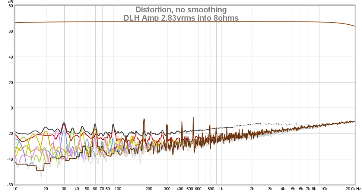

You will be pleased to hear that your amp is a brilliant performer! I set it up to drive an 8.00 ohm (4.7R + 3.3R 1% metal thin film resistors in series) load at 2.83V RMS (as measured with Fluke 101), and measured through a 1:10 resisitive divider (2k2 and 20k resistors) and measured with the ADC on my Focusrite Solo sound interface.
THD is 0.0021% with H2 at 0.0019% and H3 at 0.00087% and nothing else. Noise floor is very quiet. Most of the noise below 1khz is my linear power supply ripple and harmonics getting through. Noise floor is at limit of my measurement device ~-130dB. Signal only shows -20dB due to the 1:10 divider to protect the input preamps on the ADC:
The frequency sweep is also excellent, showing a mild rise of 9dB in THD with increasing frequency from 1kHz to 10kHz:
Overall, an excellent measuring amp and you should be proud of it!
Thanks for the super amp design.
X
p.s., when I have time, it will be VERY interesting to see the FFT in real time as I adjust that SE/PP pot! 😀 Measurement above with the pot set at the recommended level on the schematic.

Wow 😱😱😱!!!. How impressed I am with the perfect work you've done!
Wow wow wow 😱😱😱!!! Still more impressed with the results of the measurements!
Probably, the 500 ohm trimpot is not yet in position to get the lowest possible distortion !!!.
Congratulations and again thanks for all your great work !!! 😉🙂.
My ears prefer a little H2 and maybe a tiny bit H3 - very much like what is here already. Probably even a tad more H2 would be preferred in blind listening tests. However, to each his own, and perhaps that's what is nice about this amp: adjustable "sweetness" knob. 😀

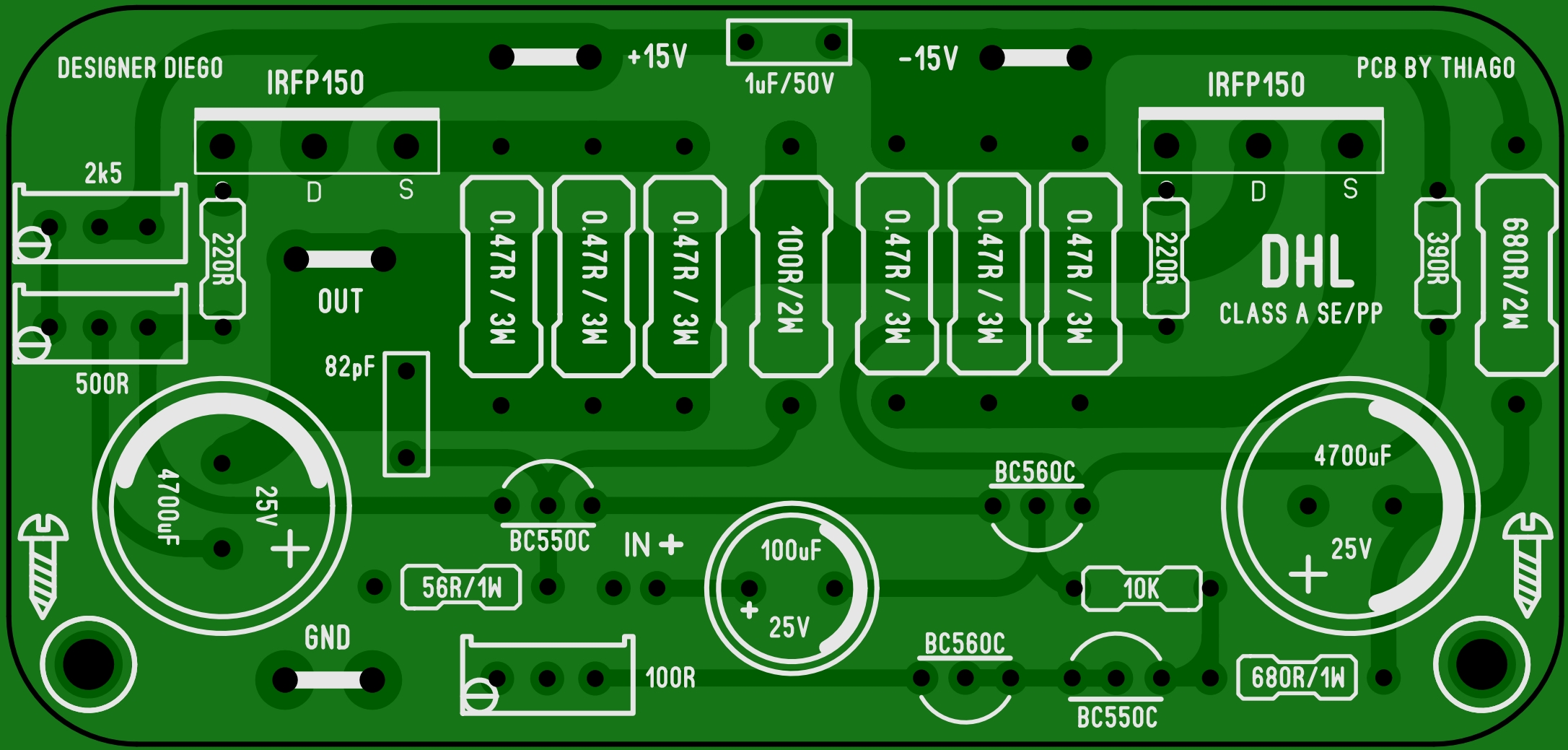

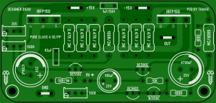

Very nice Thiago. I don't know how necessary they are, but I added 220R gate stoppers on the MOSFETs.
I am listening in pseudo stereo (one amp to both ears) with my 55ohm OB-1 headphones now, and must say, this is an excellent headphone amp as well. Absolutely quiet - no hum, hiss, or otherwise noise. Great powerful bass and super dynamics. Very transparent and revealing. Very few speaker amps are quiet enough to be headphone amps. At least I know my PSU and grounding is good.

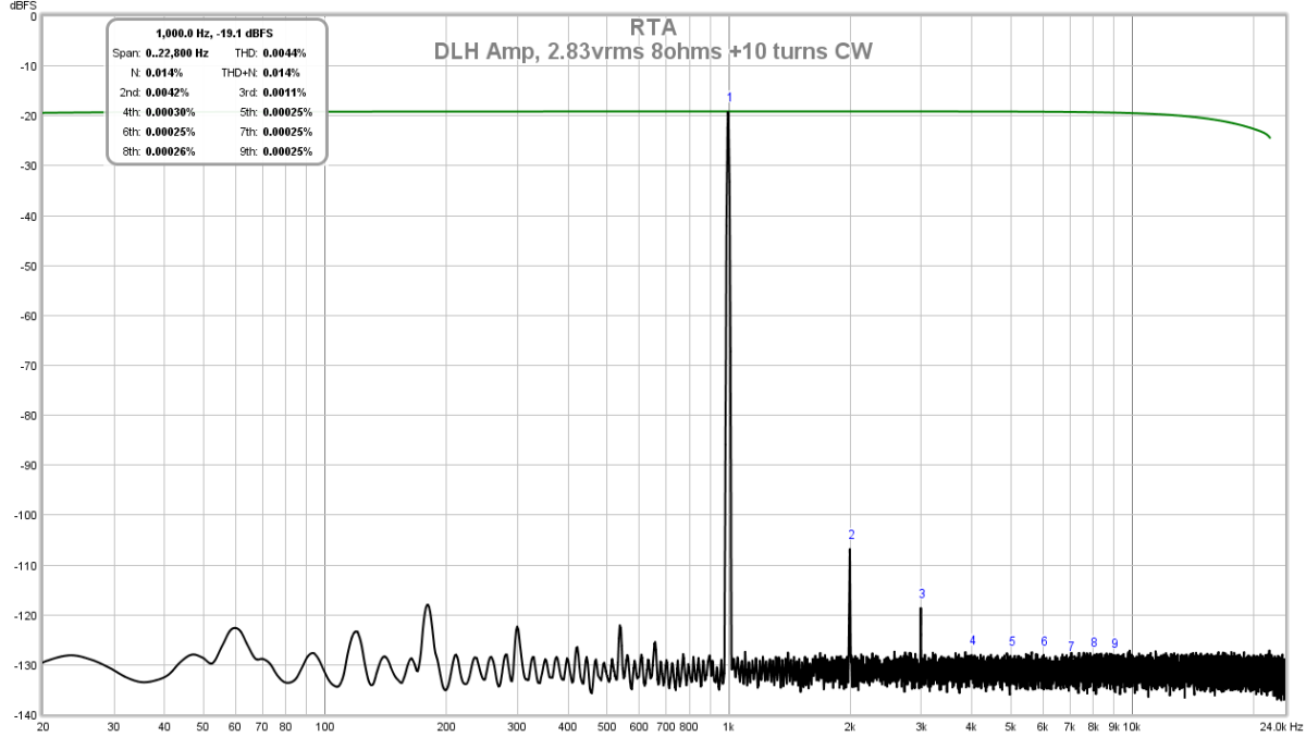

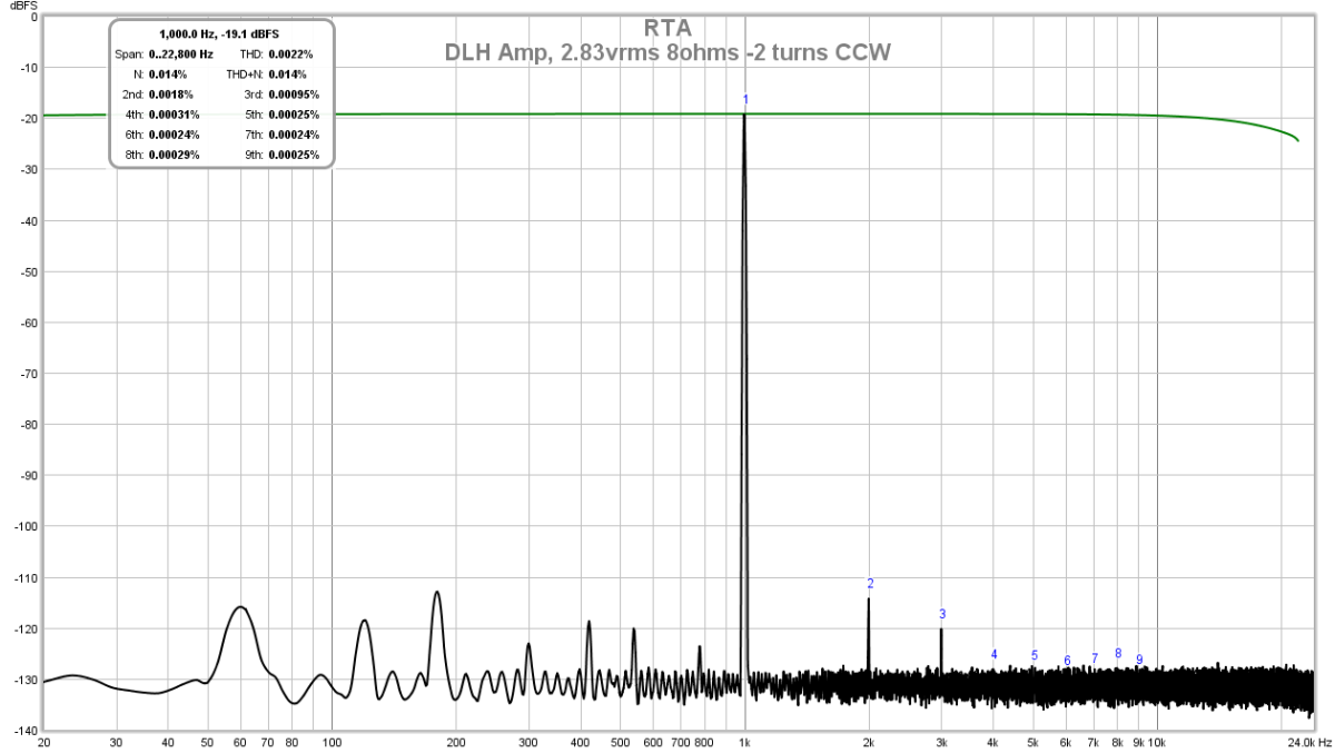

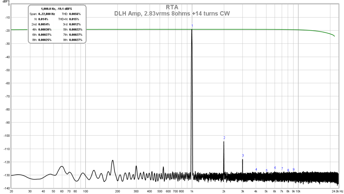

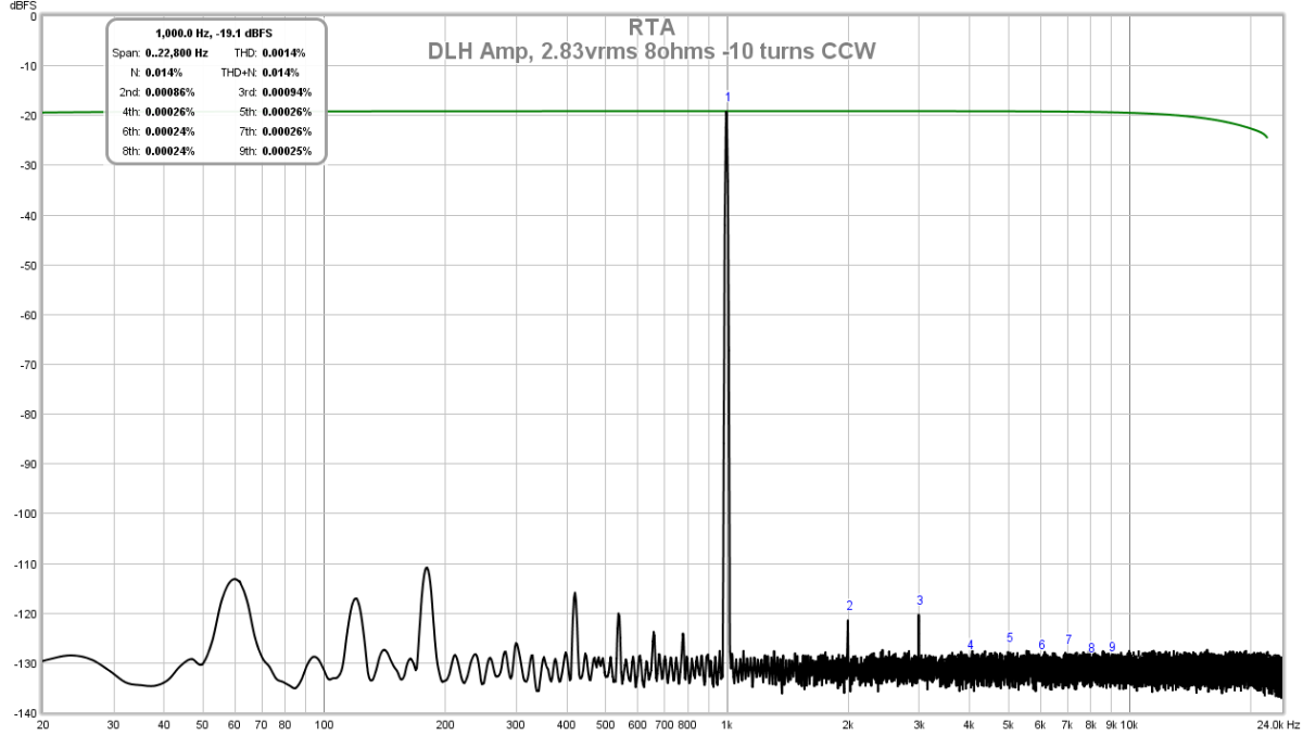

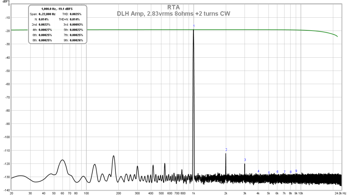

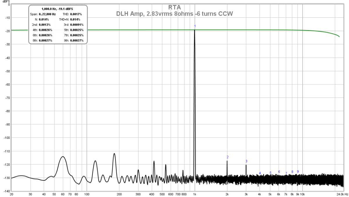

Effect of adjusting the SE/PP distortion pot
The amp does indeed have a variable harmonic distortion profile adjustment knob. Turning the pot clockwise (CW) tends towards higher H2 (and higher overall THD) and less relative H3 for a more "SE" profile, and turning it (CCW) tends towards lower THD and more H3 relative to H2 for a more "Push-Pull" profile. At one point, the H3 will even be higher than the H2. I took data at various positions relative to the baseline setting (51% of the 500R pot). At some point, I accidentally started counting half revolutions, so don't hold me to it. 🙂 But, you get the idea. I will try listening at the SE mode more as that is my preference.
Starting at the SE end (CW) of the spectrum and going to the PP end (CCW), we get the following progression for 2.83vrms into 8ohms:
So there you have it, dial-a-yield "sweetness" vs "bite" knob. 🙂

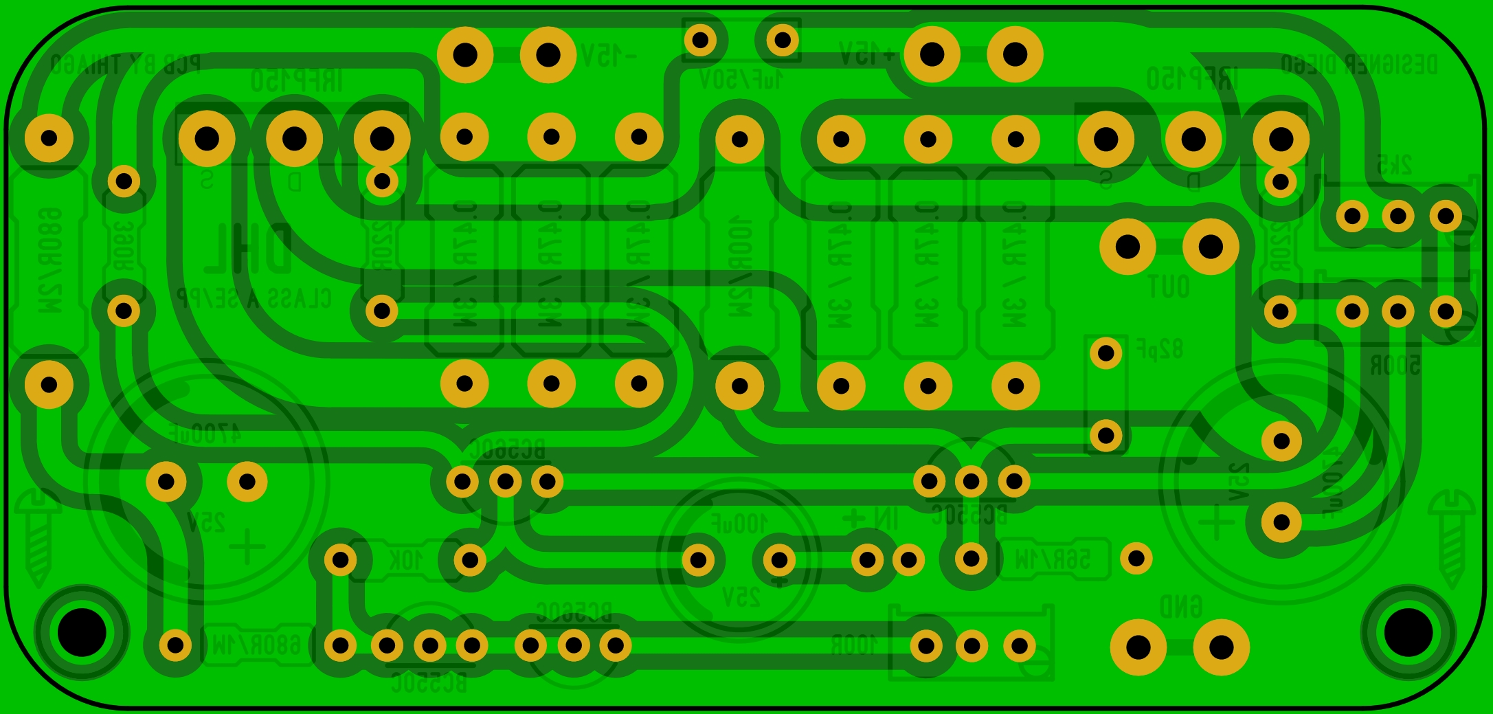

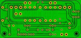

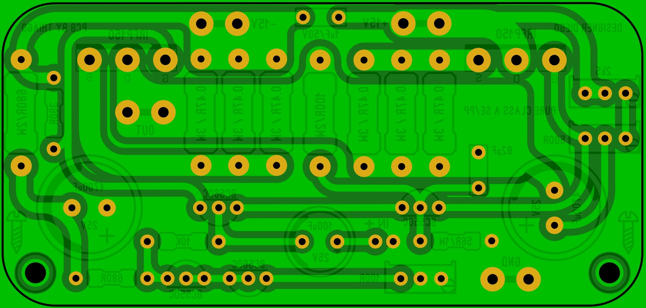

91x43mm
Hugh is correct,
Very nice Thiago! 🙂 Can we please have the (mirror image) pdf's & Gerbers? What are the board dimensions?

noticed that you have "DHL" instead of DLH
Just make the PCB with yellow solder mask and red silkscreen! 😀
