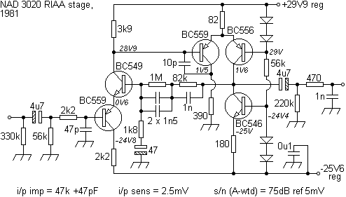

Here the circuit of the NAD 3020. It is a real shame that they have not taken advantage of the collector terminal of the BC559 (corresponding to the series LTP) . In that way, perhaps they could have used only four transistors.
The only thing in the NAD 3020 that resembles to my circuit is that it uses series LTP, too. In my humble opinion, the full potential of that input circuit has been wasted.

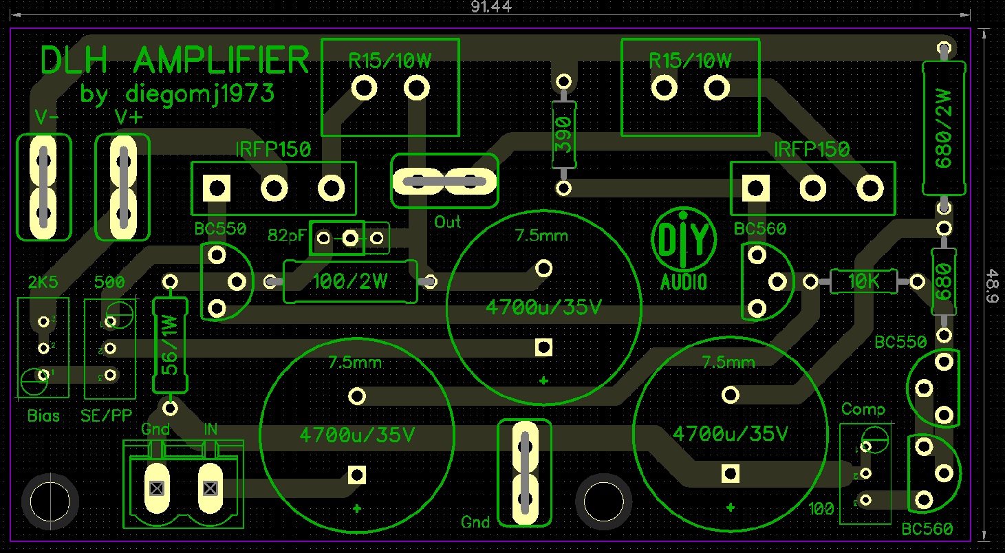

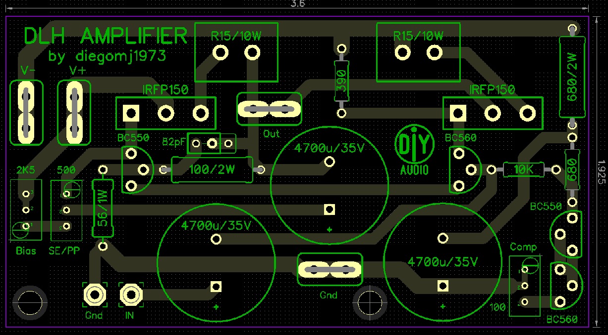

After having built the ESP P113 to use for my small bench speakers, and loving the sound by the way, I'm drawn to low power amps with nice performance. I put together a pcb for the DHL amp and was hoping someone could look it over. Thanks.
Sorry, I like this one better.
Exceptional work!!!. It only remains to build it and verify that everything works as it should. Once again, thank you very much for your great effort.
Remember that it is an amplifier that operates quite hot. Mosfets should be mounted on a generous heat sink.
All my respects

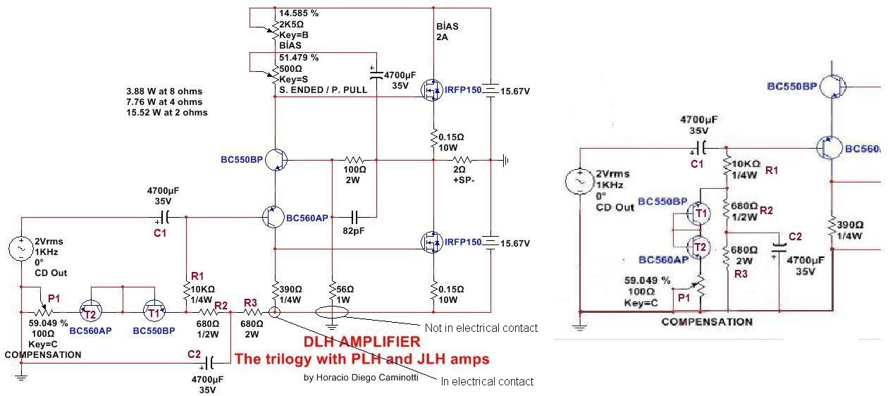

The compensation circuit schematic on right is not equivalent to the one on the main circuit on left. R3 does not go to ground in the one on left but does on the right one. And 390R does not go to ground on left but negative rail.
Which one is correct? I assume the one on left since made by OP.
Also why is C1 4700uF? For sufficient bass extension down to 1.6Hz for 10k R1 only a small 10uF is needed. Unless the impedance through the base of the BC560 is like in the single ohms?

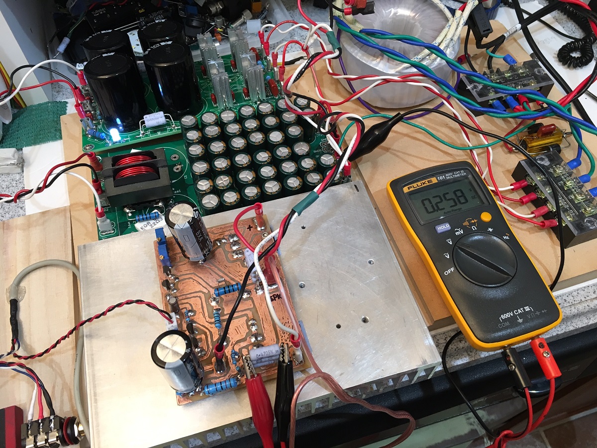

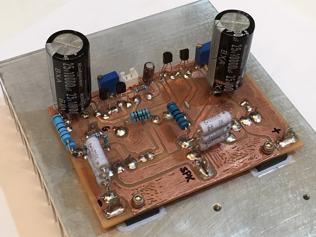

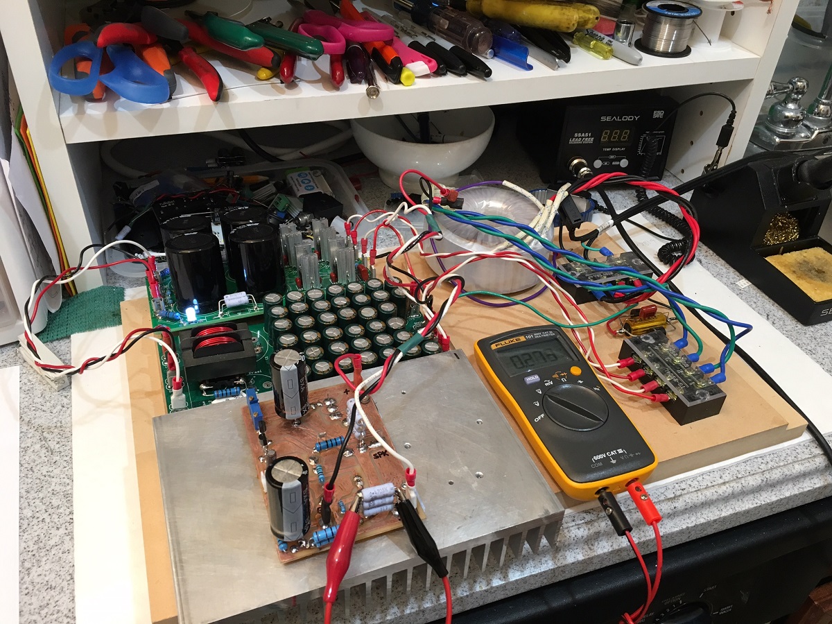

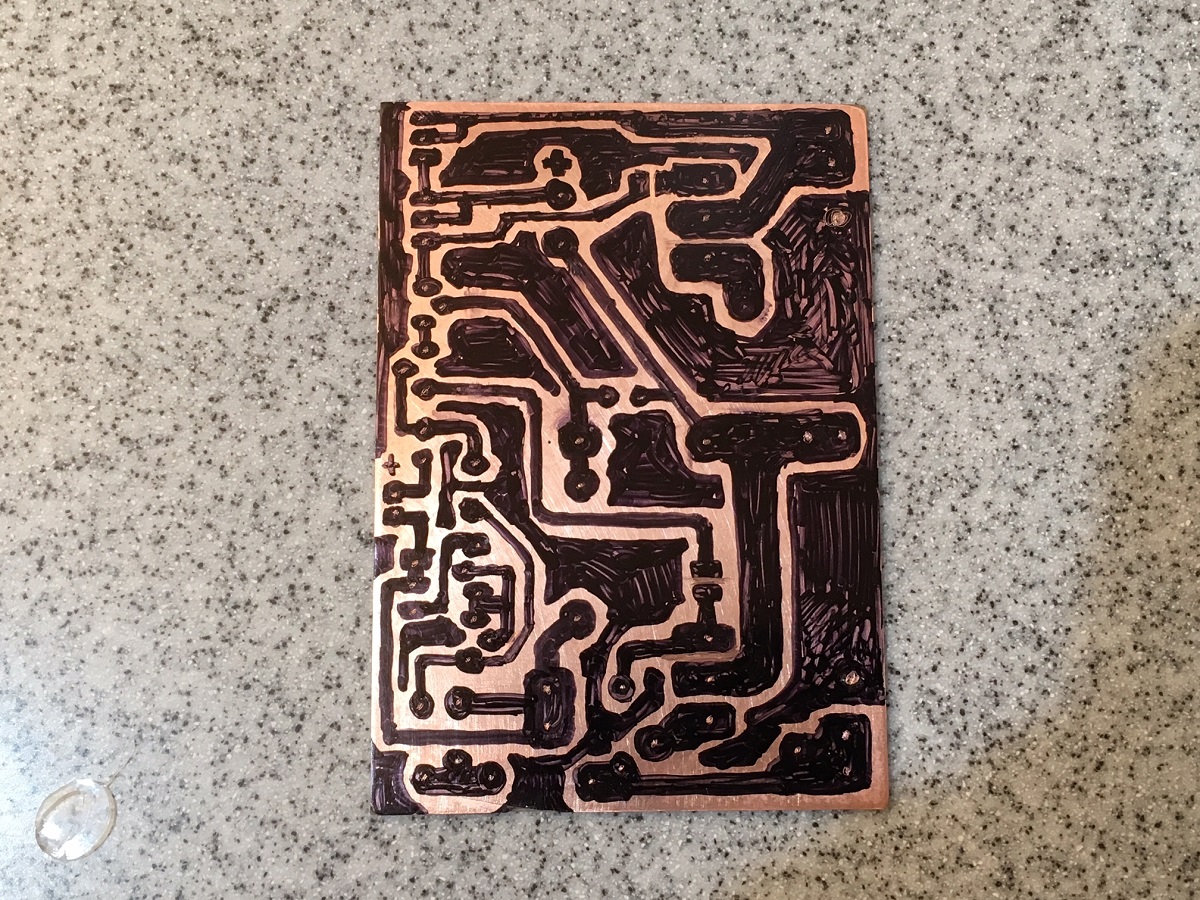

I had some time and am a sucker for simple Class A amps, especially quasi amps with singleton input stage. 🙂
So using a Sharpie marker, I laid out the circuit on el cheapo copper faced phenolic board (using the schematic from Post #25, schematic on the left, not the revised compensation):
After a quick etch in HCl/H2O2 for 20 minutes, I built it up. A couple of mods: I added 220R gate stoppers in front of the MOSFET gates, and switched to a 10uF 35v Silmic II for C1 (could not see the sense of a 4700uF there). I am also using readily available "10,000uF 25v" caps (measure at 6000uF) for the other two caps. Using a 88pF NP0 cap soldered from 3 SMT caps. Also, using IRFP240 vs 150's. So here is the built up amp:
Now testing the amp with a linear PSU nominal 15VAC (20VDC rails no load) from 100VA trafo. Under load rails are 15.5v. Bias is very adjustable - came on at 3.8amps and I adjusted down to 1.8amps. Offset adjusts nicely with good range and resolution. Offset affects bias and vice versa so it is an iterative process. I do not have a sufficiently large heatsink at present so testing for limited time with smaller ones here:
Then hooked up my XKi speaker with dual PA130-8's in 4ohm nominal (95dB at 2.83v) and used my iPhone as source. It sings! Sounds really nice - good tonal balance and has some good foot tapping dynamics and rythm. With the CRC Class A PSU from GB led by Prasi, and a cap array, the amp is dead silent even with 95dB sensitive speakers (no hum or audible hiss). So only listening in mono, but this amp is nice and deserves a second channel for stereo.
The schematic is now verified to work and the amp sounds very nice. Great job Diegomj1973 - thanks!
X
P.S., I did not get to play with the trimpot that adjusts between SE and PP yet - looking forward to that. Adjustable harmonic profile is very cool to have.
X
Congratulations, X!!
Those caps are oversized because LTSpice then drives the noise floor down, revealing all the harmonics which ordinarily lie below the noise line, a quirk of the spice engine. Incredibly fast work, take a bow!
Diego,
This is a very good circuit, and now X has revealed that it sounds very good...... I know why this is happening; this has a monotonic linear reducing harmonic profile, and the ear sees this a 'natural'. Even if H2 were high at -66dB, such a profile would sound very good regardless high THD. As it happens, this has LOW THD as well.
