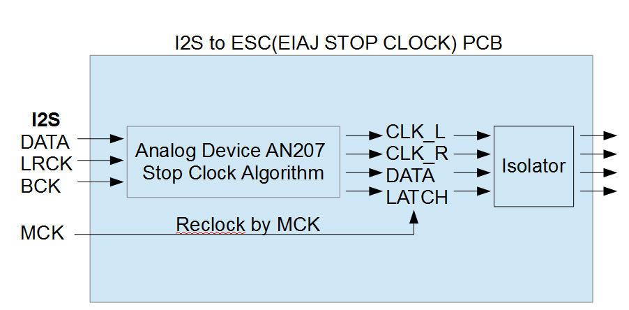

I2S to ESC (EIAJ STOP CLOCK) PCB to R2R DAC with schematic
Dear all friend,
I am playing on the famous AN207 stop clock operation,
To verify it's work like it should be.

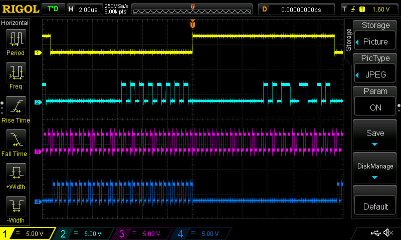

I compose an i2s data stream to test
The left channel is 16bit 1010101010101010
the right channel is 16bit 1010110011001010
the timing from the oscillscope looks perfect,
There are BCK after the WCK go low latch signal.
it should meets the PCM1704 stopped clock operation requirement
Let me test it on as more R2R DAC as before release

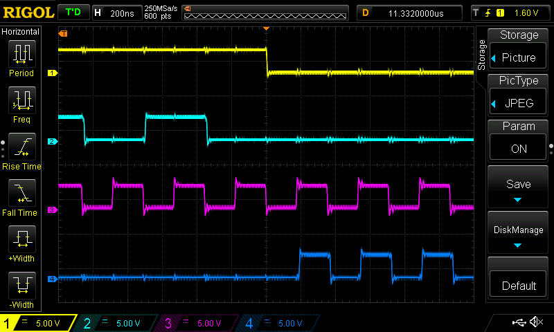

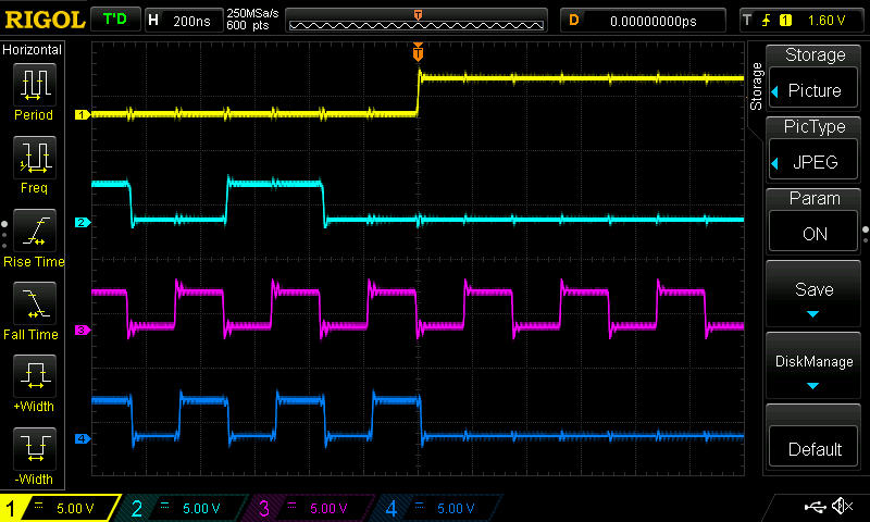

Yellow: LATCH for left and right DAC
Cyan: DATA for left and right DAC
Purple: Right clock
Blue: Left clock
The original design uses NAND gate, the left clock has ~20ns delay to the right clock when using 74HC logic, it can be read from the above oscilloscope capture.
R2R IC like AD1856 is output on the falling edge of latch signal, not based on BCK, this delay will not causes problem. For PCM1704, the output is on the second bck following the latch signal, the delay on the left and right clock will causes 20ns different on the left and right channel, it's smaller than 1/100 phase different even at 384khz sample rate, although I doubt it is listenable, but there is never an enough for people in here. The design is just revised to sync the left right clock and eliminated the nano second level output delay.

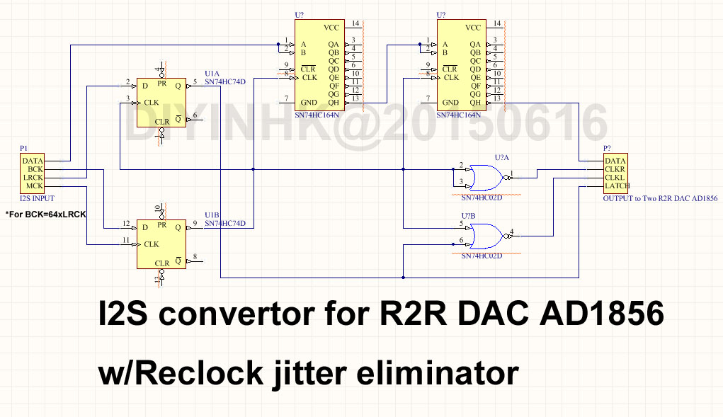

DONE!
Welcome to build and try yourself!
The schematic is free for personal use!
The serious shortcoming of the original AN207 is it do not has reclock and it assumes BCK=32xLRCK from the i2s source. But nowadays, all I2S source is BCK=64xLRCK.
The below circuit is not only verified by ear and it is also verified by oscilloscope using a composed i2s data stream to guarantee the output is bit perfect and jitter free. The information for how to compose an i2s stream can be found here.
