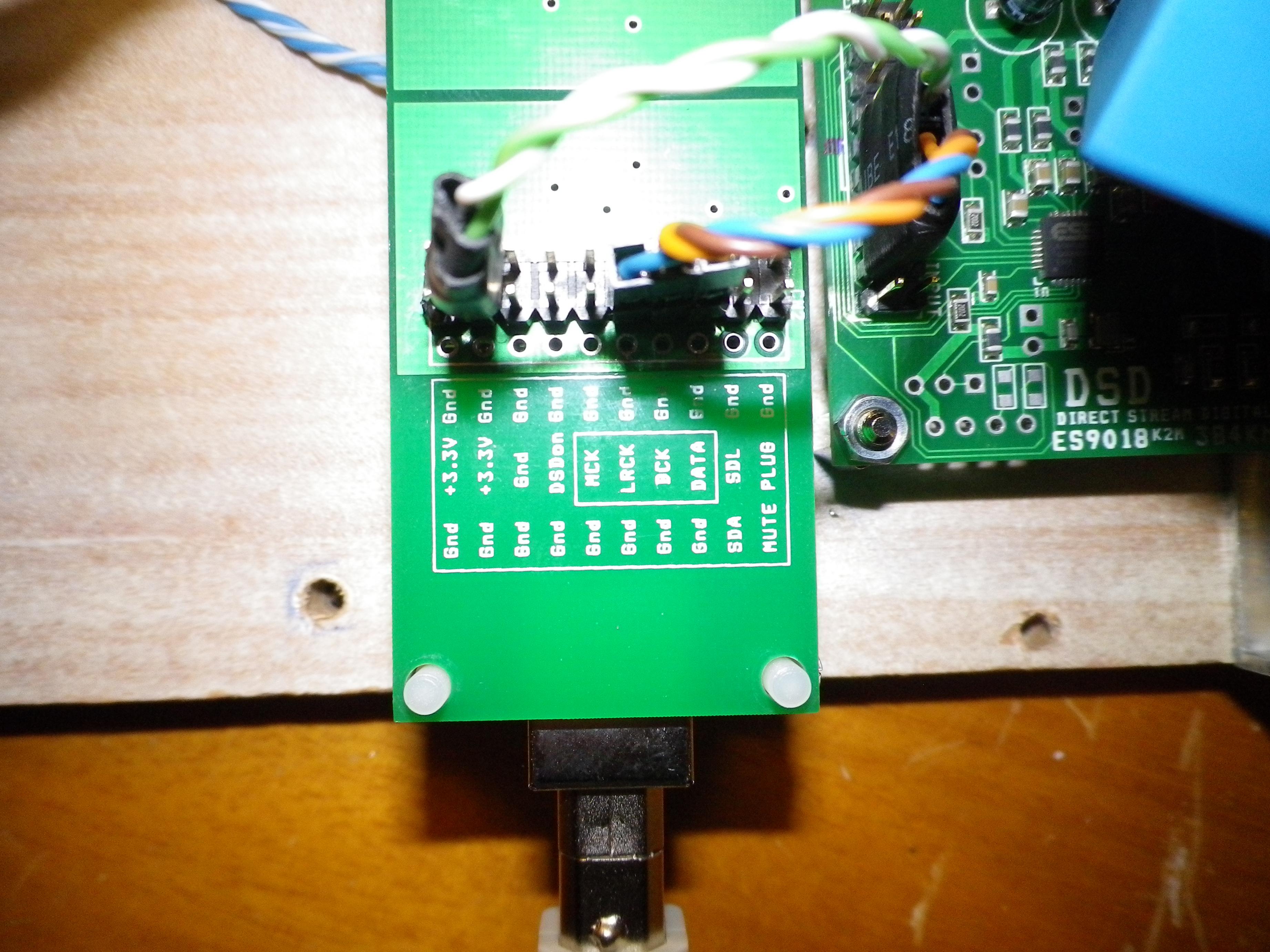

Just a word in case you feel like adding an external controller such as an Arduino later.
The bundled Xmos usb interface controls the digital volume in the DAC through the I2C bus (it uses the s/w volume control in your computer). If you wish to use an external controller for volume contro (such as using an Arduino), then you will have to purchase an Xmos interface that does not use the I2C bus such as this:

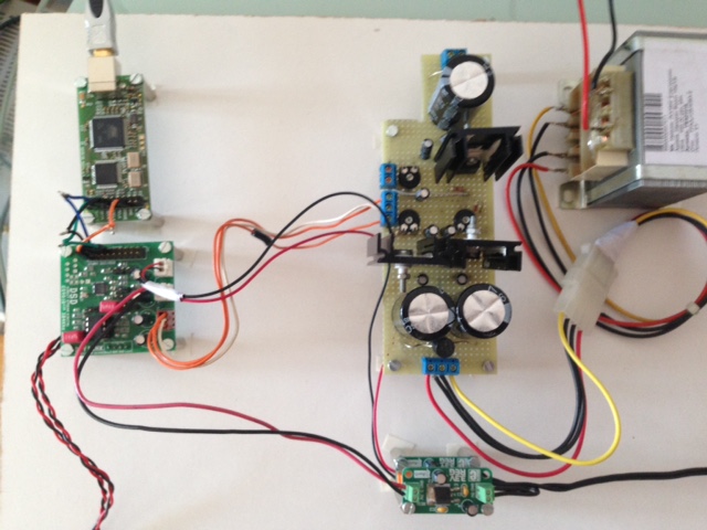

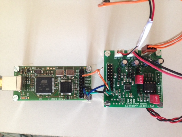

Need help in connecting Amanero USB->I2S output to ES9018 K2M DAC (diyinhk) I2S input.
What are the correct pin to pin connections ?
Amanero - 9018K2M
FSCLK- LRCK/D1
CLK-BCK
DATA -DATA/D2
I have make this dac with 3 d-Reflector 3.3V Analog - 3.3V Digital - 5.0.V for Amanero and one Bib for 12V +/- for opamp.
Also need at output capacitor 10uf to zero dc offset 0.1mv and LPF filter to clean the output. Value for money this Dac .
No clicks, no pops, ready to run always .DSD 128 ,256 Flac 384 ALL FINE AND THE SOUND EXCELLENT.
Use sepate secondaries from transformer for eatch voltage supply 3.3Digital 3.3V Analog , 5.0V Amanero ,+/- 12V for opamp.
Also if you have old computer with XP Windows use the 1.56 driver for Amanero for clean volume for Foobar.
Thank you nikosokey,
got it running. Sounds fine, from the dac using opamp. Want to further upgrade with Broskie Cathode follower for diff. outputs and not use opamp at all. Need to upgrade the better power supply for 3.3V.
Use Amanero with Jriver and Win 8.1 and no volume control so far. Must explore further.
Thanks again.

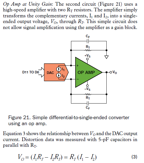

The older board (with LDOs) use a simple differential opamp stage, this is voltage mode.
The newer (without LDOs) is the same as described in my latest post.
The XMos is fed from USB power via low noise LDO (I think).
View attachment 463676I think DIYINHK use similar like attached I/V stage.
This is the most simple solution for SE output.
The I/V on the ESS eval board is balanced, with single opa's (AD797).
Each opa for + and - side. The third opa is a bal/SE "converter".
