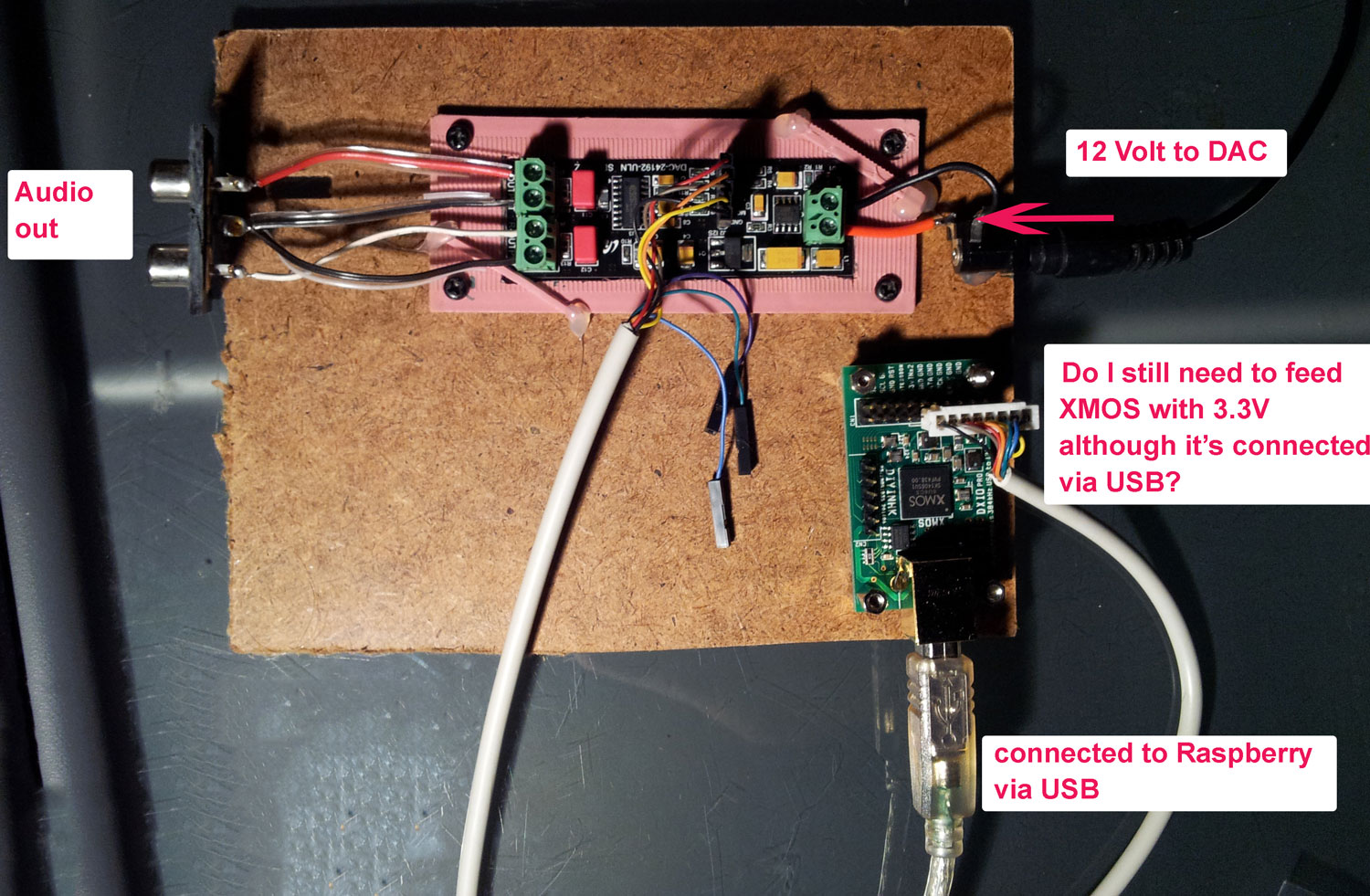

If you want use Xmos module alone, than you need some power supply.
If you will use it together with DAC, Xmos is taking voltage from DAC board
over connector CN1 - look here

Hallo,
I also dared to build a RasPI + XMOS + DAC combination, without much luck though😕
First of all, thank you very much for the instructions in the former posts. So far I figured out how the parts are connected together.
  • I’ve bought a DIYINHK XMOS USB DSD DXD 384k and a sellarzaudio DAC-24192-ULN,
  • connected both via I2S and fed this combo to RasPi via USB. Hope this was right.
  • fed the DAC with 12 V and
  • I assumed that XMOS will be fed via USB but nothing happens when I power everything on.
Do you think I still have to feed XMOS with 3.3V?
Thank you for your support
