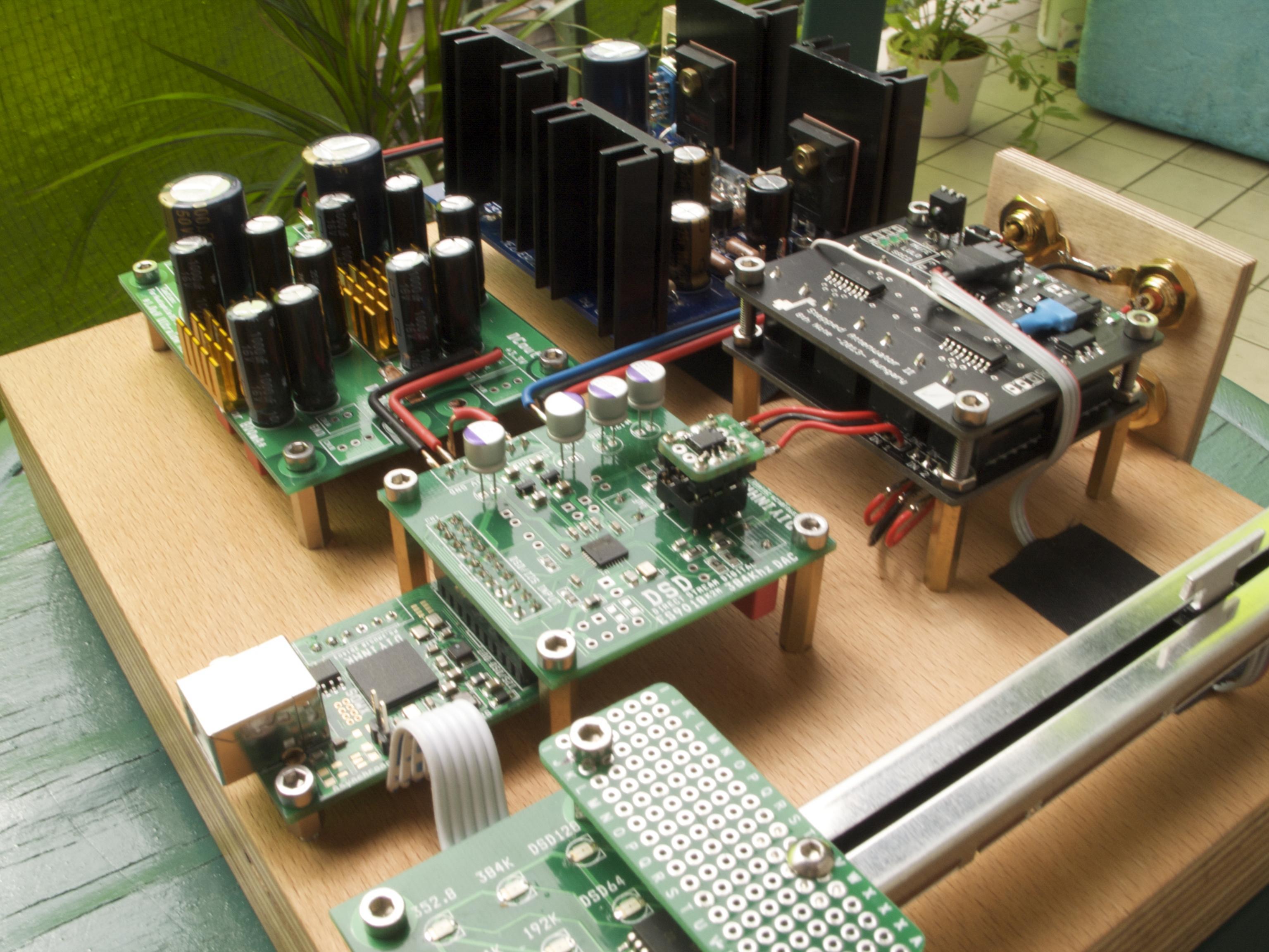

It sounds pretty good:

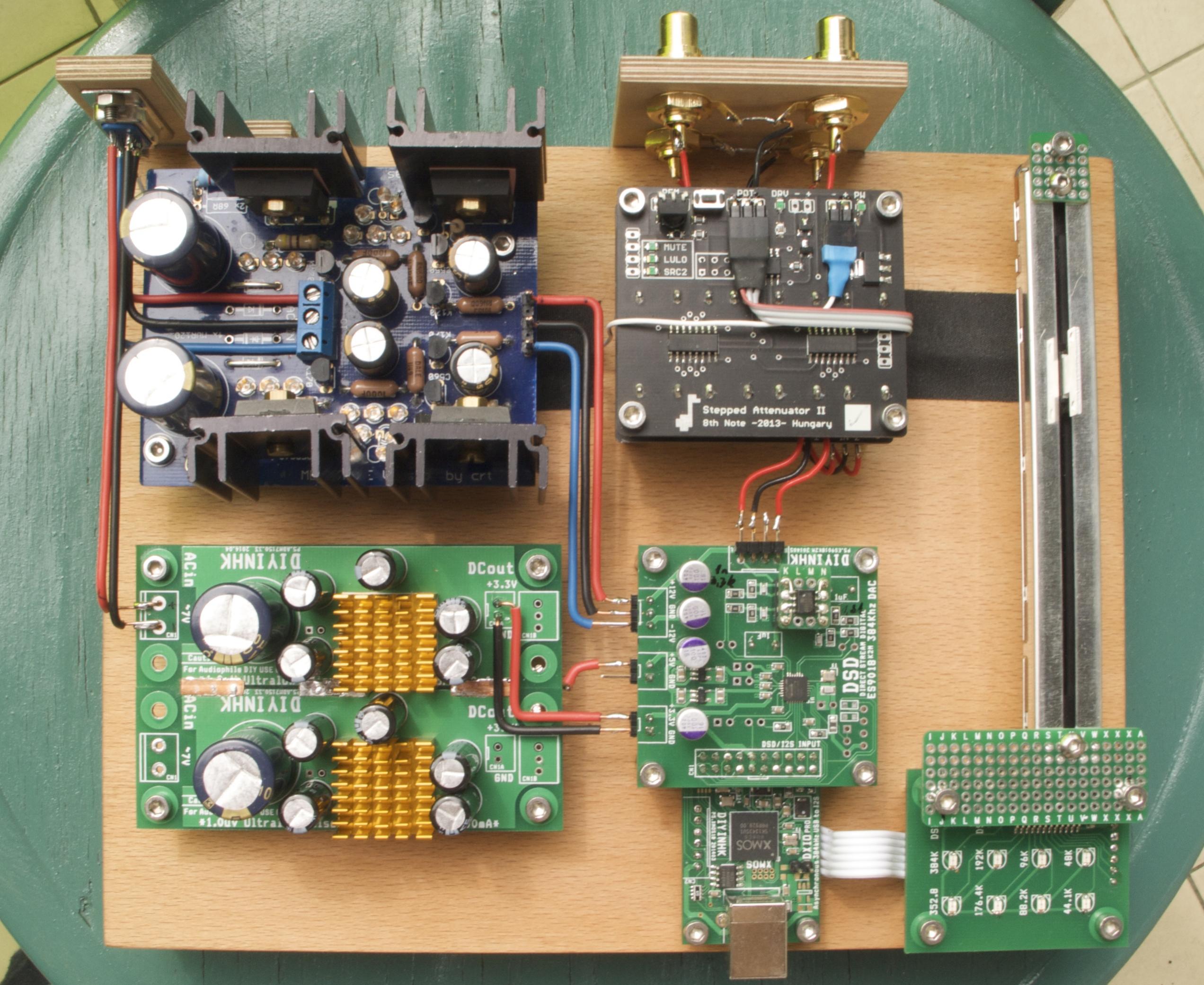

Very nice work! 🙂 What is the board near to RCA outputs? Do DSD 128 files play?
But I want to use this DAC without USB board, connected direct to i2s output of Rpi (3 wire). I can do that?
The black board is a stepped attenuator with small signal relays.
8th note - Stepped attenuator details page
I don't have dsd 128 files, but it works fine with dsd 64.
I can't answer your question, because i haven't tried it with Rpi. If the Rpi has i2s output, it will work, I think.
OK, thanks!
Why dont you use a bit-perfect volume attenuator in DAC?
LME49880 or LM4562HA, the 49880 sounds softer.

I removed the analog volume control panel, and I use the built in digital (bit-perfect?) volume control. It sounds much better now. It's awesome.
I use a macbook with audirvana player, it works flawlessly with the Diyinhk USB.
I listened a lots of dsd dac in my system, like Mytek, M2tech Young dsd, Northstar, Audio gd. This is my favorite so far.

Nice build!
Very important thing, is to check for oscilations, belive me SEPC caps can ring like Notre Dame bell. Also, consider changing them, they are not the best in analog power supply 🙂
