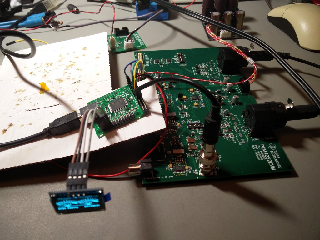

I've had this board for a few days now and it looks like it delivers. I've used it under Windows 10 to output stereo sound to a DAC as well as input sound from an ADC (PCM4222 EVM).
I made a little video of the board in action, connected to the OLED display.
https://www.youtube.com/watch?v=rwg9Qhb8AIg
Keep in mind that under Windows 10 it will only work in stereo (with DIYINHK's XMOS driver (v3.20)).
Also, if you want to use it with an ADC, you will need to slave the ADC to the XMOS.

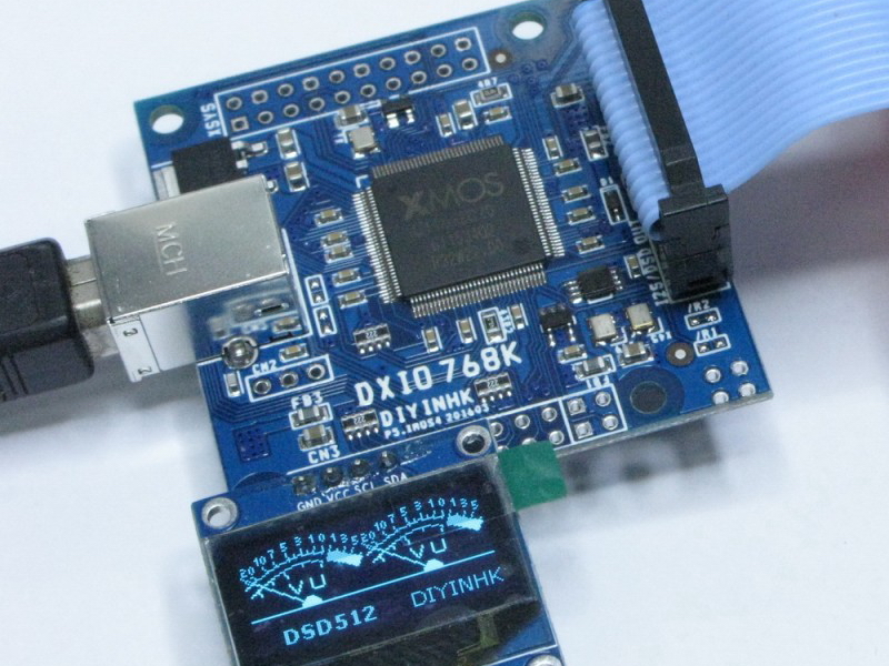

New USB to I2S 768Khz - DSD512/1024* Converter
Are you kidding? World's first 768k usb to i2s convertor from Hong Kong?
It's based on xmos, so it's from UK😀
Why do I need this 768k PCB? I do not have 768K music file to playback!
There are many technical advantage with this 768k PCB even when playback lower sampling rate music file:
1)The latest xmos xCORE-200 includes unique hardware divider and it is used to generate bit-clock from master clock directly.
2) The Xmos used in this pcb is XU216 2000MIPS and it contains two tile. It is equal to two XU208 combined in one chip, one dedicated tile is used for the USB data and the other tile is dedicated to process the audio data to the DAC.
3) This PCB uses linear regulator and it do not have onchip/onboard DC-DC switching converter. Thus it is power hungry:- 800mA maximum, 400mA typical (due to the use of all linear regulator) but it should also favour many people who do not like to use DC-DC convertor.
4) The xmos in this PCB is clocked directly from 45.158Mhz and 49.152Mhz audio oscillator, the timing and jitter can be better than those PCB uses 22.5792MHz 24.576Mhz audio oscillator as much as two time theoretically.
How do I test it is real 768K PCM is playing? I do not have 768k file!
User can download our computer generated precision pure 768Khz PCM test tone file to test(it is not recording from analog and thus zero background noise is achieved).
http://www.diyinhk.com/support/L1kR2kPCM768k24bit.rar
If the player/foobar setting is correct, user can measure LRCK=768kHz with an oscilloscope and DAC Left channel=1Khz, Right channel=2Khz sine wave output
AK4490 and AK4495 in hardware parallel control mode can playback 768K PCM immediately.
*DSD512 support in native mode (for windows requires >=v3.34 driver version) and DSD1024 theoretically work in laboratory test condition.

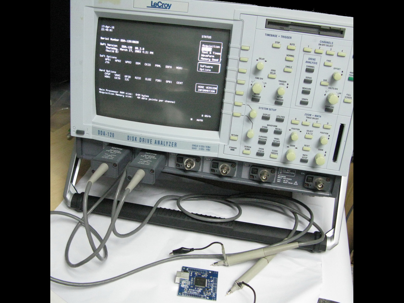

I use Lecroy oscilloscope with JTA option enabled and active probe to compare the input(from clock) and output(from xmos pin) jitter, it is about the same and unbelievable, miles ahead from it's competitor! or there is no competitor as of now😱
what is the competitor you are comparing with ? Also you can't really measure jitter with a cro because it has it's own sampling jitter and limited resolution. ie 1G/s CRO will have 1nS resolution.

I am comparing the jitter between the input and output, not measuring the absolute value. It is the different😀 Measuring the absolute value requires a very precision setup, controlled environment and a monthly calibrate machine...
This is not a general CRO, google Lecroy jitter dda has many information about it.
