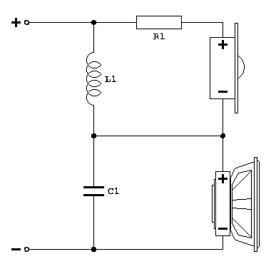

I've been looking for a nice set of computer speakers to build, and this seems very close to what I've been looking for. Could someone post a drawn schematic for the series xo, I had trouble envisioning the written version from the wiki. Yes I'm a newby. All help is greatly appreciated.
There are a few variations of the standard series crossover values you can try for the D27TG-45-06 / P13WH-00-08 combo.
For one with more BSC and a lower top end with an exagerated BBC dip:
R1=10R, L1=0.7mH, C1=3.3uF, -ve tweeter polarity, 7ohm min.
For a flatter one with some BSC and a tad of BBC dip:
R1=6R8, L1=0.7mH, 3.3uF, -ve tweeter polarity, 7 ohm min. This one is closest to the AR series crossover and a good alternative if component costs need to be kept low.
For a flat response without BSC:
R1=4R7, L1=0.47mH, C1=6.8uF, +ve tweeter polarity, 7 ohm min with the smoothest impedance curve of the standard series crossovers.
See the drawing for designations and the tweeter polarity as drawn is +ve, so reverse for -ve polarity.

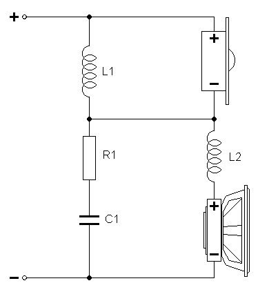

For an AR series crossover which has the flattest response, best driver behaviour, best tweeter protection and BSC:
C1=22uF, L2=1.2mH, R1=6R8, L1=0.11mH, -ve tweeter polarity, 7 ohm min impedance and the smoothest impedance curve.
As above the drawing shows +ve tweeter polarity and reverse for -ve polarity.
As with all series crossovers, use an inductor with the lowest DCR that you can afford.... less than 5% of the woofer's Re.
