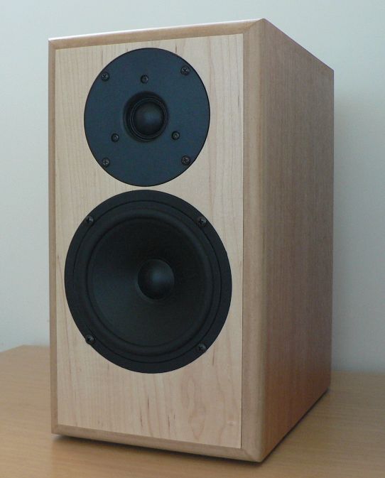

Quick question, madisound has a D27TG45, but it doesn't look like the tweeter inthe esquire pic. It looks like the D27TG35 thats available at PE and Madisound. It doesn't seem like much difference if any between the two expcept for the faceplate. Which is the correct tweet or could I use either?

Blimey, you lot know how to panic a girl! I'd cut up a pile of little bits of MDF, only to read that the drivers I'm basing everything on are gone. Luckily Wagner had stock of the P13s and D26TG35 (but not TG45), so I snapped up a pair of each today.
Suzy
PS: Thanks for putting up such a detailed design.

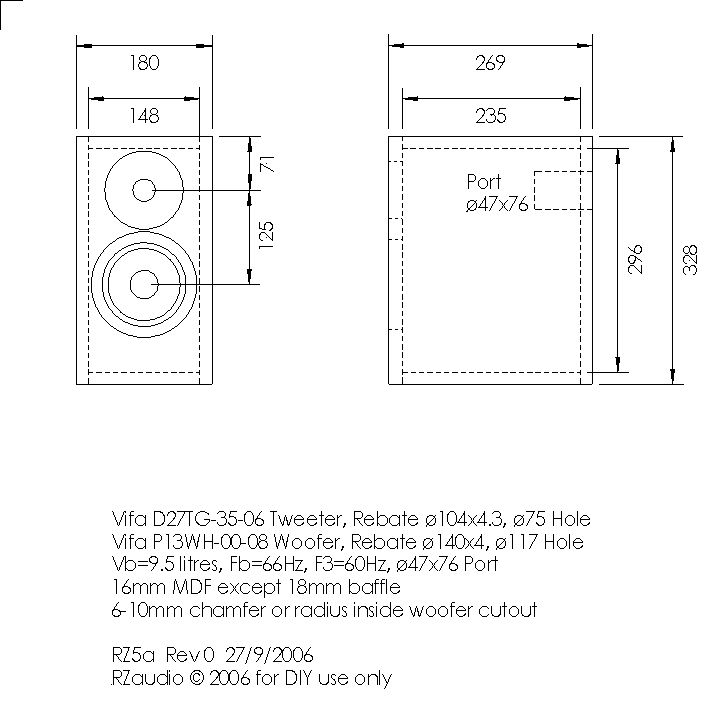

P13 design update
I have only just updated the design so it digs deeper to get some mid bass. The Wiki will be updated in the next week or so.
The crossover used was the 6R8, 0.7mH, 3.3uF (see post #179)as I had a 3.3uF Mundorf Supreme that needed a home. The inductor was a Solen 1.6mm and a 10W non inductive resistor.
I'm very happy with the update as has made the little speaker a bit more useable.

Re: P13 design update
Geez, that'd be right! I'll press on with the original sized box, as it's more suitable for the desk in my study.
Have you thought of useing the P17 mid-bass? If you're doing a bigger enclosure anyway, that strikes me as a pretty good way to get better bass.
Suzy
D1GGY
Send the enquiry via my website (see the WWW button).
suzyj
It's just an exercise in sqeezing a bit more out of the P13 in the spirit of this thread.
The original design was always just a starting point and spring board into the hobby. Something that could be tweaked, builders comparing notes, used as a reference for future projects due to the magic mids of the P13 and drivers used in other configurations such as the TLb.
